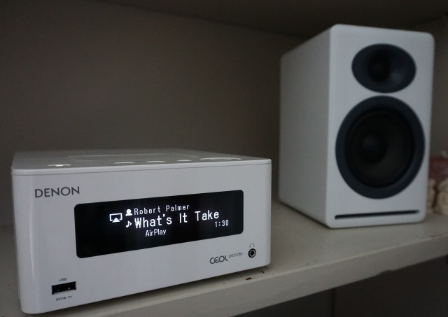

The Extreme doesn't have any audio ports. You'll need an Express and a stereo amplifier, as a bonus it'll also act as a WiFi extender on your TC.
A better option might be a Denon CEOL piccolo. Amazon.ca had them for $199 which was a bargain.
