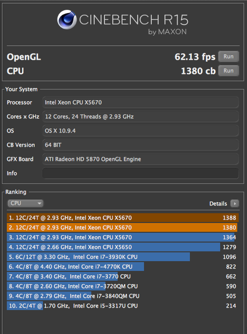

Hello guys,
I want to improve my main MacPro 5.1 (12x2.93 GHz, 24 GB RAM, 10.9.4, ATI Radeon 5870, OWC Mercury Accelsior PCIe SSD) with a stronger graphics-card in terms of a higher Cinebench R15 OpenGL score. My current ATI 5870 scores 62 fps and I didn't find any card with a higher OGL-score for my MP 5.1/ OS X.
I do know the issues about Cinebench. But I have to rely on it since I am working daily with Cinema4D. So that is fixed. ;-)
The EVGA GTX 680 Mac, the Sapphire 7950 and especially all the overpriced Quadros simply do not get a score higher than my aging ATI 5870 - 62 fps.
So I did a lot of research on this. But I don't get any reliable results on which graphics-card (Mac- or flashed/ unflashed PC-cards) get the most high OpenGL-score under Cinebench R15.
I contacted Rob from bare feats, he supplied me with the score of the GTX 680 (weak 53 fps). Via ebay I asked Macvidcards (for 780/ 680) and Create_Pro (for Titan Black) for the Cinebench scores of the cards. But I did not get any useful answer, instead my wallet standing by... ;-)
So, could you please supply any relevant OGL scores, perhaps for a 12x2.93 Mac Pro? Which card scores the best in Cinebench R15 OGL for my Mac Pro 5.1?

Edit: the 7950 gets 68 fps - but to my mind thats not worth the pricey change of the card...

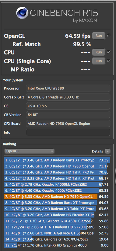

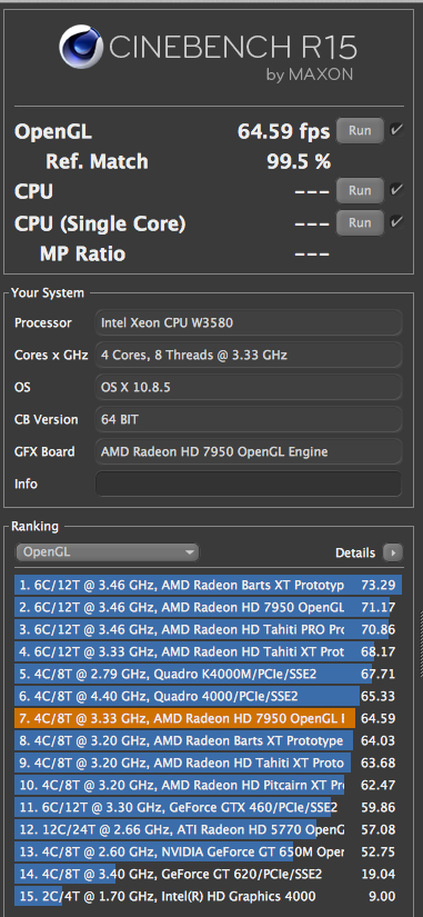

So, according to my testing of various GPU/CPU combos you should choose Radeon 6870 (Barts XT Prototype on attached screenshot) 😀😀😀

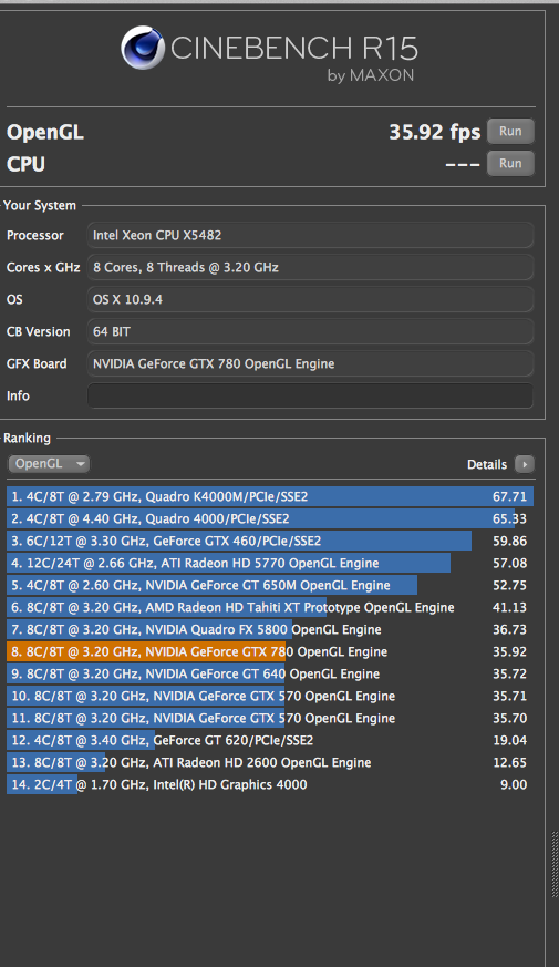

For what it's worth, I get 70.3 FPS with a Core i7-3770 (equivalent to the Late 2012 iMac) and a GTX 680. With Yosemite and a Core i7-4770 plus GTX 780 Ti I get more like 95-100 FPS. The biggest factor definitely seems to be the CPU speed, and the classic Mac Pros just have a really hard time keeping up these days.

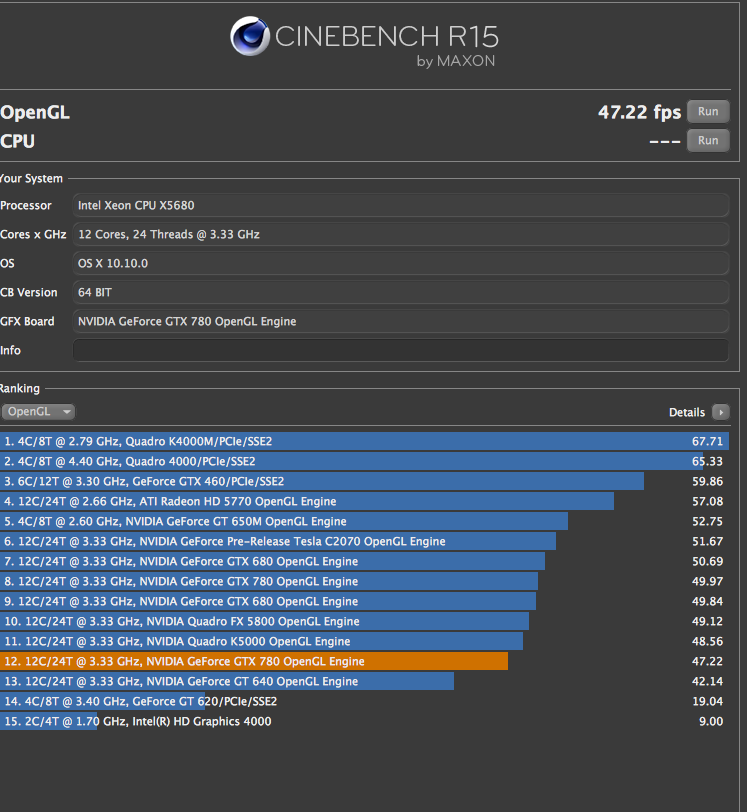

First round goes to...7970
This is on 3,1 running maxed out 3.2 Dual Quads
Note that literally EVERY Nvidia card I tested got same score.
So...why buy a GTX780 when a GT640 will match it frame per frame?
From lowly GT640 to GTX780, all within 1 fps
I'll take a whack on 12 core with a couple later but not expecting miracles.
I stand by my 100% meaningless comment.

Cinebench 15 on 2nd fastest cMP 12 Core 5680
And sadly all of the 680s and 780s get stomped on by......a Tesla 2070...ie, a down clocked GTX480
Trust me, either C4D or Cinebench is poorly written, no other way to see it.

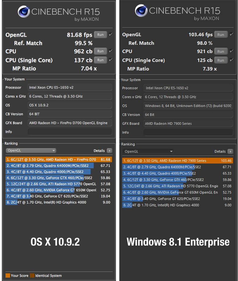

Heres my nMP with D700's. Note how the CPU score under OSX is higher than Windows, but the OpenGL under Windows is better.
I like the OGL-Scores of the nMP.
But on the CPU-side I love my nearly 1400 points.
To reach them with the nMP a few thousand bucks are on the loose (and still its only 12core... ;-/ )

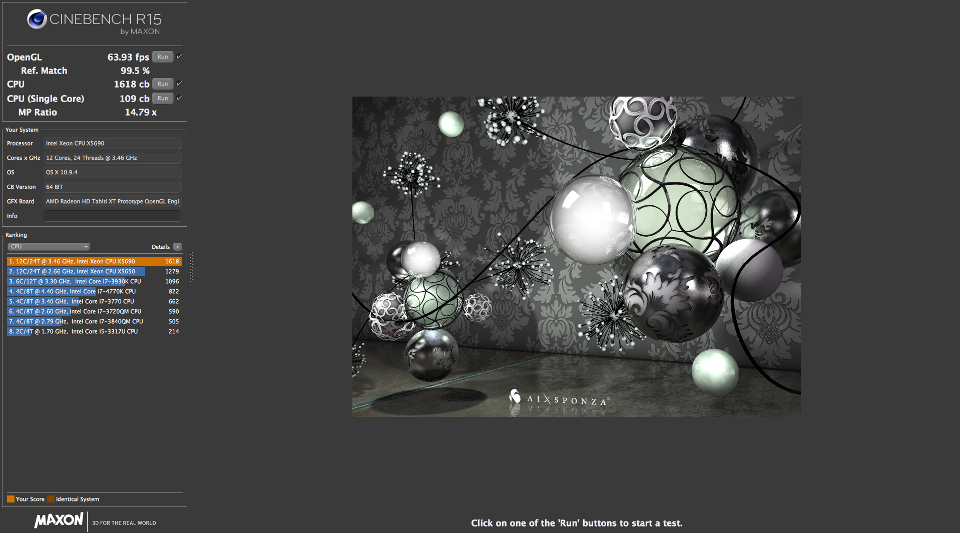

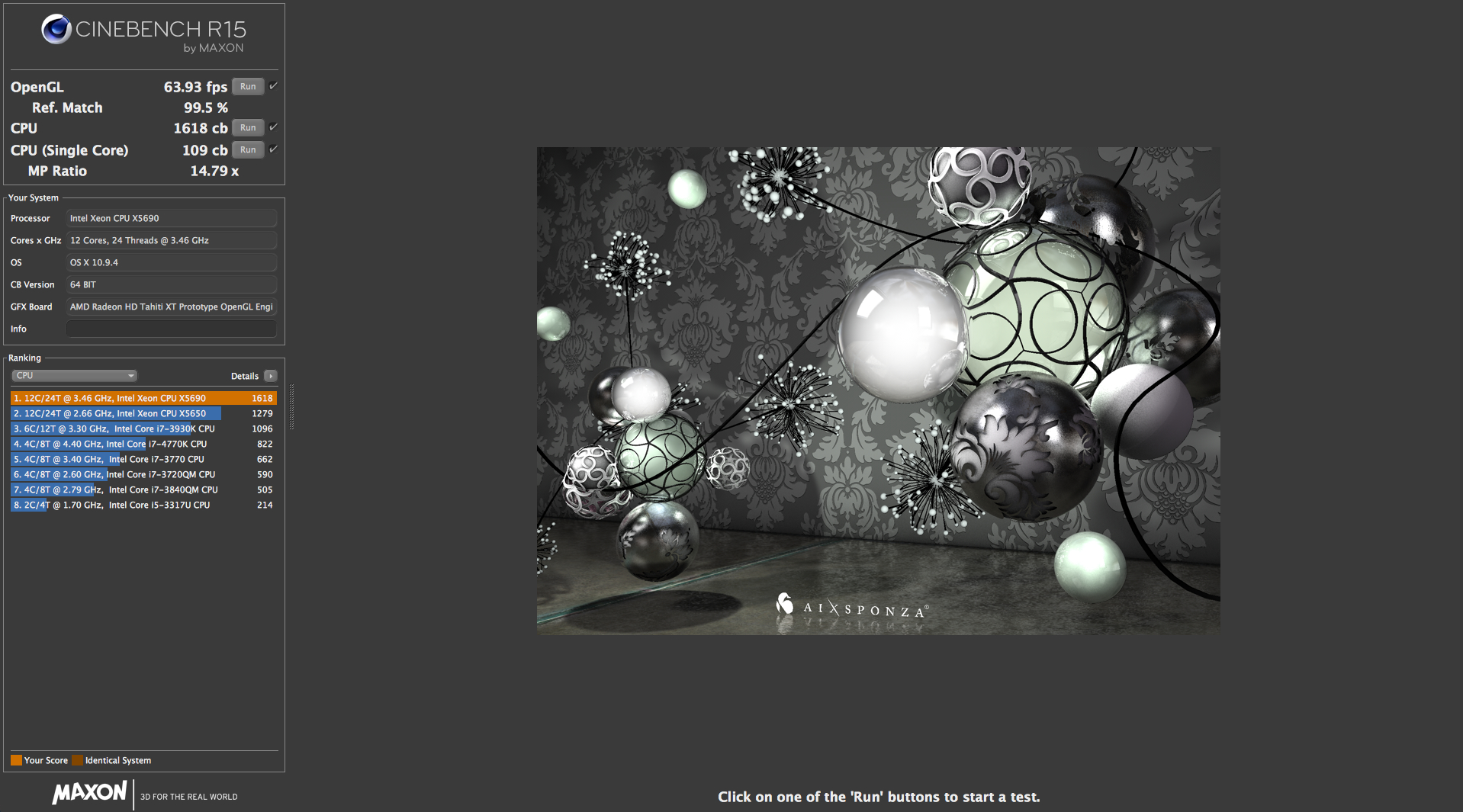

Your cinebench score is not a bad score at all, I get only 63.93 fps and this is with a 280X. SO even if you upgrade to the latest card or max out the CPU, it would not change the score dramatically. I use Maxon Virtualize from time to time and I hate it on MAC, it runs better on Windows with the same hardware. As others pointed out, Cinebench is a joke...., I am not even sure whether it shows the OpenGL performance of your hardware correctly lol
attachment.php
