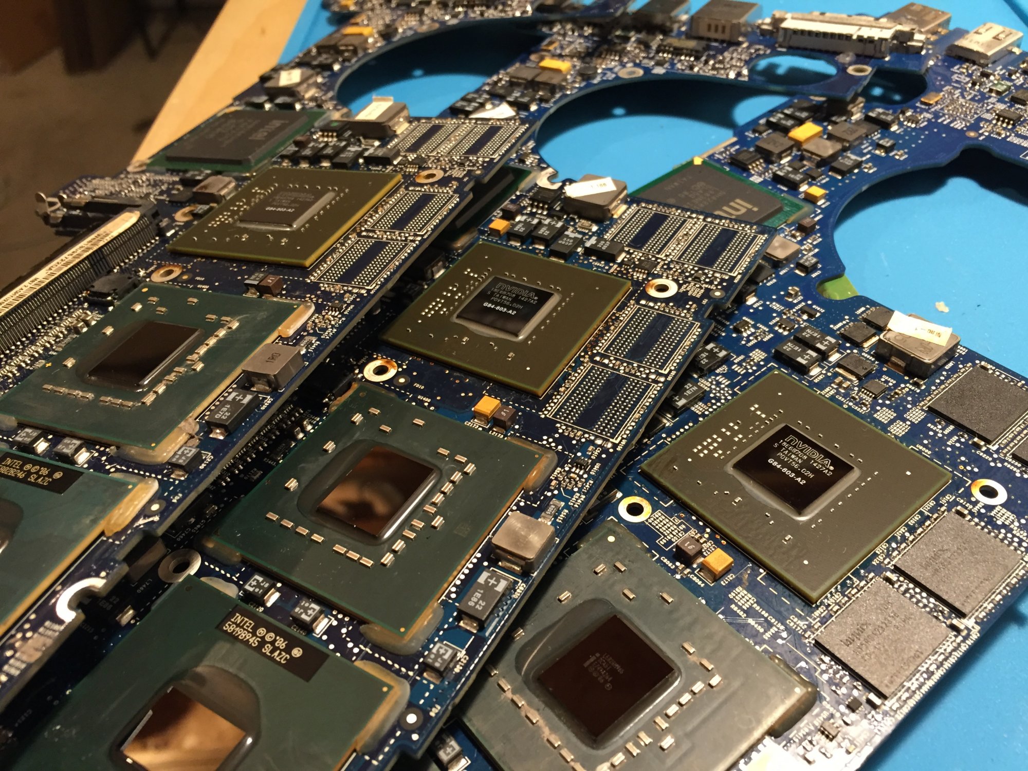

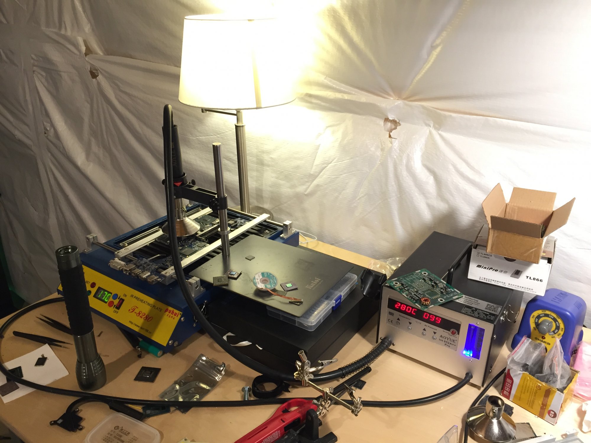

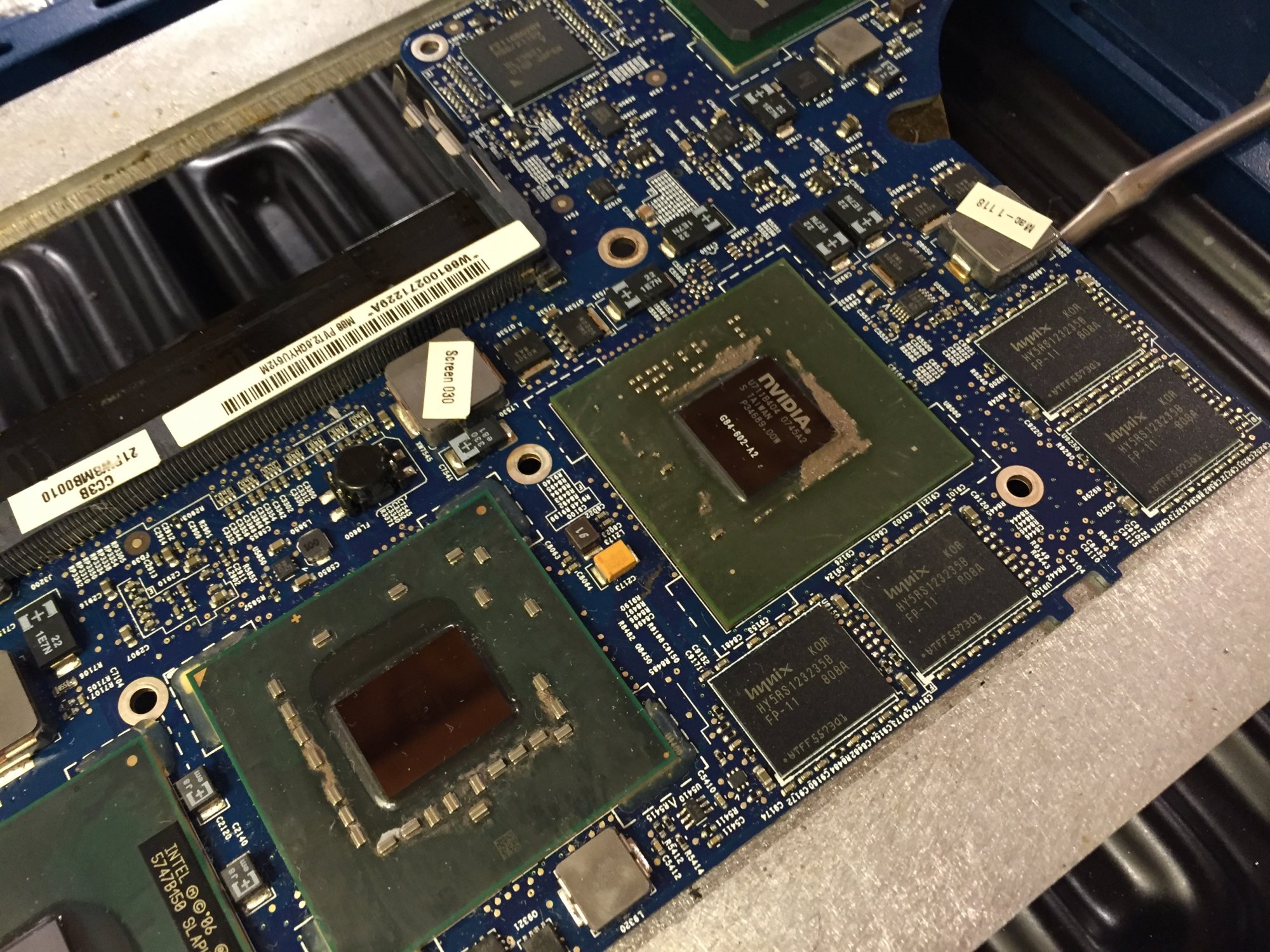

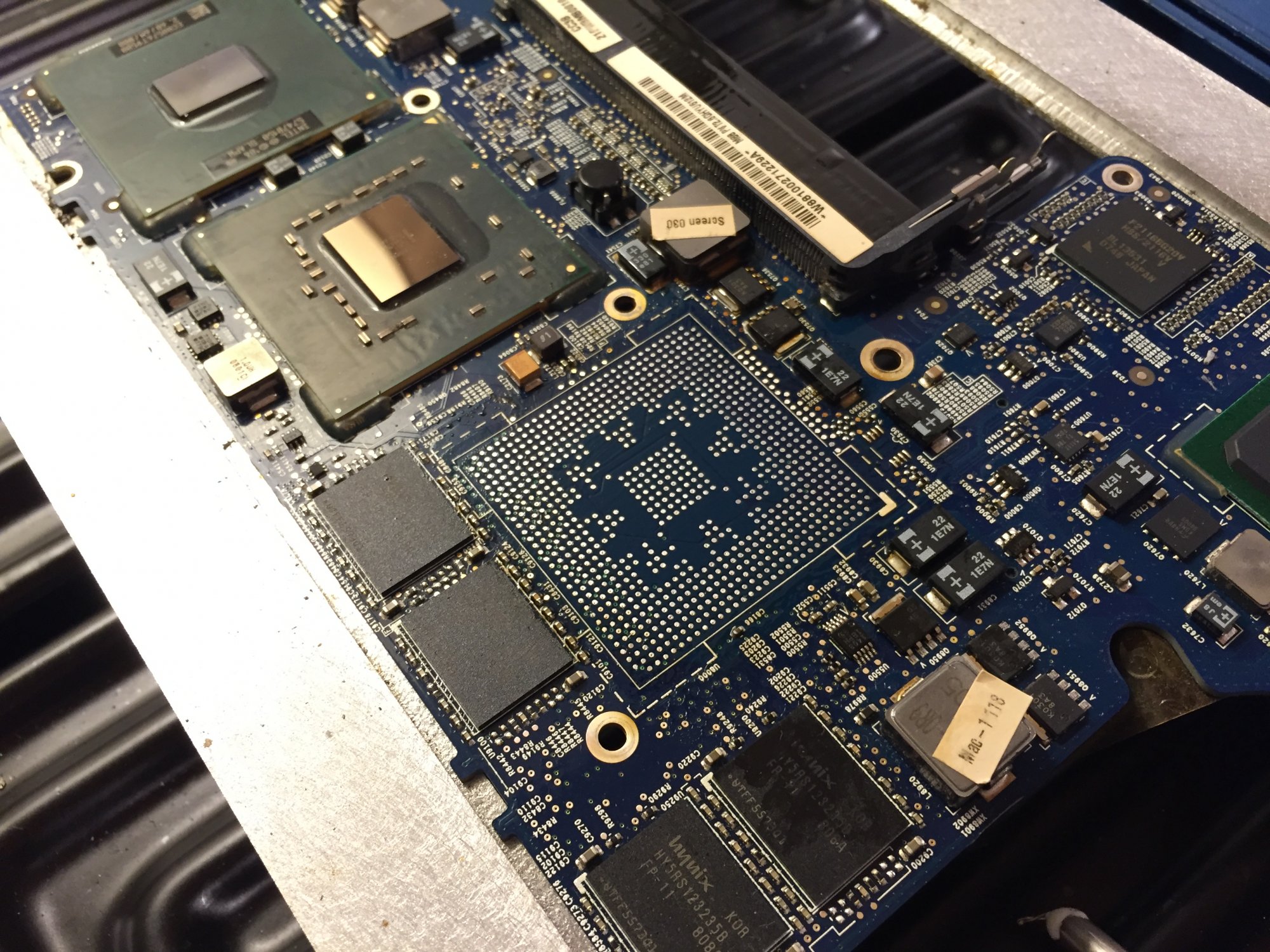

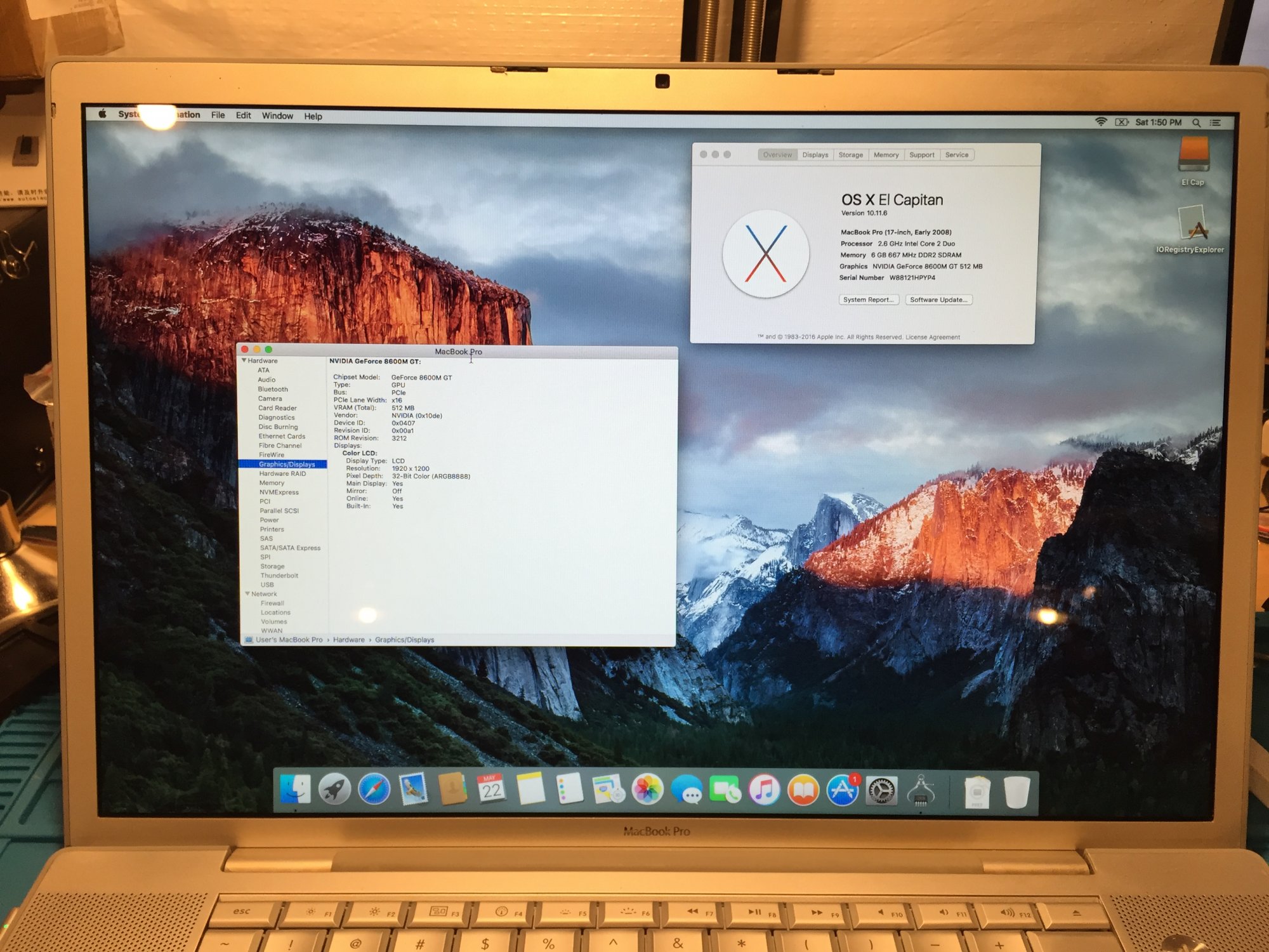

I actually just finished doing three of these today for people who sent them in to me for revised GPU chipset installation. These machines are rock solid reliable once the revised G84-603-A2 chipset is installed. If you want to perform the upgrade yourself, this is the listing I use to purchase my 100% brand new revised chipsets. Please be aware that this upgrade requires a bit of skill and decent BGA soldering equipment. I also have a video showing the process.
Does this work on 17“ Models too? Assuming its the same chip. I didn‘t realize those chips are still available. A couple of years ago word had it those chips are increasingly difficult to come by. @dosdude1 i neither have skill nor equipment to do this myself. Are you open for doing this? What‘s your fee?
Yes, the 15" and 17" use the same chip. I normally do this repair for $150, plus the cost of return shipping.
