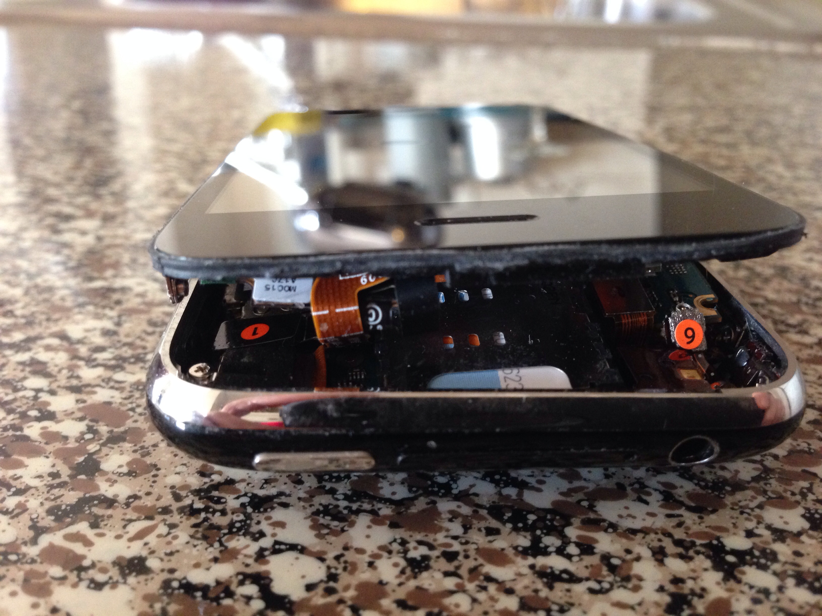

My mom had her 3gs charging yesterday, and when she went to disconnect it from the charger, the back piece pretty much exploded, snapping the back cover I had on it. I understand its an older model, but I would think that this isnt normal lol. She charges/charged it normally, with wires and wall chargers all from Apple, meaning no aftermarket stuff. What should I do? I have an contact with Apple, which I email from time to time when I have some problems, so I thought I should go through her first, before calling Apple. Or should I not even contact them? Thoughts?

It's nothing dangerous, it's an expanded/EOL battery. They have an unfortunate habit of doing that (old MacBooks anyone?). They do it as a safety feature.
They will probably (or I hope they do) offer you a replacement at the OOW battery replacement cost, since it's the battery which has failed - which will be about $79 I think.

Yes they do swell somewhat, and it is normal, but for a phone, different situation. You hold the device to your face. I wouldn't want to hold a bomb to my face. It's a major safety issue, and also this bulging battery destroyed the phone. Phones shouldn't self destruct.

It's not a bomb, or a safety issue. The battery "expands". It doesn't explode. It's not a "pop". The phone cracks due to slow pressure build up. If it was an explosion - there would be shards everywhere.
So - what would you rather happen? A phone that destroys itself, or a battery which doesn't have this safety feature, and likely catches fire or whatnot due to a chemical problem?

Explosion or not, not every single battery expands at the end of it's life. I really don't care, but if my phone self destructs, then I have an issue with that.
Also Apple states to replace the swollen battery due to potential safety issues, and replace any components damaged by a swelling battery, but that is common sense. Apple would have brushed the OP off it it was entirely normal. Simply put, it isn't. I've seen plenty of batteries, in fact I see more batteries go out peacefully rather then swelling.

when a li-ion or li-poly battery is over charged or over discharged, they "puff", 2-5 times their normal size.
Knowing that there is no room in a smartphone for a puffed pack, something had to give. (calling it an "explosion" is completely wrong though).
