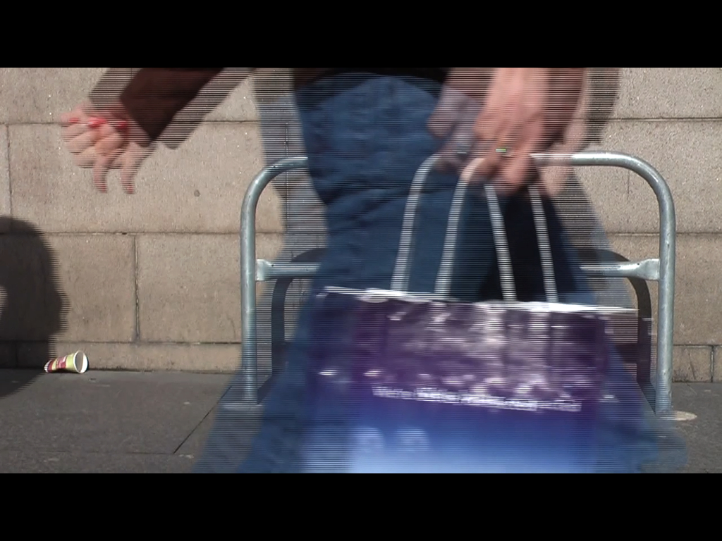

Attached are two frame grabs from a 10-second shot recorded in 1080i on a little Panasonic SD5 AVCHD camera - replete (an understatement!) with motion blur artefacts.

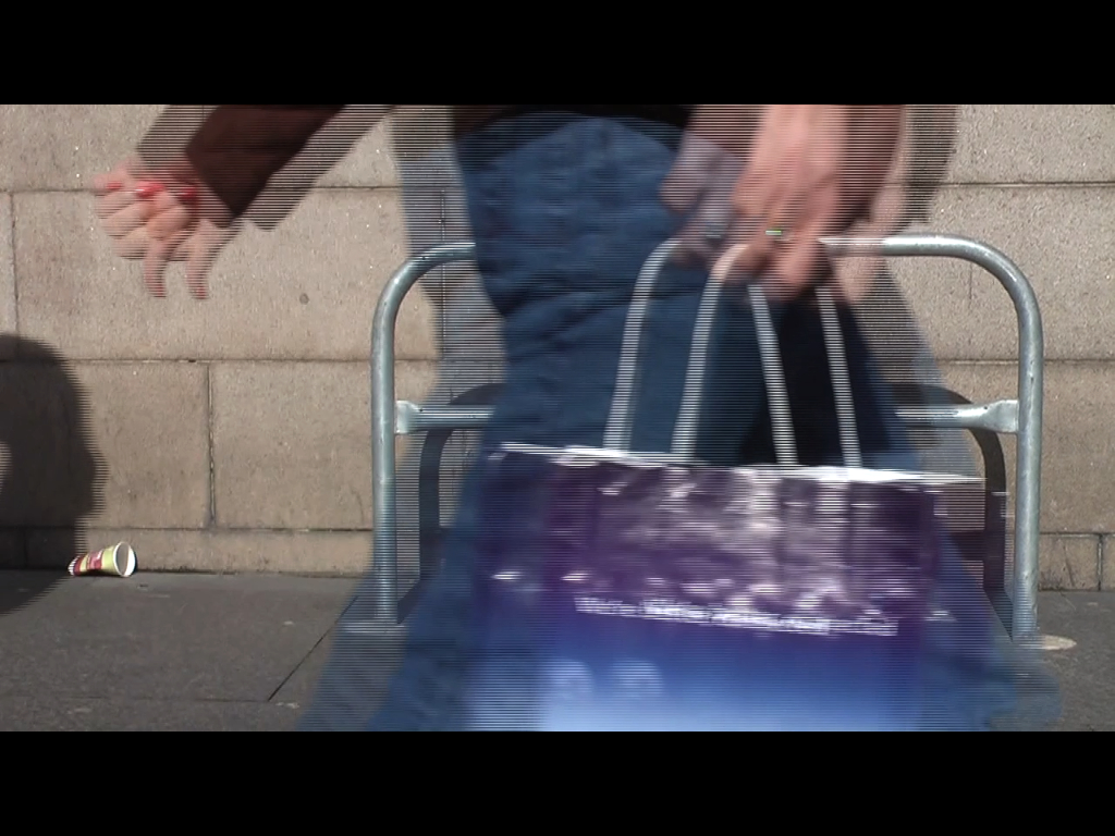

The second jpeg was grabbed after deinterlacing this single shot with iMovie HD. It tidies up the weirdness a little, but the shot is clearly still unacceptable.
Is this an AVCHD issue (I know it's not an ideal shot in many ways, but I wouldn't have expected this much in the way of "blur") or operator error? TBH I can't now remember what shutter speed I was using, but it was a reasonably sunny day, and I think it would have been 1/100 or 1/125 at least.
Your thoughts welcome.
Thanks,
Andrew.
EDIT: I should add that the original .mts file was converted with Voltaic, preserving framerate and size, on an iBook G4. Naturally, it played back fine in the camera's LCD. It's not a one-off: I have a number of shots that resemble this, shot in a wide variety of circumstances, all converted with Voltaic and all unusable. The jpegs below are screen grabs from an LCD which I presume is progressive. But the deinterlaced shot is still rubbish.

this is to do with interlaced video getting converted, I have experienced this with fast moving action that look fine in standard pal, then getting downsized to a 400x300 mpeg.
It seem to happen is going from a interlaced clip to a progressive clip, ie losing the 2 fields going to a single frame.
Both grabs show the results of different de interlacing , I expect the problem is with Voltaic.

Thanks for that.
I'm going to be buying a Mac Mini as soon as (or is that "if"?) Apple announces an upgrade. iMovie HD on my G4 iBook won't touch AVCHD, hence my using Voltaic to convert to .mov.
I'm going to try importing the .mts file into iMovie at an Apple retailer to see if it makes any difference. iMovie 08 will convert AVCHD to AIC, but if it does that without this disastrous "effect" then I have to say, I wonder what Voltaic is good for. I didn't realise it was converting from interlaced to progressive. I did mean to deinterlace the second time though (outputting from iMovie HD as a deinterlaced QT movie, which is where the second grab is taken from).
Voltaic certainly seems to have some issues - at least in my experience - with deciding where one frame ends and another begins, or with matching the interlacing to the new progressive frame, or something. The result is useless video. Needless to say I won't be "activating" the free Voltaic trial.
Andrew.
How did the video look straight into your TV? I shot with a couple Sony AVCHD cameras at 1080i and they looked very clean. No blurring. Didn't import them though... maybe I'm not helping.
Problem sorted (I think).
This morning I tried importing the same clip into iMovie 08, and then exporting as a Quicktime movie. Still a little blurring going on in the iMovie preview window (can live with that) but completely tidied up after import.
Ah. That's more like it.
Moral of the story: give Voltaic a miss if you have an aging iBook G4 with minimal space left on the harddrive. I'm not sure which of these factors (processor, harddrive) is the critical one here, but something made it all add up to a garbled mess.
