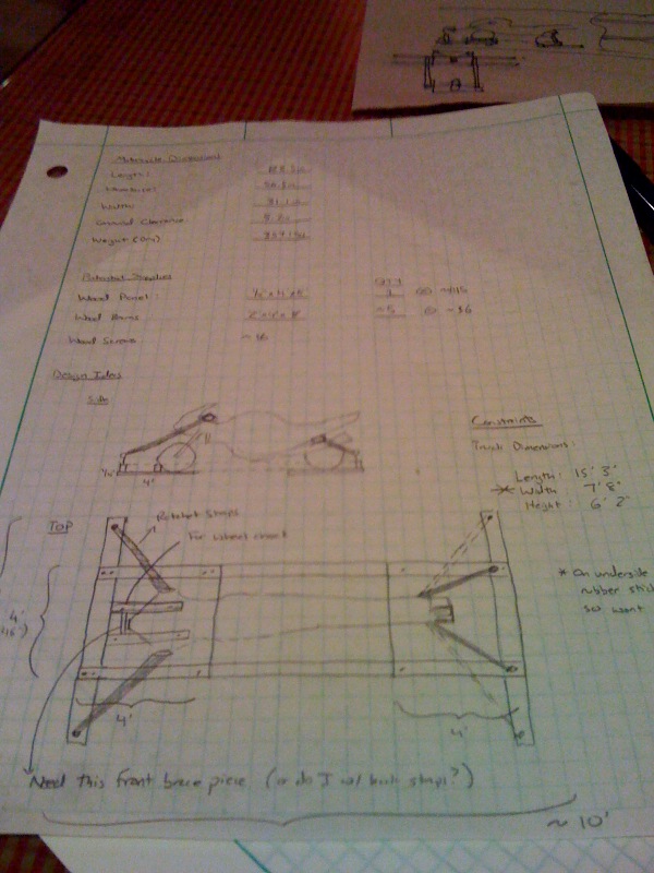

You probably find better support in a motorcycle forum, but here is how I would do it.
0. Clean the bike and drain tank and coolant, if possible oil as well.
1. Cut some wood planks (I guess that's what you Americans call 2 by 4s) so that the wheels are supported on both sides. Two planks left and right of the bike, and two on each side to fix it against the side of the truck.
2. Bring in the bike (two people should be fine with the ramp in the pic).
3. Use a tension belt across the seat for fixing. Pull it real tight so that the suspension is fully engaged (no side or main stand).
4. Use two belts to fix the handle bars to each side of the truck. This is to secure the steering.
5. Use two more belts to fix the back of the bike, using the pillion handles or similar. These belts hold back the bike in case of a crash or emergency braking.
This will block a lot of space in your truck, and you need to protect your bike from things falling on it when you are on the road. Maybe you can use mattresses or stuff like that.

Here is a sketch of what I was thinking, sorry for the angle but it carries the jist of the concept
The only concern is lateral stability as far as I am aware. This should be relatively easy to make, using a plywood board cut in half and them about five 2 by 4's 8 feet in length
Thoughts?

...Why should I drain it though? That would be a decent hassel. What's the best way to drain gas tank?...
Incase the bike were to fall, there would be no way for anything to leak, causing the moving company to find out. As for draining it, just find the gas line going into the carb from the tank, shouldn't be hard. Pour it into a gas can.

I would just drive it up. My 27 foot Penske was not that large of an angle, I would have ridden a motorcycle up. If not, walk it.
I think if put it in the corner and then tied each end off on either wall it would be fine. Like tie it to one corner and angle it towards the other corner, but then tie it off on each side so it doesn't move left or right.
