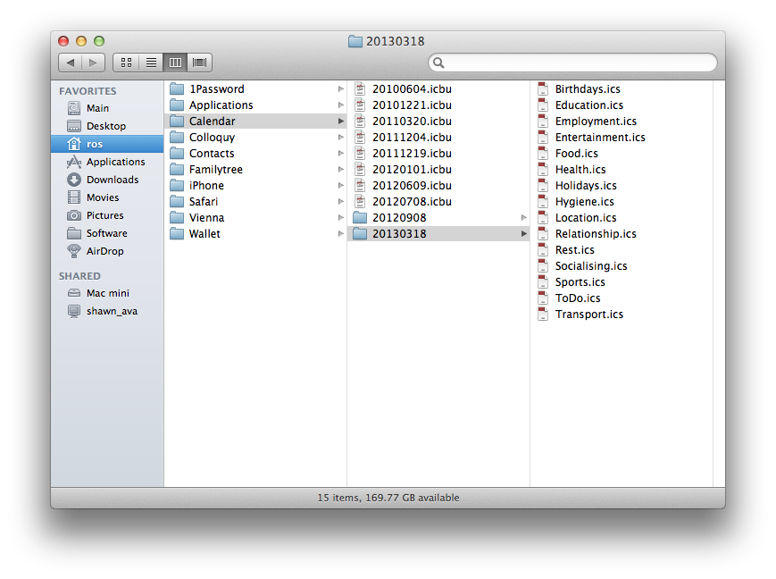

The end result should be as in the attached screenshot. Any help is greatly appreciated - after 2 days of searching through Google and other forums.. I'm out of skills and ideas!

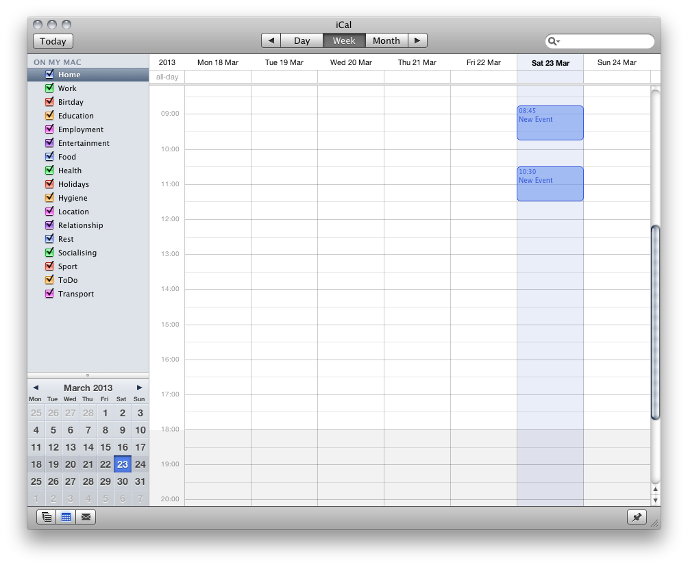

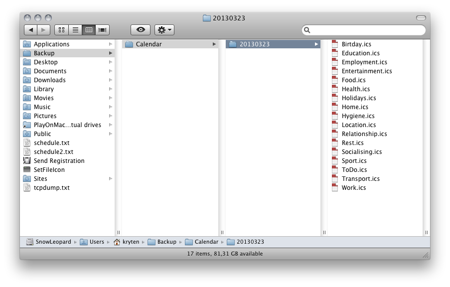

Note : Make sure Enable access for assistive devices is checked in Universal Access of System Preferences. Tested on Snow Leopard with iCal 4.0.4. YMMV.

drwxr-xr-x    4 ros  staff   136 Mar 18 22:38 04950D7E-2BFA-4239-A349-24A573513B9E.calendar		(Education)
drwxr-xr-x    4 ros  staff   136 Mar 18 22:38 3CAF1ED2-BE78-4A46-BC4D-E6C2BDD05B49.calendar		(Health)
drwxr-xr-x    4 ros  staff   136 Mar 18 22:38 3F438A8D-EDDB-4FC0-861D-E5B2550A6D55.calendar		(Rest)
drwxr-xr-x    4 ros  staff   136 Mar 18 22:38 4605849B-95A7-47B0-AEF3-39D6D04B7071.calendar		(Food)
drwxr-xr-x    4 ros  staff   136 Mar 18 22:38 7CE2B1AD-C7E1-4DC8-86B6-62382364F678.calendar		(Location)
drwxr-xr-x    4 ros  staff   136 Mar 18 22:38 86C2E0A3-46E2-4576-8D40-0027E409F593.calendar		(Holidays)
drwxr-xr-x    4 ros  staff   136 Mar 18 22:38 94764D88-4D2E-4EF8-AE2D-042D805D847D.calendar		(Socialising)
drwxr-xr-x    4 ros  staff   136 Mar 18 22:38 9C483337-B54C-4656-9AD4-D209418EDA33.calendar		(Employment)
drwxr-xr-x    4 ros  staff   136 Mar 18 22:38 BEE64618-8AD9-4213-994C-A2EDA573082D.calendar		(Entertainment)
drwxr-xr-x    4 ros  staff   136 Mar 18 22:38 CCF565CD-053B-479F-BE8D-EAC00681EA05.calendar		(Transport)
drwxr-xr-x    4 ros  staff   136 Mar 18 22:38 D8B8EEC6-7963-4B9C-B759-97EA3EBD313C.calendar		(ToDo)
drwxr-xr-x    4 ros  staff   136 Mar 18 22:38 DE09DCB3-11E5-481B-9825-8CC00EEDAD2B.calendar		(Hygiene)
drwxr-xr-x    4 ros  staff   136 Mar 18 22:38 E4FD5C67-3BE5-4C0A-841F-E7AD244386B0.calendar		(Sports)
drwxr-xr-x    4 ros  staff   136 Mar 18 22:38 FE588D5A-A7A0-49B6-AA7A-1926468641ED.calendar		(Relationship)
drwxr-xr-x  121 ros  staff  4114 Mar 23 18:43 Attachments						(Empty folder)
drwxr-xr-x    2 ros  staff    68 Feb 13 10:37 Inbox							(Empty folder)
-rw-r--r--@   1 ros  staff  1953 Mar 24 12:10 Info.plist						(CalDav setup details)
drwxr-xr-x    4 ros  staff   136 Oct  8 17:09 LocalDefaultAlarms					(Alarm related details)
drwxr-xr-x    2 ros  staff    68 Oct  6 17:14 NotificationCollection					(Empty folder)
drwxr-xr-x    4 ros  staff   136 Oct  6 17:02 ServerDefaultAlarms					(Alarm related details)

Sorry it's been a while. Can you try this :
Code:
-- Selecting calendars in iCal and export using GUI scripting
-- Change the backup_folder path!
-- Don't click anywhere else when the srcipt is running!
set timeStamp to do shell script "date \"+%Y%m%d\""
set backup_folder to "/Users/kryten/Backup/Calendar/"
do shell script "mkdir -p " & quoted form of backup_folder & quoted form of timeStamp
set savePath to backup_folder & timeStamp
-- Begin script
tell application "Calendar"
	launch
	activate
	delay 1
	set calNames to name of every calendar
end tell
tell application "System Events"
	tell process "Calendar"
		-- Left-hand menu of iCal, containing named calendars
		set myOutline to outline 1 of scroll area 1 of splitter group 1 of splitter group 1 of splitter group 1 of window "Calendar"
		set allRows to rows of myOutline
		-- List of named calendars
		set calNameVals to value of text field of every row in myOutline
		-- For all named calendars, check whether it's the same name as one of calNames
		-- If so, export that calendar.
		set countLoop to 0
		repeat with i from 2 to (count calNameVals)
			set countLoop to countLoop + 1
			set calName to item 1 of item i of calNameVals
			repeat with myName in calNames
				if (myName as string = calName as string) then
					tell row i of myOutline
						select
						delay 1
					end tell
					click menu item "Export…" of menu 1 of menu item "Export" of menu 1 of menu bar item "File" of menu bar 1
					delay 2
					if countLoop = 1 then
						keystroke "g" using {command down, shift down}
						delay 1
						keystroke savePath
						delay 1
						click button "Go" of sheet 1 of sheet 1 of window 1
					end if
					click button "Export" of sheet 1 of window 1
				end if
			end repeat
		end repeat
	end tell
end tell
Like a clock-work! Thank you very much!
I'm pretty sure this will be helpful to a lot of other people as well - pity that such a basic function isn't implemented in Mountain Lion!
