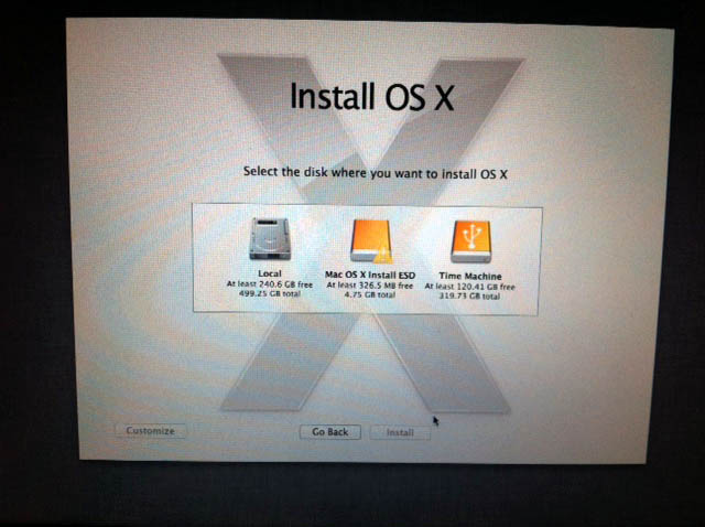

    So I was running OSX 10.7.4 on my mid-2009 13"MBP.
    This morning I decided to upgrade to Mountain Lion.
    I bought it and proceeded to download it via the app store. I backed up my drive using time machine right at that moment, as it occurred to me that it might be a good idea.
    I was not able to complete the download without closing my machine, taking it elsewhere and opening it back up again (resuming the download).

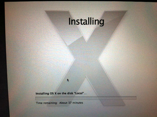

    Once the download was complete, I began the installation process (physically at thew new location now).

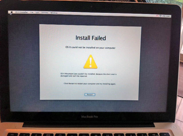

    Some time later I'm faced with the error message:
    "OS X Mountain Lion Couldn't Be Installed, Because The Disk Local Is Damaged And Can't Be Repaired"
    [​IMG]

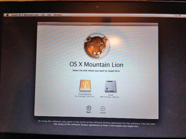

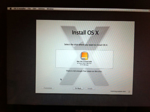

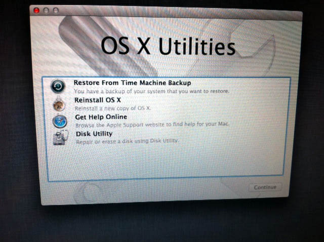

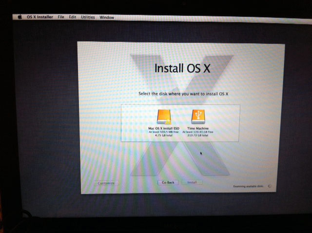

    I tried everything I could think of. When I attempt to install it finds my time machine drive (USB), the Mac OSX Install ESD and eventually- after about a ten minute wait- it finds my "Local" drive.
    When I try to install 10.8 the installation fails with the error I mentioned earlier.
    When I try to restore from Time Machine via the Mountain Lion install interface it never finds my local HDD.

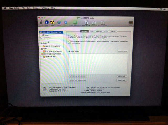

    Disk utility won't let me select the drive "Local". It's greyed out. (see screenshots)
    I should mention: my current HDD is about 9 months old. It's not an SSD and has always functioned without issue.
    I got it because I really wanted a 7200rpm drive rather than the standard 5400.
    I've never had any reason to suspect bad sectors or any sort of damage.
    I haven't subjected my Macbook Pro to any impact. This all just occurred with the ML install.
    Am I screwed? I'm a programmer/designer/marketer, so I REALLY need my machine.
    Advice? (more photos below, screenshot function wasn't installed in the ML boot interface).
    I'm going to the Genius Bar tomorrow and a new 2.5" SATA drive is always a hundred (or so) bucks away, but I welcome any other ideas with open arms.

    The fact that the Local volume is greyed out in Disk Utility just means it isn't mounted or unlocked. You should be able to select the actual physical disk and use Disk Utility to erase it back to a clean HFS journaled volume with a name of your choice.
    You'll need to do this from a bootable disk, or you could use the remote restoration process, as erasing the whole disk would mean erasing the recovery partition from which the installer operates, which isn't possible.

    I'm facing the exact same issue right now.
    iMac 27" from 2009 I think, Core Duo 2.
    Installed iLife and iWork update before that.
    After ML download, installation, it complaints about the Harddrive to be irreparabel corrupt.
    I do see the exact same screens.
    Can not recover the machine from backup either.

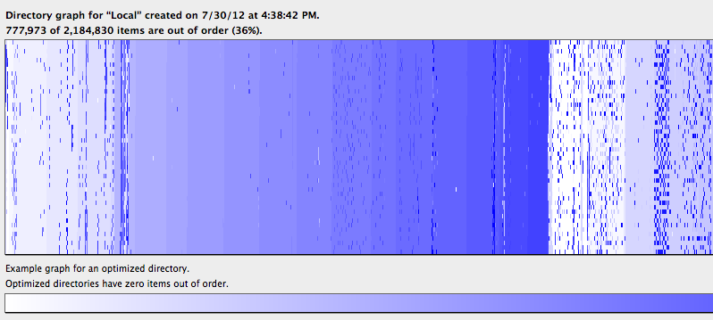

    I had this problem and just got my MacBook Pro running again. In short, the ML installer did major damage to the directory of the drive the OS is installed on, making it unusable. Apple's Disk Utility could not repair the drive's directory. Applecare told me that I had to format the drive and install the old OS. This would work, but was not necessary in my case.
    DiskWarrior by Alsoft was able to repair my severely damaged hard drive directory.
    Once DiskWarrior repaired and replaced the drive's directory, I rebooted, and the ML installer started again. After running for a few minutes, it threw an error telling me that it couldn't install because it couldn't make a recovery partition on my drive (I will not address this error in this thread, it's a different problem.). The installer allowed me to restart and revert to my previous operating system, which I am using right now to type and post this the comment.
    My system seems to be running as it was before I attempted the ML install. It appears that I lost no data, applications, or application settings. I'm not going to bother with ML at this time, since my system is working correctly again, and I don't really need any of the newest features right now. (I know better than to be an early adopter, grrr.)
    In my case, the ML installer DID NOT damage the existing operating system, damage any of my data, nor did it do irreparable damage to the drive. I DID NOT NEED TO FORMAT the drive, I just needed to repair the drive's directory with a utility that could actually fix it.

    Disk utility won't let me unmount the partition. When I try to erase or repartition the disk the first task disk utility must complete is unmounting the current partition, which does work.
    Even tried sudo force unmounting it via unix with no luck which really took me aback.
    I think you're right, I can access the disk, but not the partition. The ML install somehow damaged it.

    Here is how I got away with it:
    Use the DiscUtility Repair on the Volume "Macintosh HD", though it is grayed out and installer claimed it to be impossible.
    Situation was that: on install, right after 30 seconds or so, installer complaint about the disc being damaged and could not be repaired.
    Like the first screen photo of this thread "Install Failed".
    Using the OSX stock Disc Utility, the drive ("1 TB .... Media") was available but the volume "Macintosh HD" was grayed out.
    Using repair on the drive itself did not do anything, it was reporting everything is fine on the partition.
    Finally, on a last check before putting the thing into it's box for transport, I gave it a click to the gray "Macintosh HD" and to my surprise found the "Volume Check" button still available. Doing that, the repair check sequence kicked in and reported:
    - 2 additional leafs found that were not in the catalog
    - 1 additional folder found that was not on file
    Guess where they were coming from...
    Final message: Volume has to be repaired. Repair button showed enabled.

    1. I graphed the drive (which happened to be a mess, see image)
    2. I rebuilt the drive ('directory' tab)
    3. I replaced the drive with the rebuilt version (took a while)
    4. I ran a check on all files and repaired permissions via Disk Warrior (files tab)
    5. I ejected the target disk.

    Running the Mountain Lion installer didn't work right away though. I noticed that it only worked if I didn't let the MBP display go to sleep during installation (i.e.- I periodically moved the cursor).
    After an hour of installing it was ready! Thanks to Plutarch and everyone who advised.
