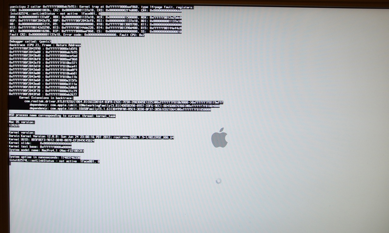

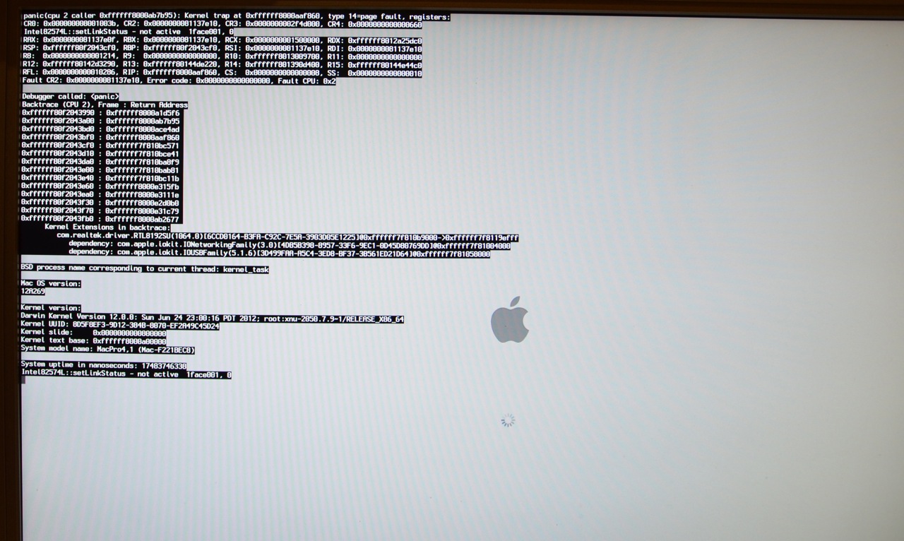

Thanks for the tips - i've managed to load ML in safety mode but when I try to complete your other steps, i keep getting the same error as before.
I've attached an image of the error before it crashes... It looks like there might be a problem with a realtek driver?? This is my usb internet key.
Can anyone who understands this stuff please explain if this looks like the issue and if so, should I reboot in safe mode and remove the drivers?
Any help would be much appreciated!

I rebooted in safety mode (hold shift) and found the relevant driver causing the error and deleted it.. To my surprise, it worked.
Hopefully realtek will update theirs drivers soon.

What is the relevant driver causing the error.
What sticks out to me is "System Model Name: MacPro4,1 (Mac-F221BEC8).
That's not a rMBP, thats the Mid 2010 MacPro... 😕

How to Reset PRAM
During restart, hold Ctrl + Command + P + R to reset the PRAM is incorrect.
You Must hold down Option + Command + P +R to reset the PRAM. Oh, and I just installed Mountain Lion and the problem I'm having is that my system starts up I can use it for about 10 seconds, then gives me a message that to run Java I must update it and then within 30-60 seconds totally freezes up and forces a restart. It will just keep in this cycle unless I start into Safe Mode, which it is now working, but I have no idea what could be causing this problem.
reset the PRAM the correct way.... still not working

reset by hitting OPTION COMMAND P R at the same time then turn on the machine. it should blink and then start again. this means it worked.
A lot of people entered recovery mode then got into disk utility to repair disk permissions and repair the disk. do it a few times.
if you can get into SAFE MODE and apple requests to send an error report. look at it. see what's in it. if anything is not com.apple see what comes after the com. and try andfind those files.
delete them and restart. worked for me.
i try to delete that same com.trendmicro.kext.KERedirct that you have you in your report in terminal, but everytime i try it says it "can't create it" when i put sudo kextunload. What am i doing wrong?
