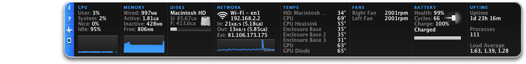

It's running hotter for me too. Perhaps it might be addressed in a future patch.
See attached.
