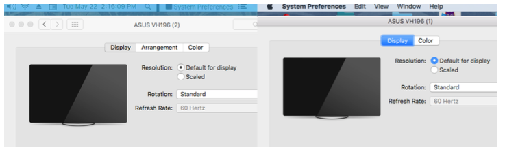

I truly have never come across this in all the years I have been with Apple.
I finally decided to go from Mountain Lion to El Capitan, and yes I did do a backup.
The pictures I am showing illustrate that I have two monitors.
If you look closely at these two pictures, each monitor is at the very top of the picture.
Though you can’t see it, each monitor has its own black apple in the left top corner.
Each monitor has it’s own System Preference.
They are like Conjoined Twins and can both restart and shutdown.

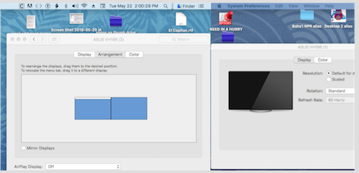

On the picture that has the blue arrangement, nothing is stopping me from putting the blue arrangement on the opposite side.
Both have their own docks, but they never appear at the same time.
I can shut down on either side .
Only one monitor has the El Capitan HD, but I can move it from one monitor to the other monitor along with it’s partitions.
To do this upgrade, I downloaded El Capitan, but I also have an unused OS X El Capitan in the Applications.
As I said before, I have NEVER had this happen to me: it’s like eating with a fork in both hands.
I know I could use the backup of Mountain Lion and delete this mess, and try again. But how do I know it won’t have the same problem?
How do I fix this mess???

You haven't shown us the "Arrangement" tab in the Display preferences. If you have the "Mirror Displays" option checked, I think this is what you get.

The top picture is the one with the BLUE color, check the left side, there is a mirror showing NO check. I wish you were right. Noting would make me happier.

Move your displays, in the Arrangement tab, so that the displays are NOT side-by-side.
For example, move the display on the right part way down, so only half of the screen is adjacent. (This is a test, to see what happens to the top menu on that screen.)
It would also be nice to see screen shots of the full screen image on each display, and not just the top right and top left corners, respectively. (Unless those ARE full screen shots already) In THAT case, I would suspect that you have some strange setup in your System Preferences/Mission Control pref pane. It may just be an odd left-over from the Mountain Lion system, such as some screen setup setting that is being mis-read by the new system install.
Try this: Mission Control pref pane, un-check "Displays have separate spaces". You will need to restart your Mac after you make that change. That may reset the strange screens that you are seeing now.

Nothing is messed up. El Capitan changed how multiple displays work. Each display has a menu bar to make it easier to use, and the dock appears on either display when you move the cursor over it which again means it’s closer when you need it. When you use the Display preference pane, it opens a window on each display so you can adjust settings pertinent to that display. The desktop is a combination of the entire display space, which is why you only see one of each icon. It’s all normal. See https://www.tekrevue.com/tip/move-dock-another-monitor-mac-os-x/

SO, chabig, what you are tell me is all is as it should be, right!
Good thing you can't see my HAPPY DANCE.
SURE DIDN'T KNOW HOW I WAS GOING TO START ALL OVER.
I WILL STUDY THE LINK YOU SENT, THANK YOU VERY MUCH!

Yep. Everything is as it should be.
I was reading your description trying to see where you got into describing a problem. But you never got to the problem part.
So yeah, it is the way it should be. The other poster is correct.
