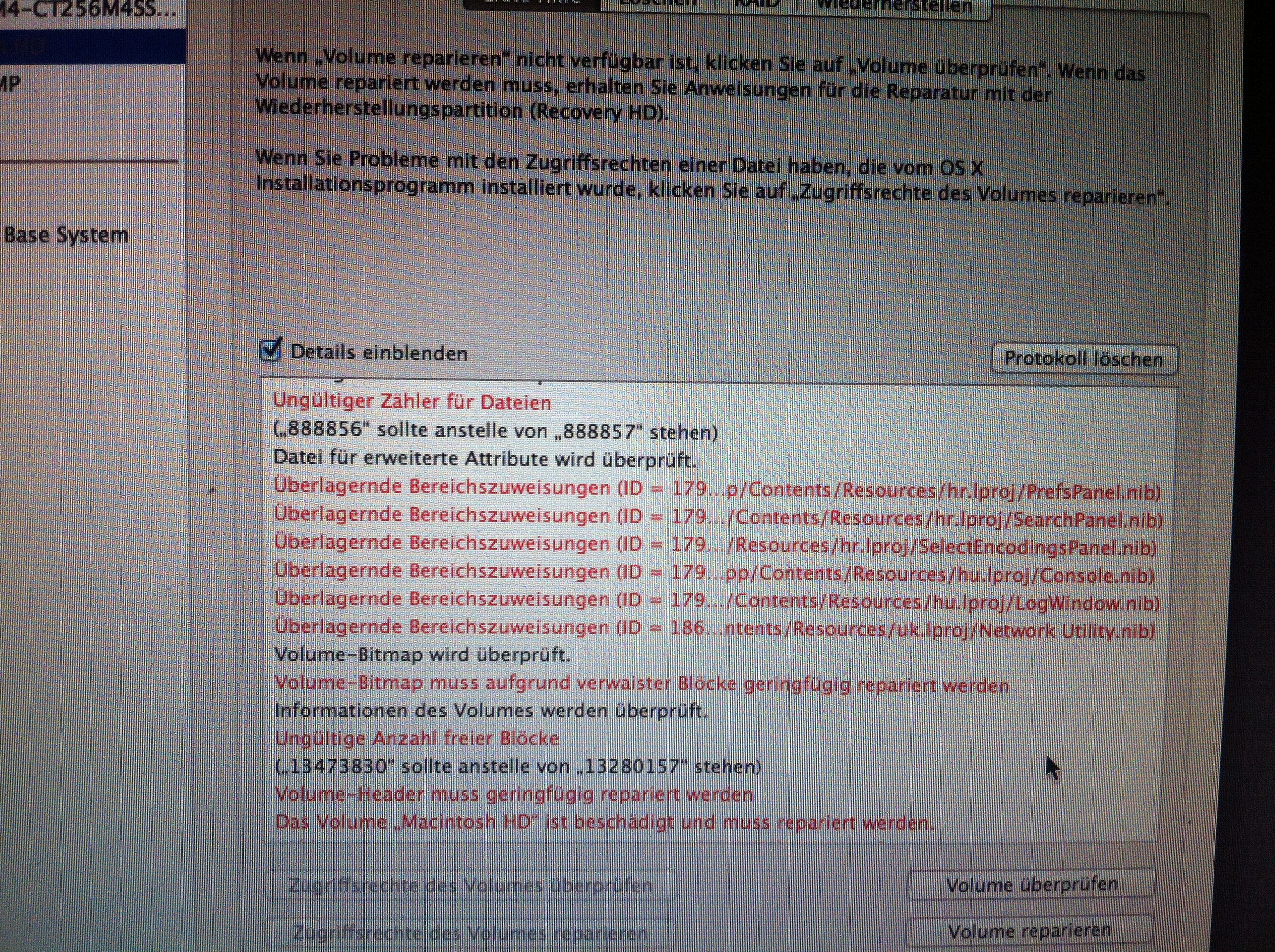

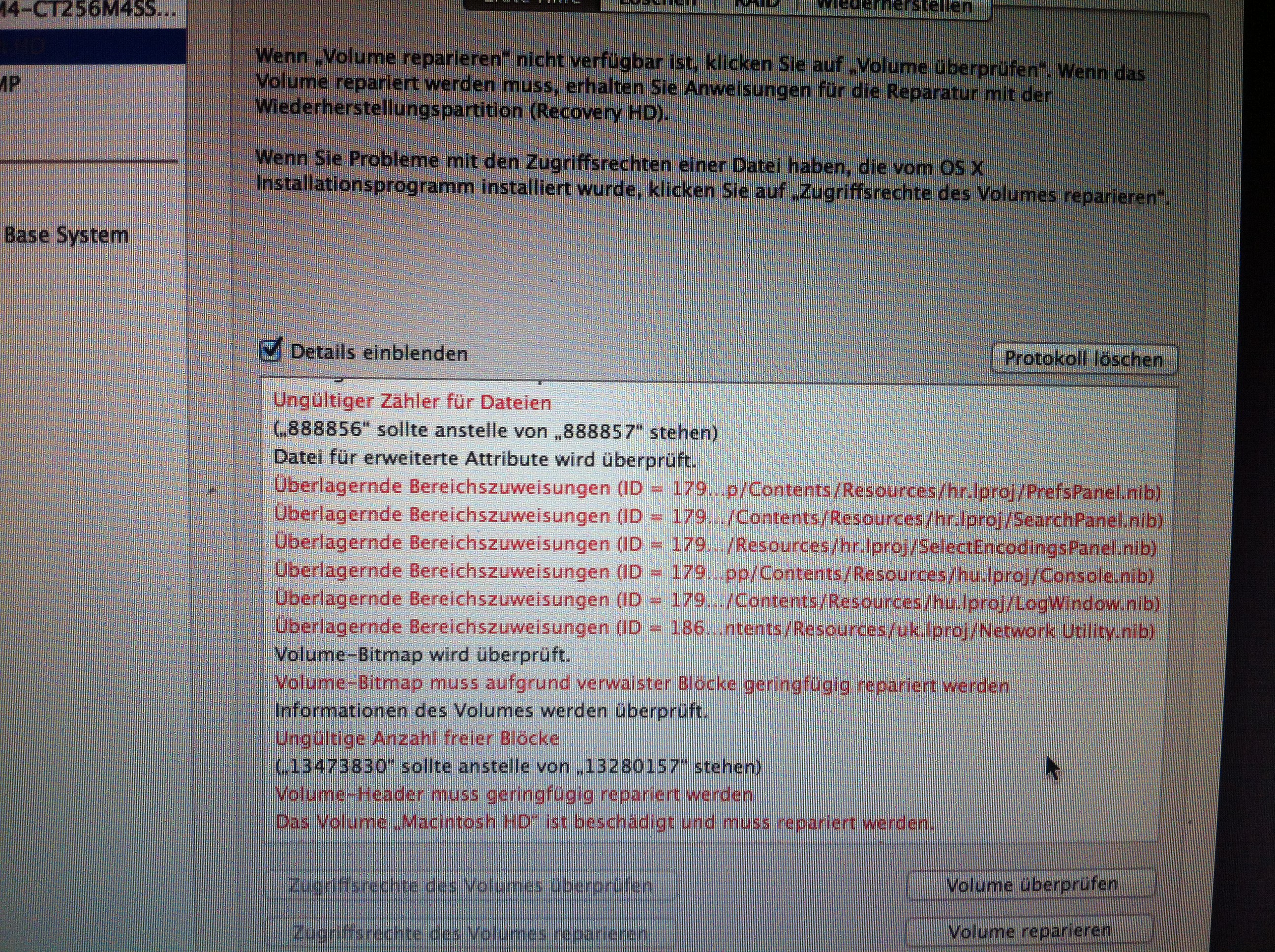

so I tried to use disk utility to do a volume repairing, but that wasn't successful (see attachment).

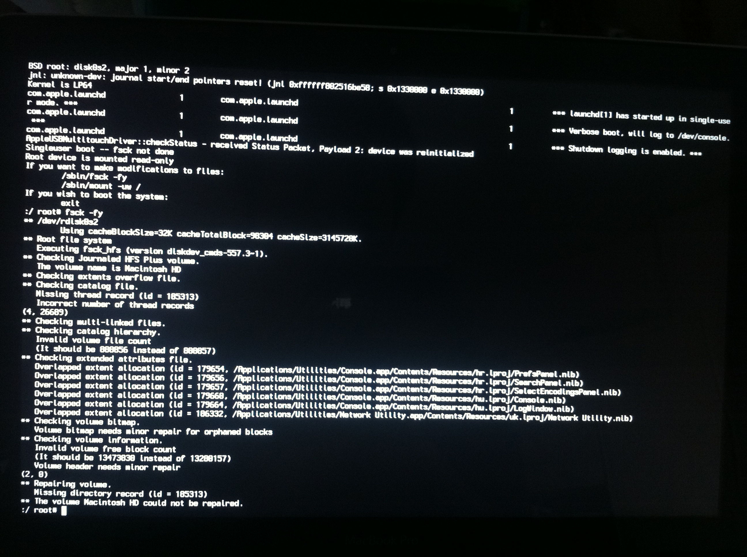

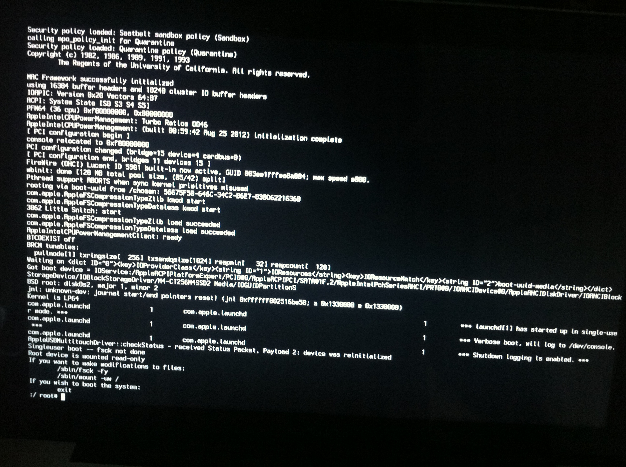

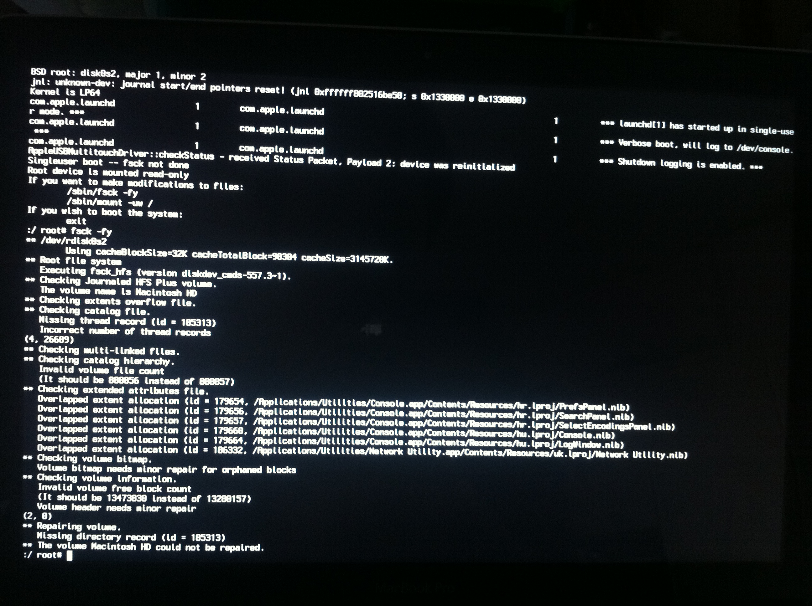

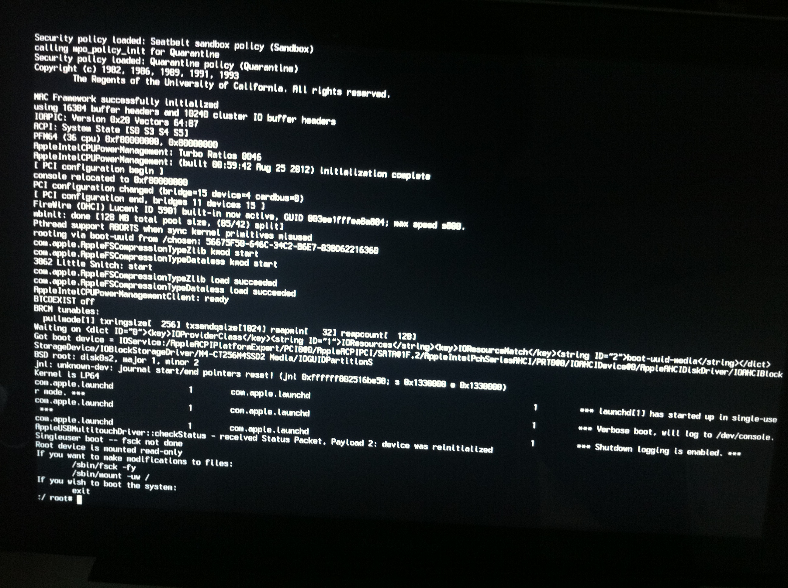

i also started up in single user mode and tried "fsck -fy", but also useless (see attachments).
the next thing i tried was "diskwarrior". I removed the hard disk, put it into a case and connected onto the macbook of my sister. then i started diskwarrior. at first, diskwarrior wasn't able to rebuild the decretory, because of error 37 (lol, same error number as in diablo 3). so I did a repair on disk permissions and checked all files & folders. that fixed some problems but I still couldn't boot from the disk. when I tried diskwarrior again, the error 37 disappeared and i was able to hit the "Rebuild"-button. but at step 12 of the rebuild, error "2175, 18" appeared. it says that there are some overlapped files on my disks...

that's what I'm doing now. i forgot to mention that this is the second time, that this happened. after the first time, i installed ML from scratch and thought that the problem was solved.
I'm wondering what the cause for the overlapped files is. I'm starting to suspect that there might be some incompatibility between ML and the Crucial M4...
Now why in gods name would you take that leap in logic? 😕 I've been using an M4 for almost 2 years now. (with Snow Leopard, Lion, ML) and never an issue. There are 1000's of these drives in use.
