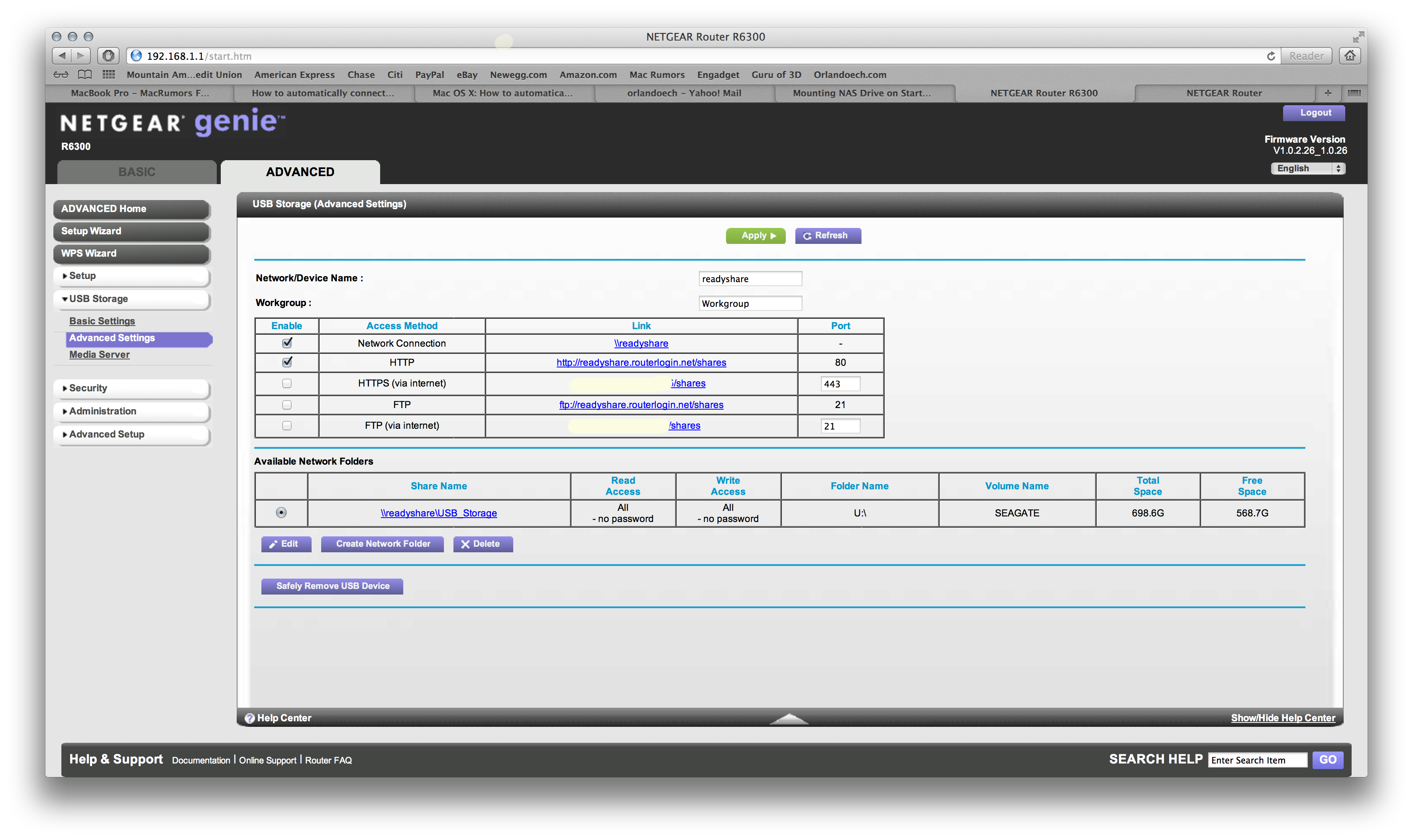

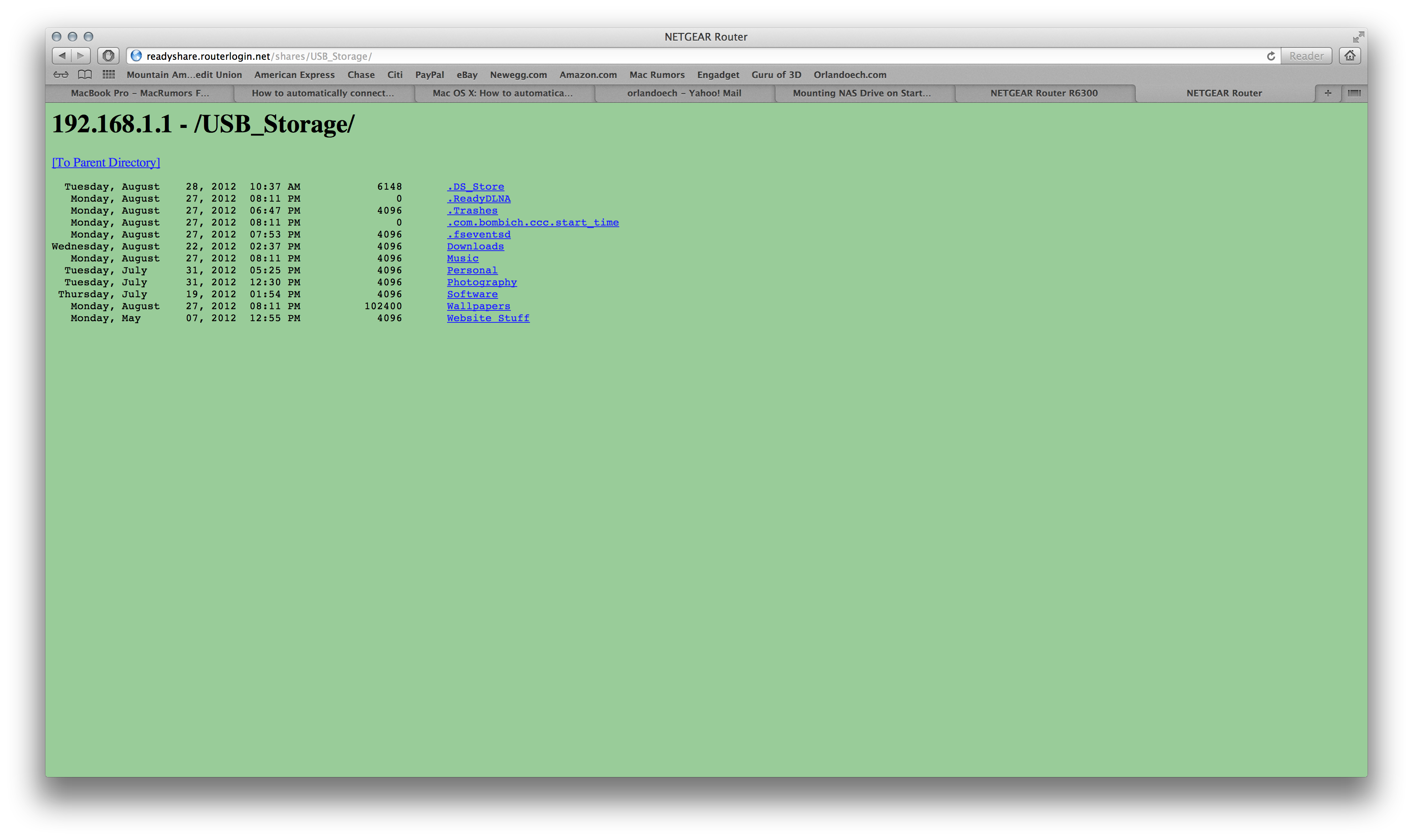

Im using the USB Readyshare via my netgear r6300 router.
If I go to it in my browser, I dont get any certificate messages, it just takes me to the directory as usual. Screenshots attached.

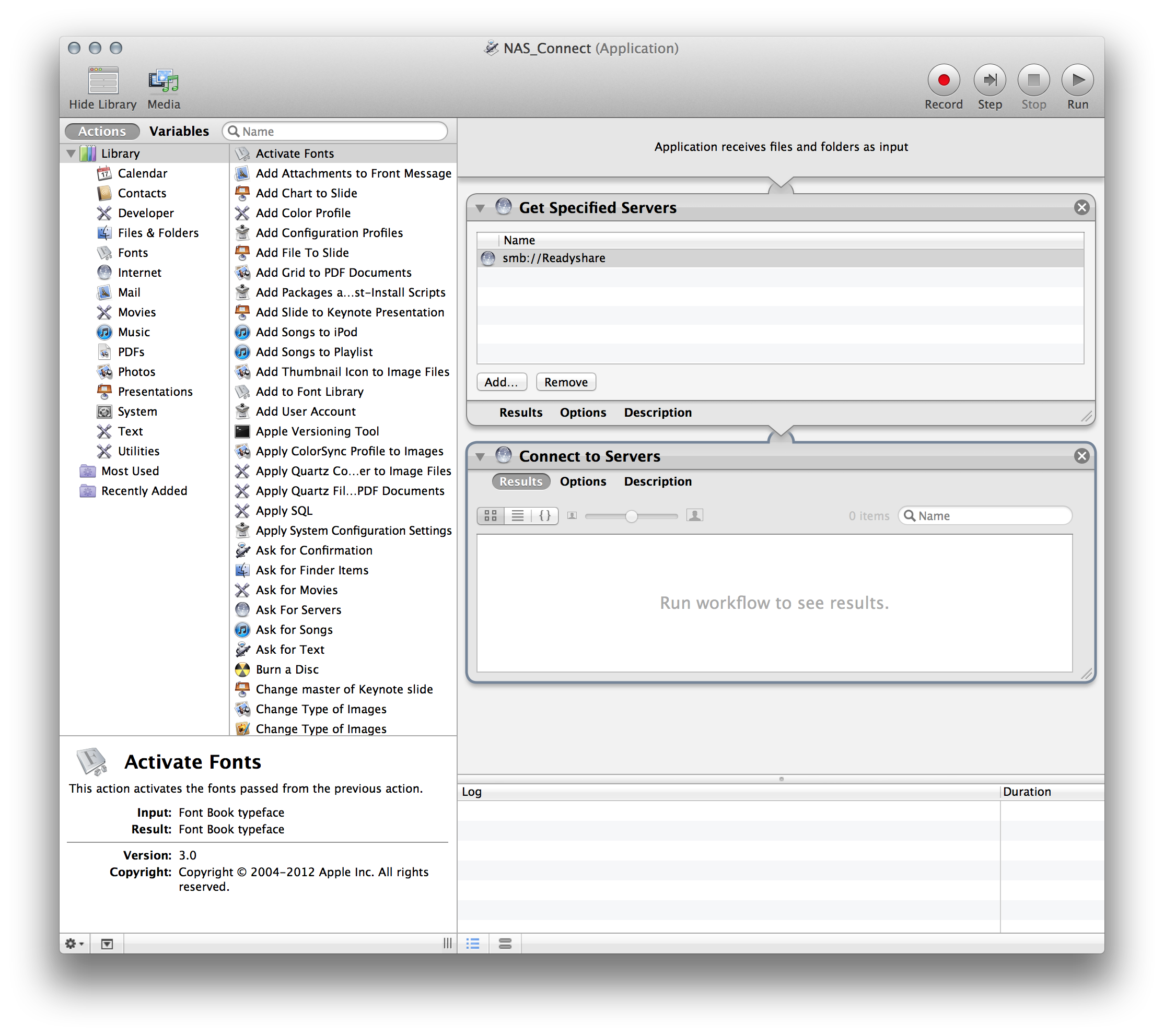

Well I figured out another way of doing it all by myself lol.
Used automator to make a custom app which I use in my login items. Seems to work with no issues.
