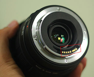

The problem with lenses with different mounts is that their contacts (see below, the gold things on the canon lens in this case) are they way they communicate with the camera. That's how the camera pushes the focusing motors, and sets the aperture during exposure. Different manifacturers have different mounts, as well as different contacts. All an adaptor does is allows a lens to be mounted onto another mount, but there are no contact converters. So yes, there are some companies that make any mount- to - any mount adaptors. Manual focusing and stopping down still applies.
attachment.php
