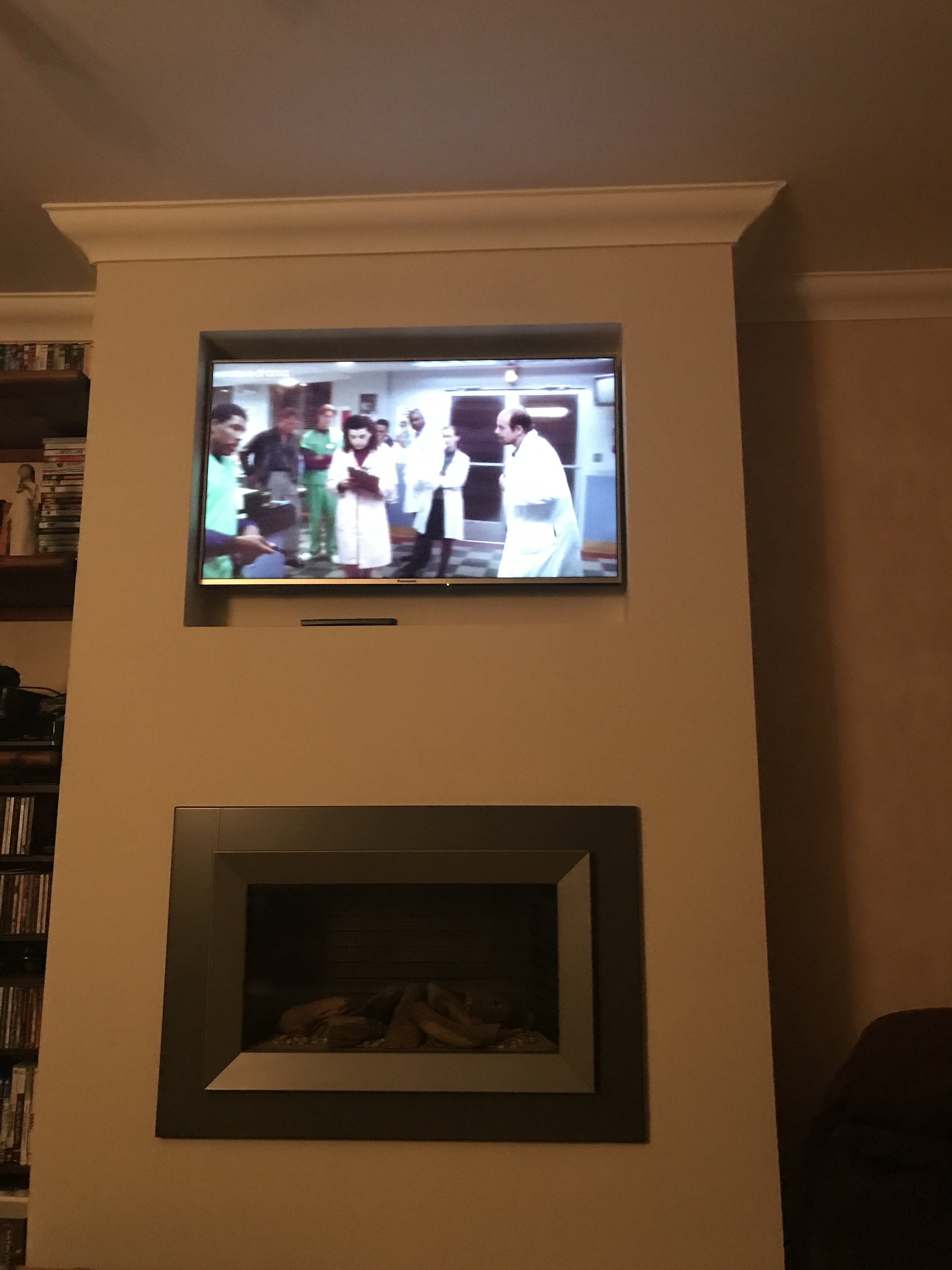

Similar, but I’m not going to have the TV recessed like that. It would be more like this:

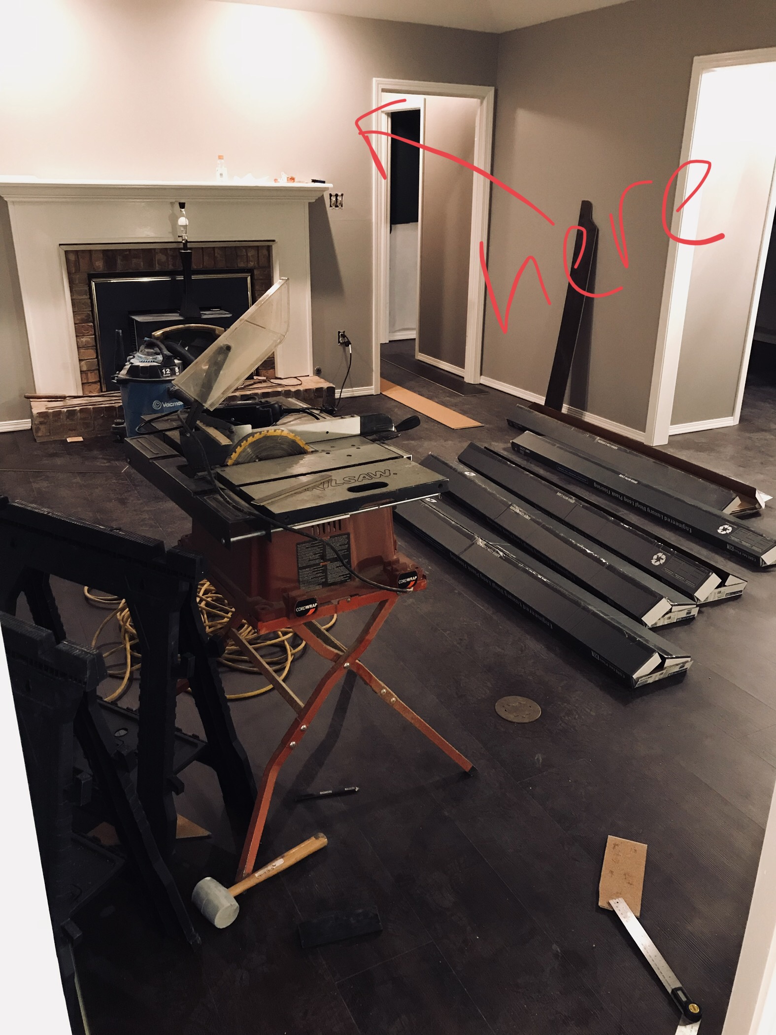

Here’s a pic (mid reno) of where it’ll be.
