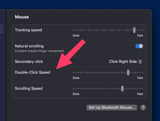

Have you tried adjusting the Double click speed in the System Settings>Mouse panel?

It will not work, the mouse double click issue is within <0.1 ms
