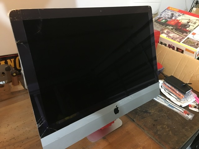

I changed the screens over between my 2015 iMac and 2103 imac (both 21.5 and non-retina) today. The screen on my 2015 model was cracked so i wanted the good screen on that machine. The swap worked perfectly and both machines are working fine - the only thing I had to do was to swap over the LCD data cables between the screens as they were different in width where they join onto the Logic Board.
Yes, I also managed to successfully swap display panels between the 2015 and 2013 iMac:
