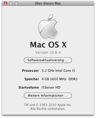

My Hackintosh is up and running (posting from it right now).
Running stable at 3.2GHz with SpeedStep and TurboBoost enabled.
