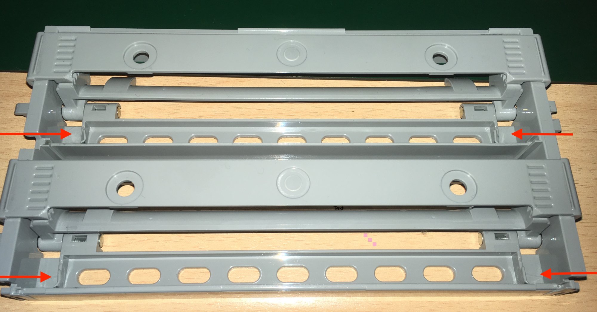

there are some tricks, loosen the 1st screw you see and place a washer under it.
lossen those 2 screws what holds the bezel and arrange it.
make a bit room for the mechanic when shrunken. See the image.
taking the assembly out is a pita. Only if you are in the right mood ;-)
don't know if the Parts from 1.1 and 3.1 fit, guess yes. I never changed them, I fixed them.
sometimes it is enough to bend back the case a mm, needs tons of patience but works.
Thanks for the picture. I pulled mine a few years ago to try to fix it without luck. Those screws were a nightmare.
I pull the dvd drive and move the mechanism with the finger.
Then I carefully pull and press in all directions to see what make it stuck. You can also use a toothpick thru the front holes to see what movement is of any use.
