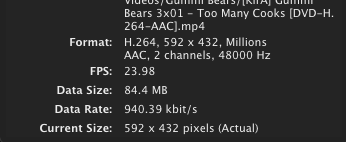

Here is the info from the quicktime movie inspector and the finder info;
Thanks!!!

How were these TV shows prepped for the Apple TV? (i.e., what software was used to make them, and what settings)? When you play the shows, what are the video bitrates?
I think it's called "data rate" in the QT inspector.

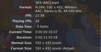

Here is the bitrate info;
Thanks!

Those numbers look fine for the ATV. You're using the Apple TV Preset in HB 0.9.3? You might want to dl the latest svn and update its presets and try again.
