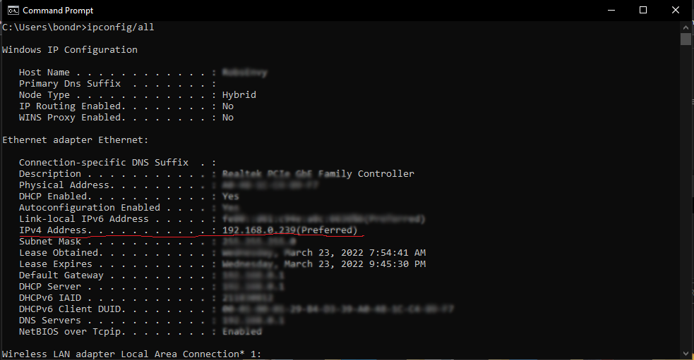

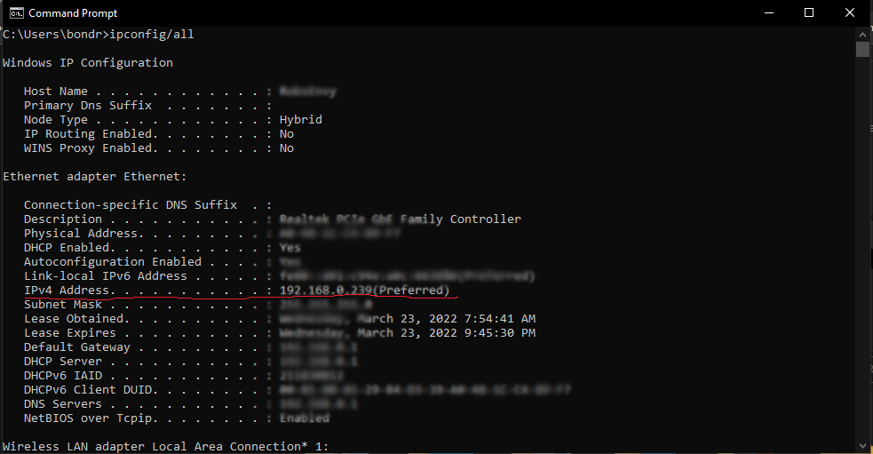

1. On your SP6 open the Command Prompt and type ipconfig/all
2. On the line that says IPv4 Address, get your SP6's physical IP address. Something like this:
