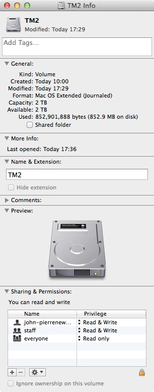

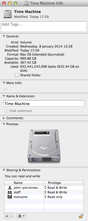

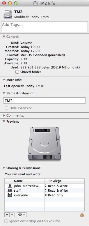

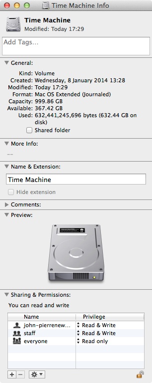

No checkbox and Mac OS Extended. Can you see anything here that may be a clue?
I see the checkbox there, it is just greyed out. Click the little padlock there and enter your PW to unlock, then you can check the box to ignore permissions.
Of course it is there on the Destination drive, I have now checked that one and Disk Utility seems happy transferring now-Thanks!
