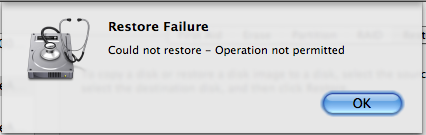

I did exactly that. Tried it several times. It appears to start correctly; then after a few seconds I get a dialog box that states this operation "not permitted" . . . no explanation.
Just frustrates me.
I must be leaving out some step that no one has bothered to mention, possibly because it was too obvious to document.

Unmount the volume before trying to image it.
Just tried it again. Same result.
http://att.macrumors.com/attachment.php?attachmentid=106677&stc=1&d=1204845065
This is such an obvious thing that users will need. I wonder if Apple has ever published anything on the subject.
You have to unmount the volume otherwise it will always show as busy. I got the same issues and I solved it by un-mounting the volume. Disk Utility's error message should probably suggest that but anyways, that is the answer.
