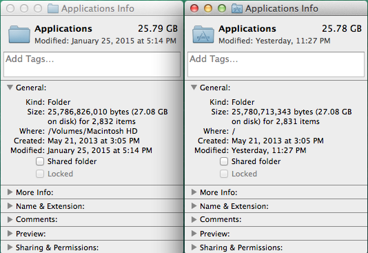

I just created a new account on a new SSD, and wanted to test it first. Everything seems to be running well so I MA'd the apps, and started testing them as well - so far so good. Next step should be to migrate the data, but MA doesn't seem to allow too much selectivity there so I may need to go manual.
What problems?
I am interested to learn how effectively MA transferred the apps. Do you know the size the apps before and after the transfer?
I can't comment yet on how effective the transfer was. I have only used a couple apps for far, but iMovie is almost a different app, it runs so fast now. It may take a while to test all of the apps.
I can see the details about the app folders on the OEM HD and the new Tbolt SSD however.
