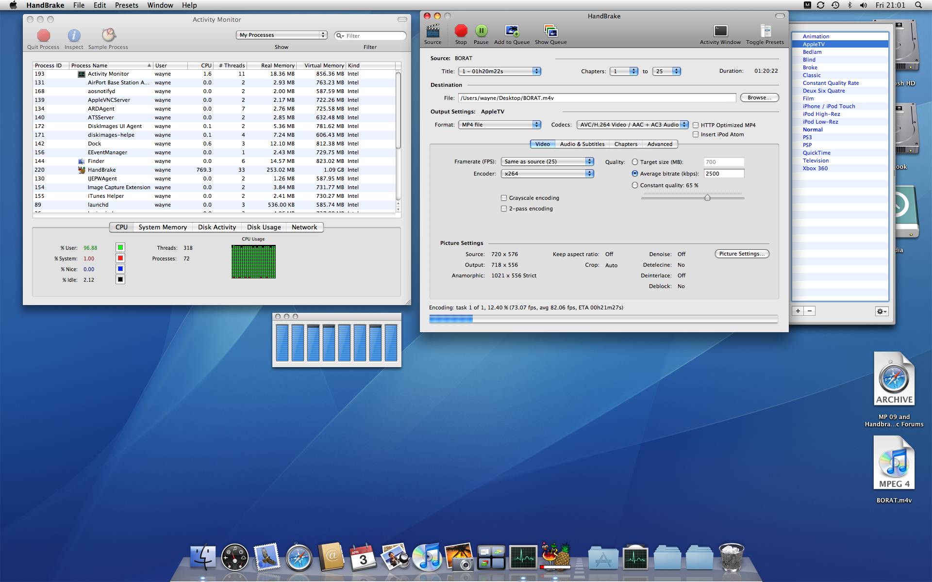

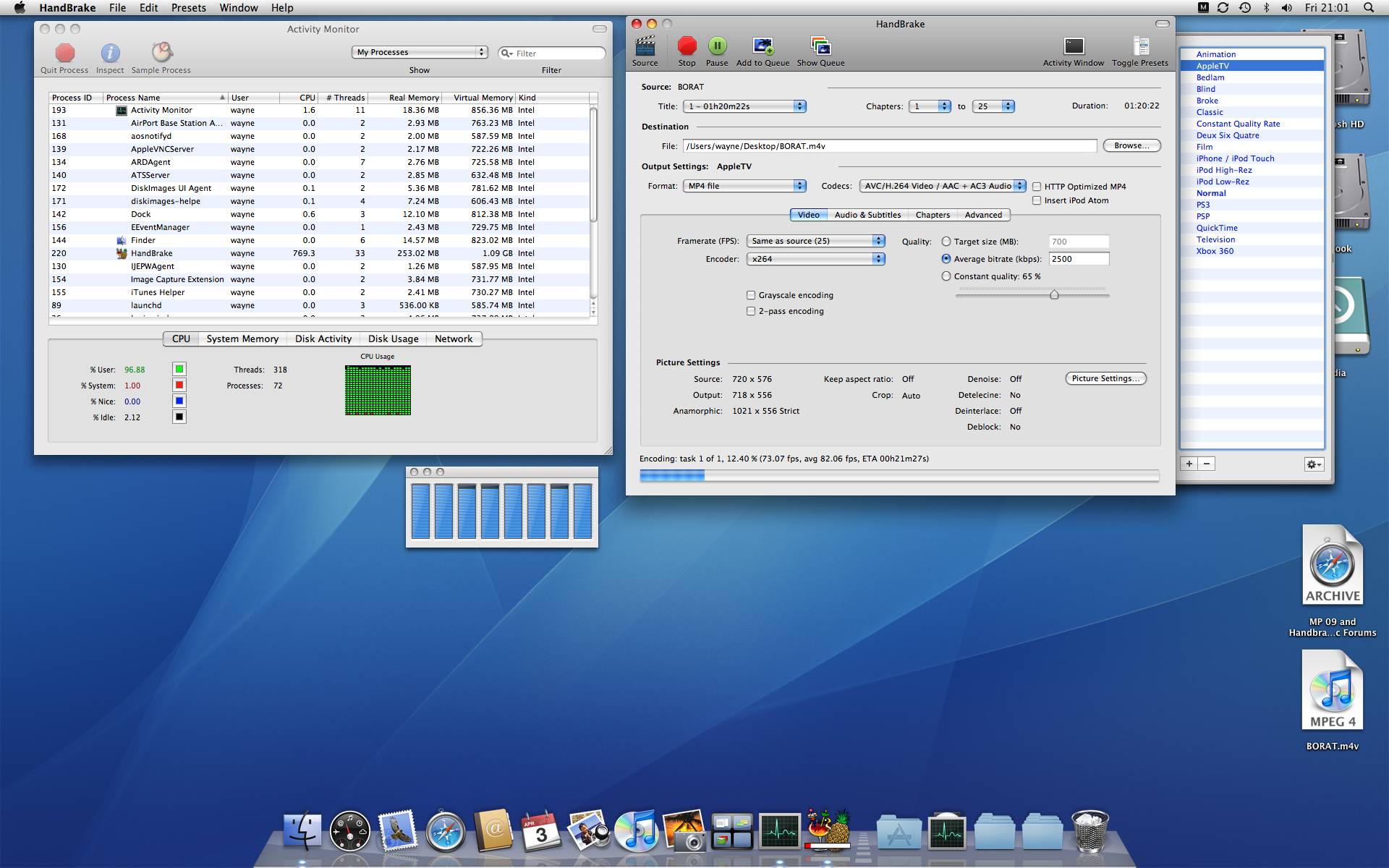

Not quite. I have a 2006 Mac Pro with four cores, and the latest version of HandBrake. Sometimes the app will max out my CPUs, and sometimes it'll only get to 50-70 percent.
