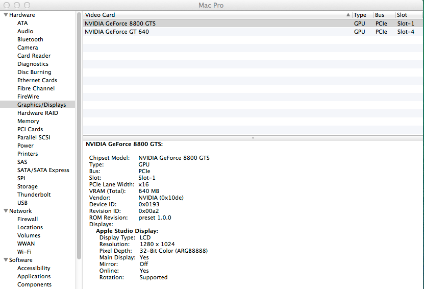

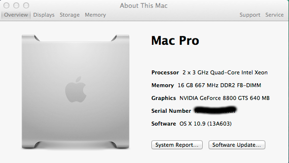

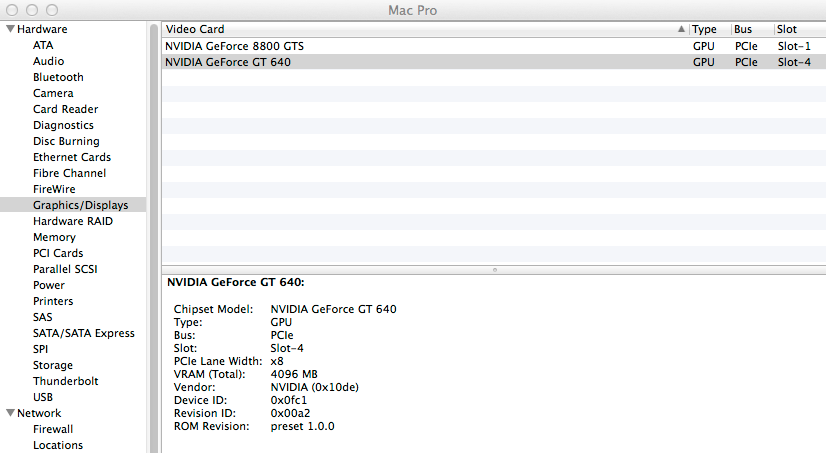

Step 2: After going from OSX 10.6.8 to Lion, I went from Lion to Mavericks, following Tiamo's advice here: https://forums.macrumors.com/threads/1598176/. You can then use many ATI and Nvidia cards. Personally, I like the GT 640/4G for a low cost, low power, low CUDA performance, large frame buffer GPU card ( which you can find at NewEgg for under $100 new and at Newegg (refurbished/warranted) and EVGA (B-stock/warranted - same as refurbished ) for about $80. But your options are many except, for the time being, staying away from the GK110B GTXTitans and GTX780 Tis (highly expensive in any event given your budget) because they currently exhibit OpenCL issues with Mavericks. I've tried GTX480s, 580s, 680s, and regular 780s in mine and they all work fine, before settling with one GT640 (it doesn't require any power cable) and an old GTS 8800 (it requires just one 6-pin power cable) that I had in storage in this particular 2007 Mac Pro. I can live without the boot screen info. If you use Final Cut Pro significantly, you should probably consider an AMD card because it will give you better OCL performance. I'm looking into the R9 280(X) and R9 290(X) for my Final Cut rig, but both are outside of the price range that you've set. You might want to consider a Radeon HD 7870 [ http://www.newegg.com/Product/Produ...00298540&IsNodeId=1&Order=PRICED&Pagesize=100 ] to stay within budget. If you want a CUDA capable card and want something a lot more powerful that a GT 640, then watch the B-stock here: http://www.evga.com/Products/ProductList.aspx?type=8 , but also note the disclaimer about "no accessories."
Here're pics from one of my updated 2007 Mac Pros:
