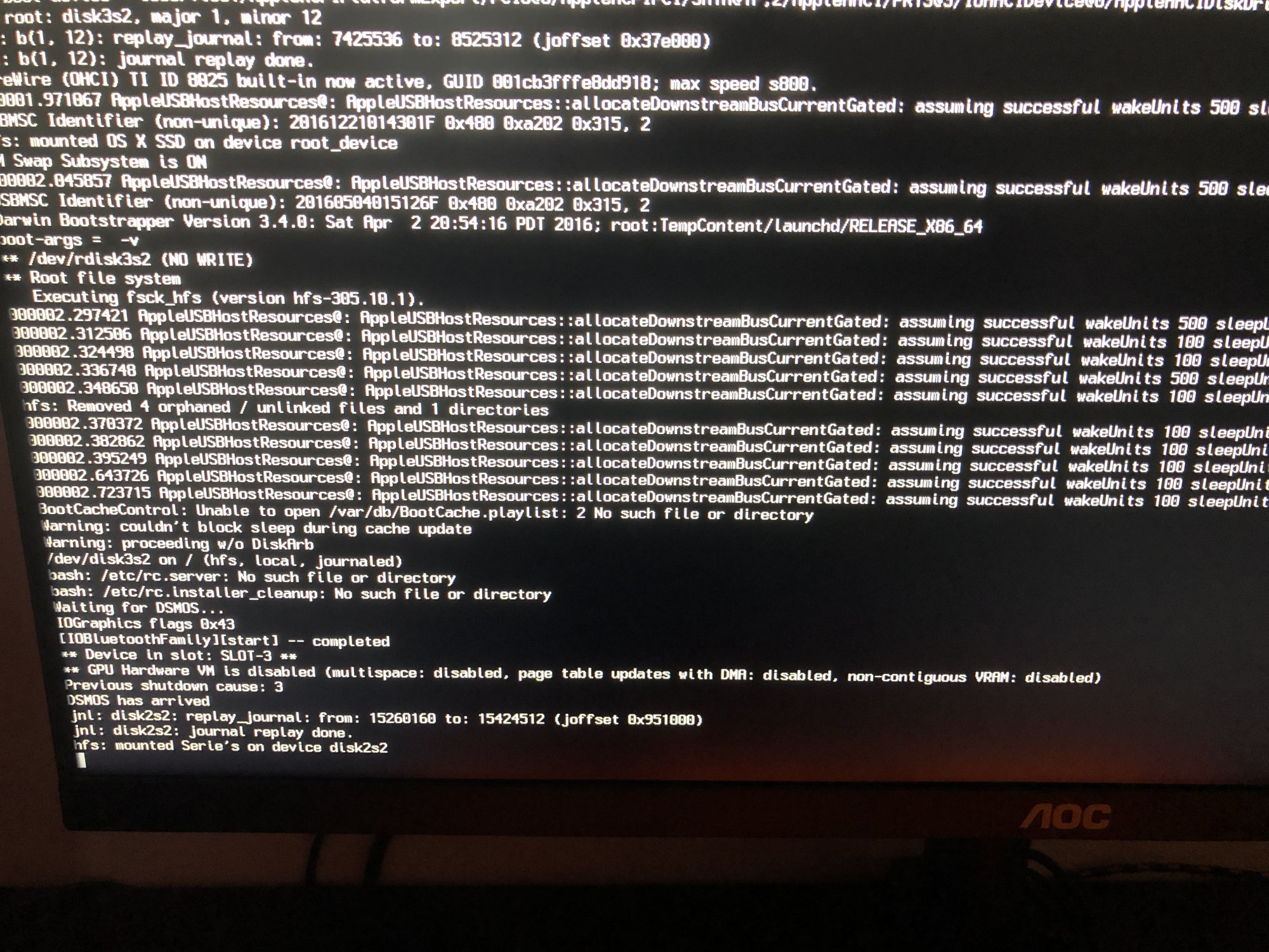

in lion the hd 5770 works really sluggish and slow.
with el capitan i can't even boot, it keeps hanging on the apple logo and sometime's restart's, when i boot in safe mode then i can boot up to el capitan.
someone can point me in the right direction?

the card works perfectly in windows 10 so i doubt there is an issue with the xfx hd 5770.

XFX GPUs are known to be problematic on Macs. Some work OK, but many do not (they often deviate from AMD's reference design). If you have another Mac-compatible GPU to test with, I'd try that first.
with the original ati 2600X everything works perfectly so it's the XFX brand that's causing the issue?
i mostly am using it in bootcamp windows 10 so not a big issue.
