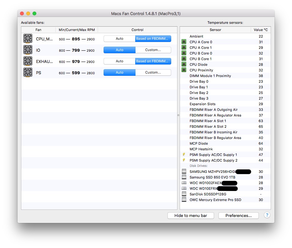

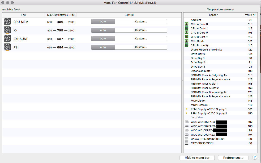

Hey, trying to get a bit more knowledgeable about what is going on with my fans and heat, etc. Since I've made a lot of updates to my machine started thinking/worrying about it. I installed Mac Fan Control and have attached a photo of it’s default... not really sure what temps anything should be or what is too hot. Could use a bit of fans/heat 101 here.

First thing you should do is switch to Celsius. These parts are rated by their manufacturers in C, every discussion about component part heat is in C, and all references you look up (for example TDP) will be in C.
It doesn't matter if you are accustomed to temperature in F, because there is no purpose in relating computer component temperatures with the weather, or a fever, or baking a pie.

Your fan speeds look great. I don't see anything to be worried about. You could post a new screen shot with figures in C.
I am not familiar with the 3,1, but all temperature looks good to me EXCEPT the PSU temperature. That looks way too high. May be some other 3,1 user can confirm if it's normal.
Yes, maybe others can confirm. Would be nice to know what the best settings should be.
It wouldn't hurt to blow out the accumulated dust in the power supply to see if that improves anything.

Attached shot of my 3,1 at idle. I agree with others your PSU values are on the higher side of what I’ve seen posted elsewhere.

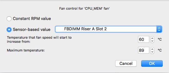

BTW, anticipating the question, I have 8x4GB 667MHz Samsung RAM that have flat heat spreaders but not the big black winged spreaders that came with the original 800MHz memory. Module B2 tends to run hot (currently 69°C at idle per iStat widget) and shoots up pretty quickly under load. So I have the CPU_MEM and Exhaust fans sensing FBDIMM Riser A Slot 2 with a custom fan speed curve I derived after a little experimentation. Some people will look at this as being unnecessarily conservative and wasting energy by running the fans higher on idle than Apple engineers intended (not to mention increasing the rate at which I breed dust bunnies inside the machine, lol) but I feel better about keeping that RAM stick running cooler. Even under load it never hits the max temp I have configured.

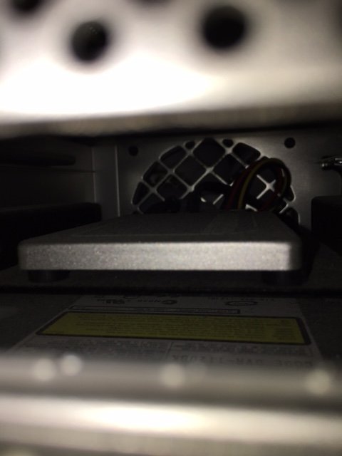

Sounds like you have extra PSU / SSDs sits inside the empty optical bay which effectively block the airflow to the PSU (or keep releasing warm air to the PSU intake). And eventually contribute to the high PSU temperature.

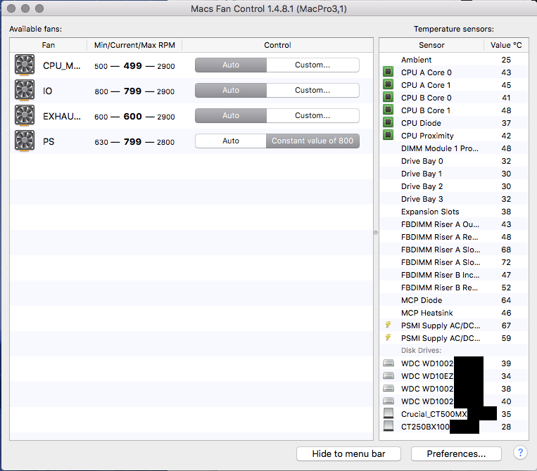

Yes, I have an SSD in the top optical and an optical in the bottom. I haven’t taken everything out yet to do a full cleaning but did open up the side and did some superficial cleaning and was able to get some air through some openings around the PSU and get a dust cloud shooting out the back which was promising. I also have an external sitting on top of the case directly above the PSU which I have elevated a bit so there is air flow between the top of the case and the bottom of the external. Just to see I have set PSU Fan to 850rpm constant for a bit and the Supply 1 is 63 and Supply 2 is 57 give or take a few degrees. I'm attaching a pic which shows the SSD in the optical bay. Also OS6 it looks like you are running an additional fan? Or is that blue thing OEM.
So, I blasted out more dust from the back to front but I don’t know if I'm really going to be getting below 50. Supply 1 is 66 and Supply 2 is 59 give or take a few degrees. That is with fan running at constant value of 850 which I don’t want to leave as a constant in case the fan were to overheat and need more obviously. Any other tips? Maybe I've just got too much juice running through this thing. 4 HDDs, 2 SSDs, 1 Optical, GTX 680, Apricorn Velocity Solo, 14GB RAM.

I don't think you need to be concerned about the fan overheating by running at constant 850 RPM. The fan is designed to run at over 2000 RPM without overheating. Higher RPM means it will produce more noise and will wear out sometime sooner, but 850RPM is not egregious.
I'm curious to see how blowing out the case has affected your temps across all components, not just PSUs. Care to post a new snapshot of MFC while the machine is idle?
