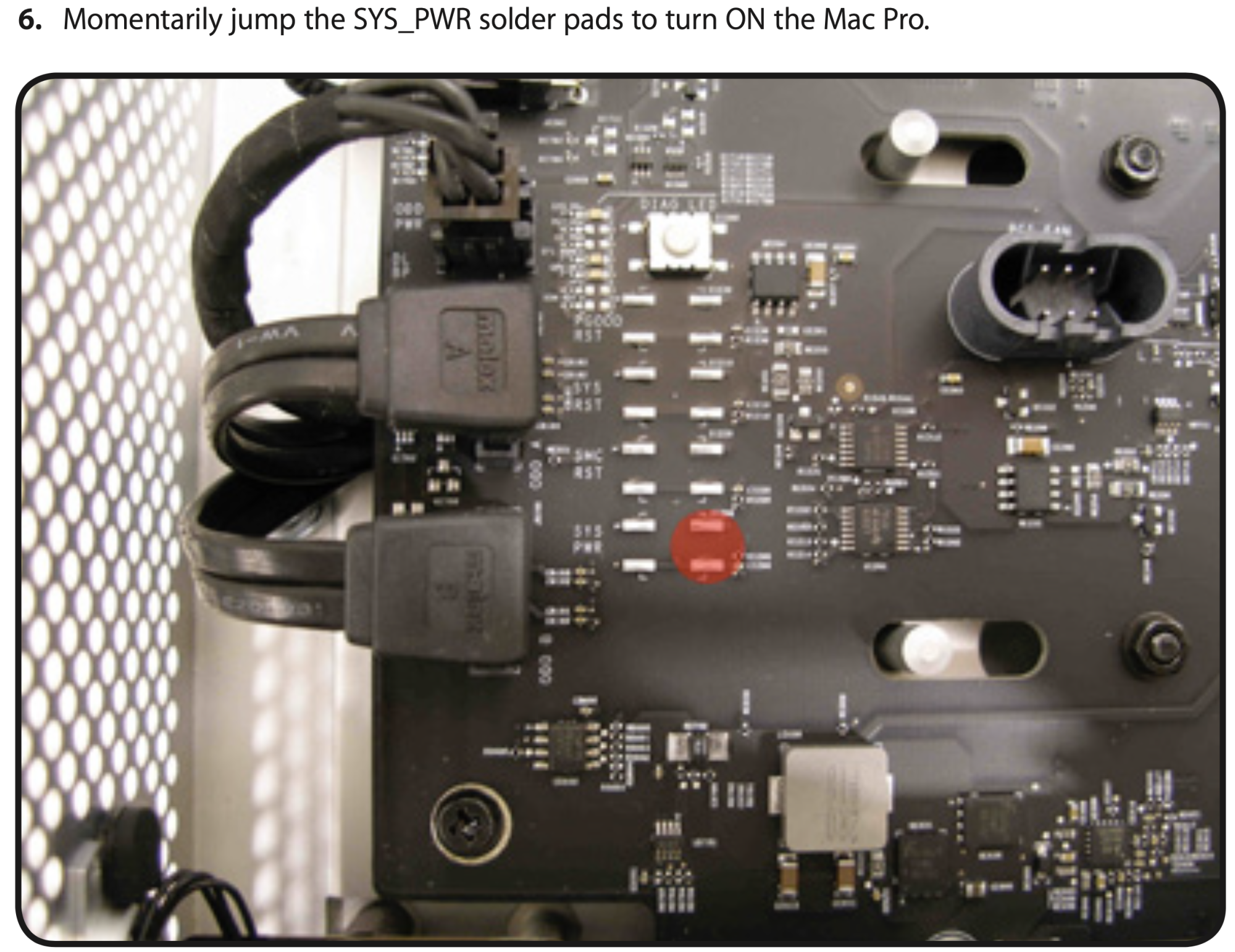

If I disconnect the front panel how do I switch the machine on to test the back ports ?
Ok just disconnected the front panel and powered on but still no working USB ports at the back.
