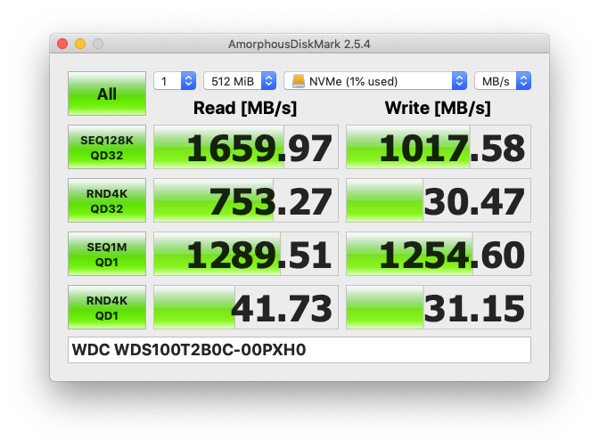

Hey @tsialex Seems to be working for me
OK so I see where it's listed as not compatible ugh...
