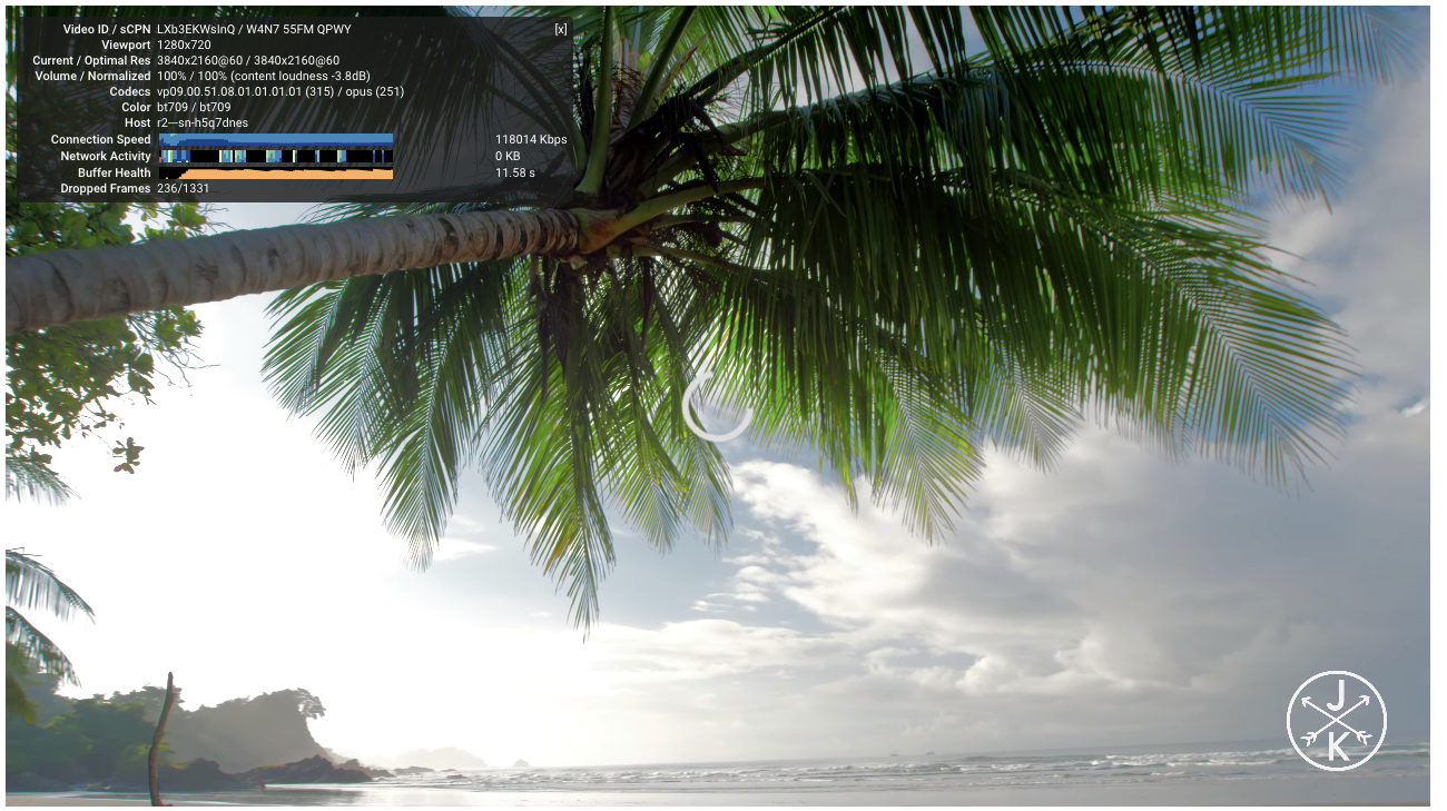

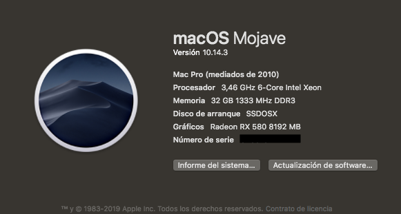

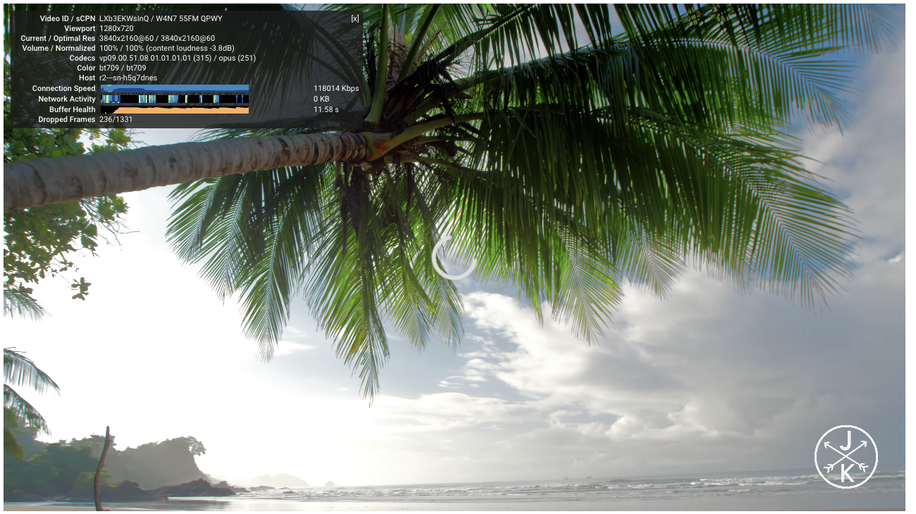

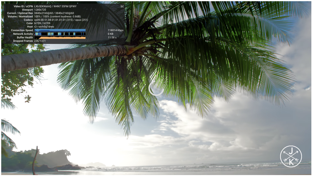

Here are my screens (lot of droped frames):

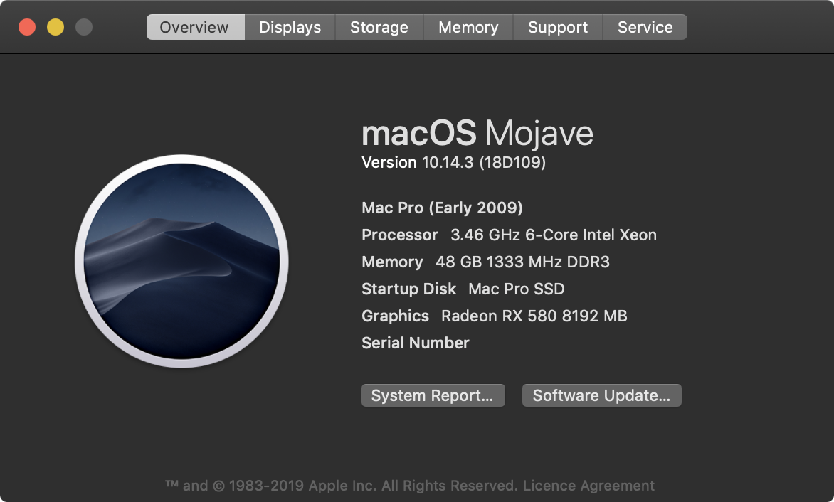

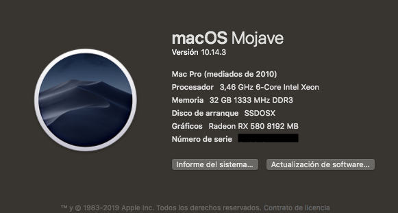

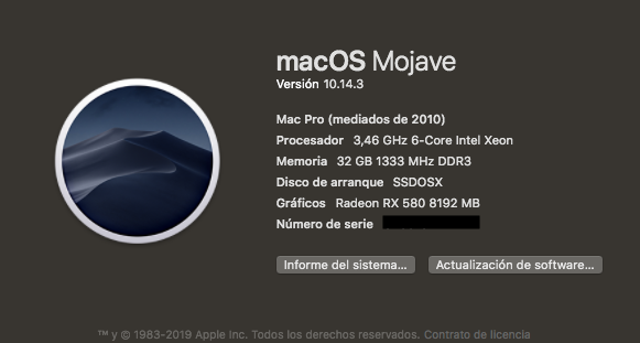

My system:
The only thing I saw different is your view port (1920x1080 and mine is 1920x720) ..
EDIT: Do you have any kind of codec or similar installed on your Mojave installation?
My system:

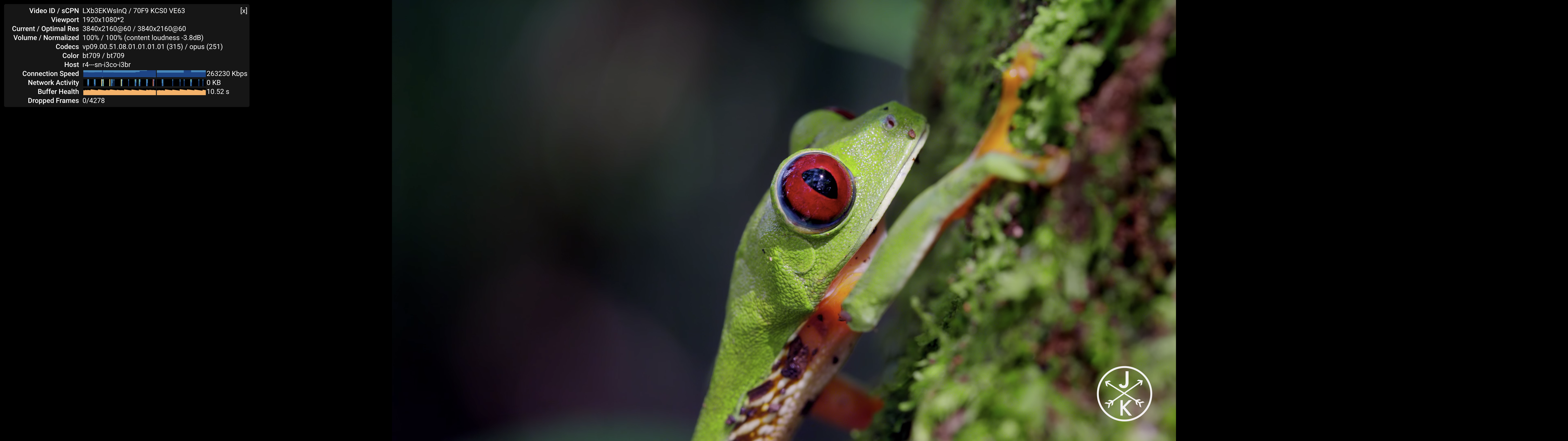

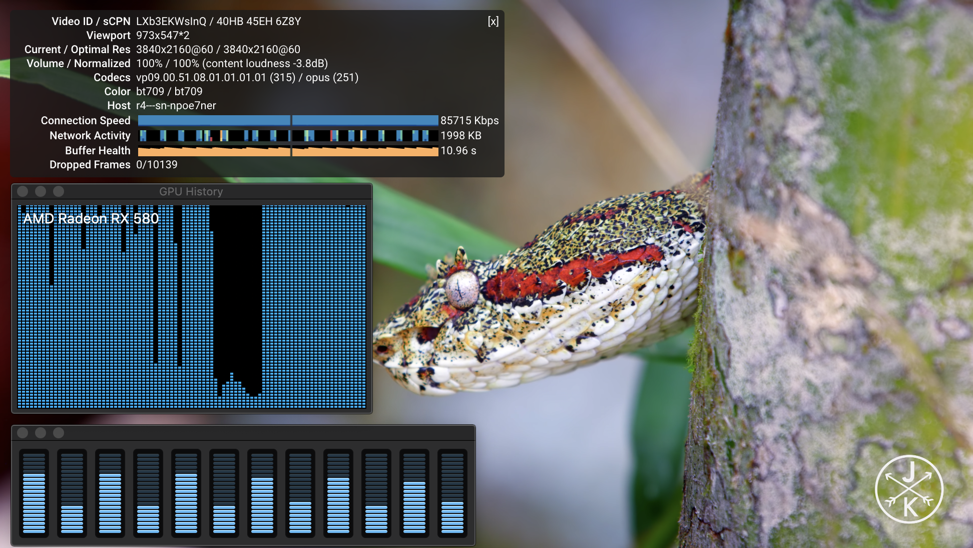

720p view point shouldn't make any difference. (p.s. I believe that *2 is because I am running HiDPI, which should be more demanding than non-HiDPI)
No extra codec installed. Just native Mojave and Chrome.

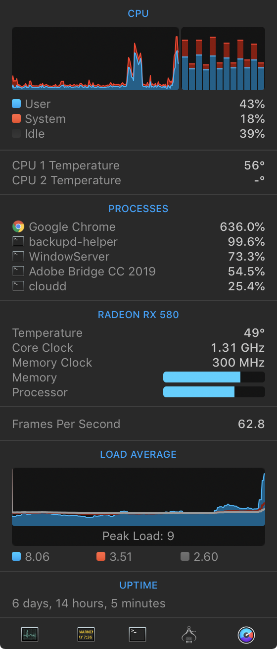

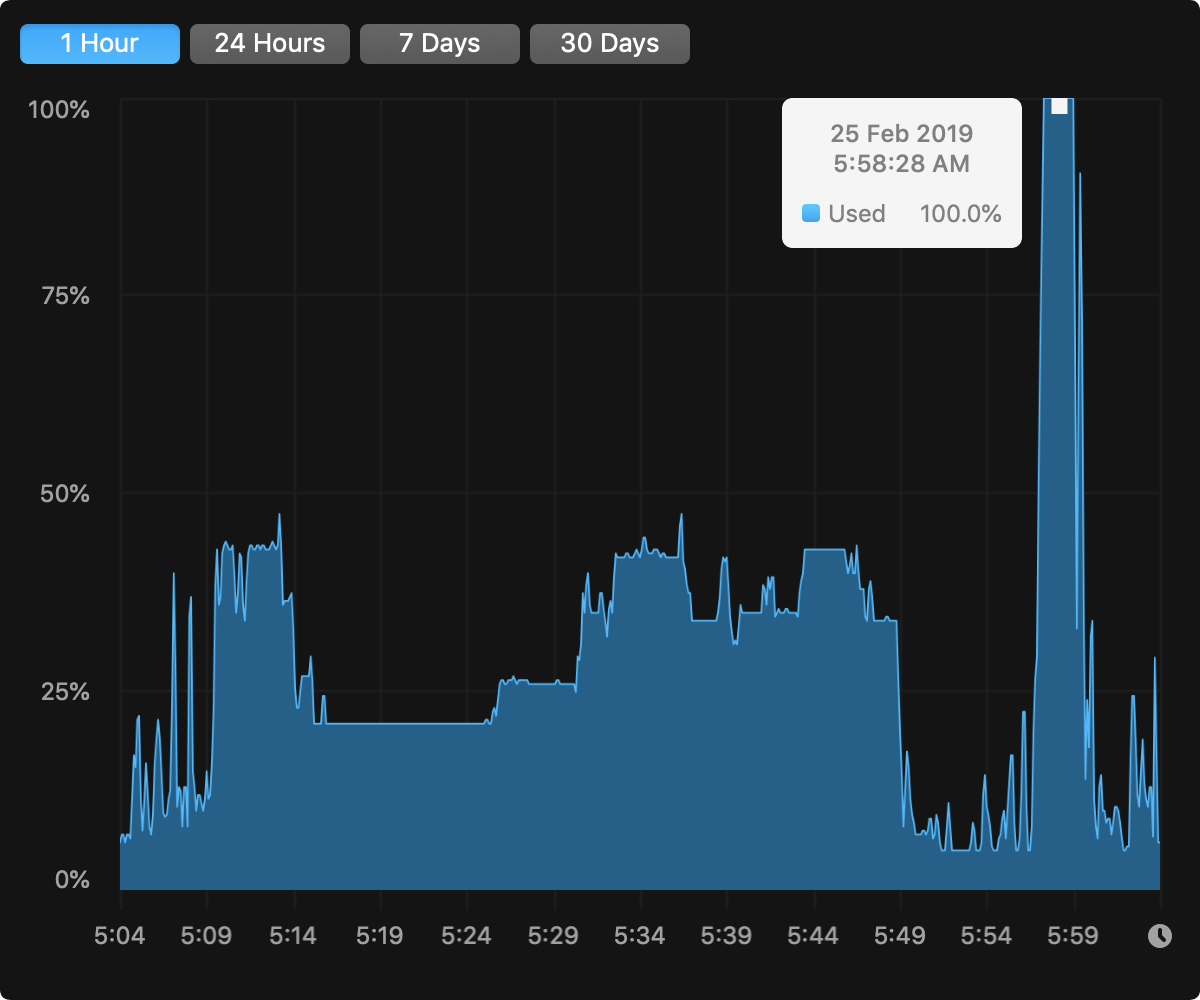

Some extra info. When I playing that YouTube video, the GPU utilisation rate is 100%.

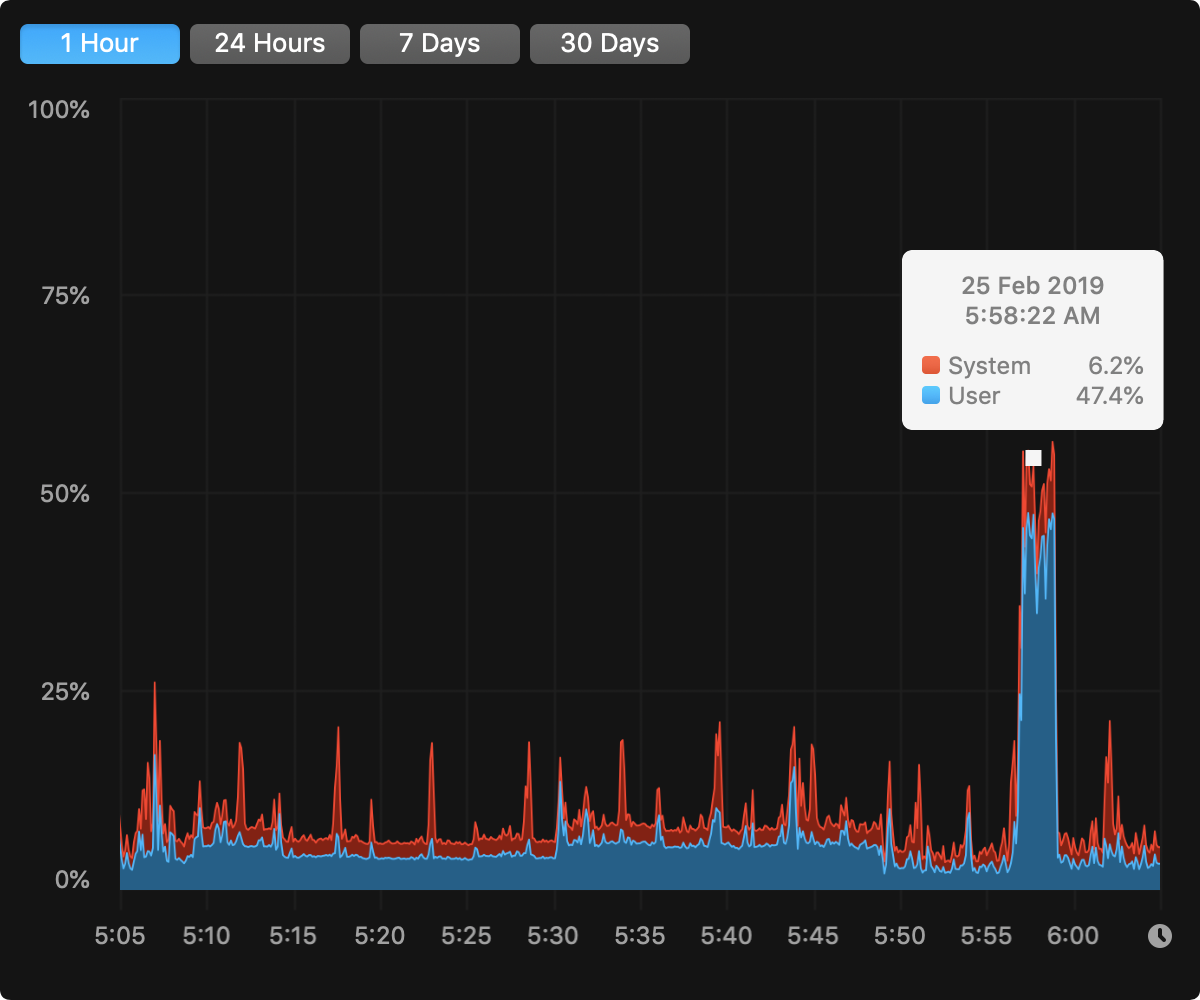

CPU utilisation rate is about 50%

That's from a 3rd party software called "iStat".
But you can get the same thing via the macOS build-in activity monitor (GPU History and CPU Usage / History).

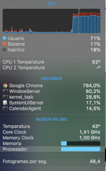

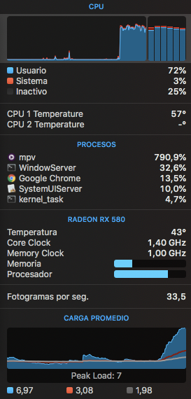

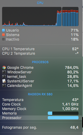

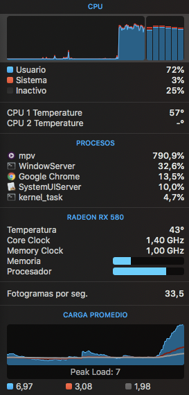

When I try to make this screen capture. I tends to believe the issue is due to CPU limiting.
As per my last post, the total CPU usage is about 50%. However, for W3690, only the first 50% are true physical cores. The 2nd 50% are the virtual cores, which means, performance not guarantee.
I suspect when you playing this video, due to some background activities used up some CPU resources, your CPU hit its limitation, and cause the shuttering / drop frames.
In fact, from this new screen capture. We can see that each physical / virtual cores pair are running almost right at 100% (assume each pair has 200% capacity). Which means, all physical cores may be already saturated.
Reactions: raist8

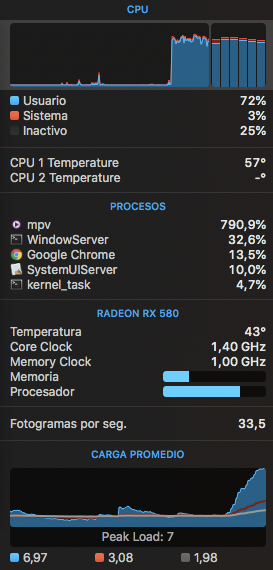

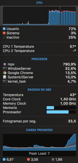

I think It cloud be a CPU limitation. The strange thing is that some users with same CPU specs, don't hace this problem..

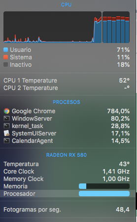

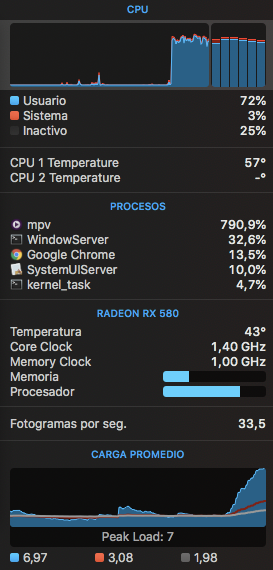

This capture is from a local video file in 4k 60fps (reading from SSD) and played with mpv . It seems that in local, the GPU is not at 100% during the execution, but CPU is near 100% all the time ..

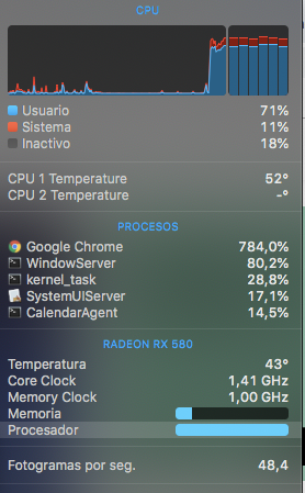

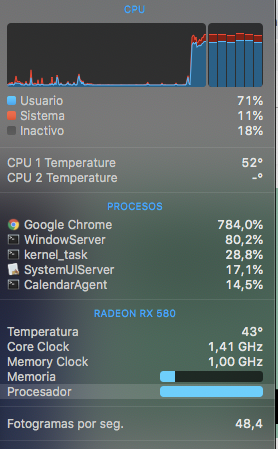

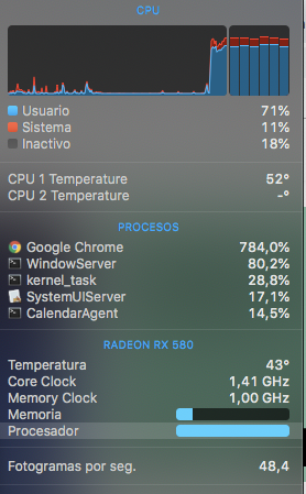

Here I have another from Chrome Youtube 4k60fps video. 100% on GPU and almost on CPU:
So, you mean even on a clean install Mojave, with the latest clean Chrome, with good internet connection, that 4k 60FPS YouTube video still very choppy (with that CPU / GPU usage capture)?
