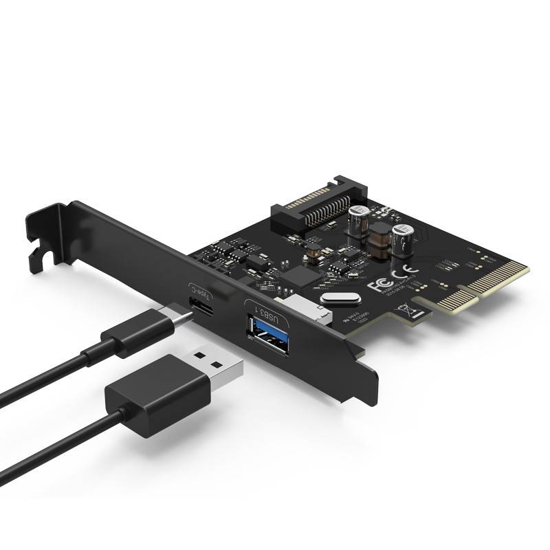

Is the card NG? Dock? Are there better cards now. I like the idea of USB-A and C
Is this the card ?
If so did you connect a SATA to PCIe power cable to the card >
Not quite - it's the one linked to (now discontinued)

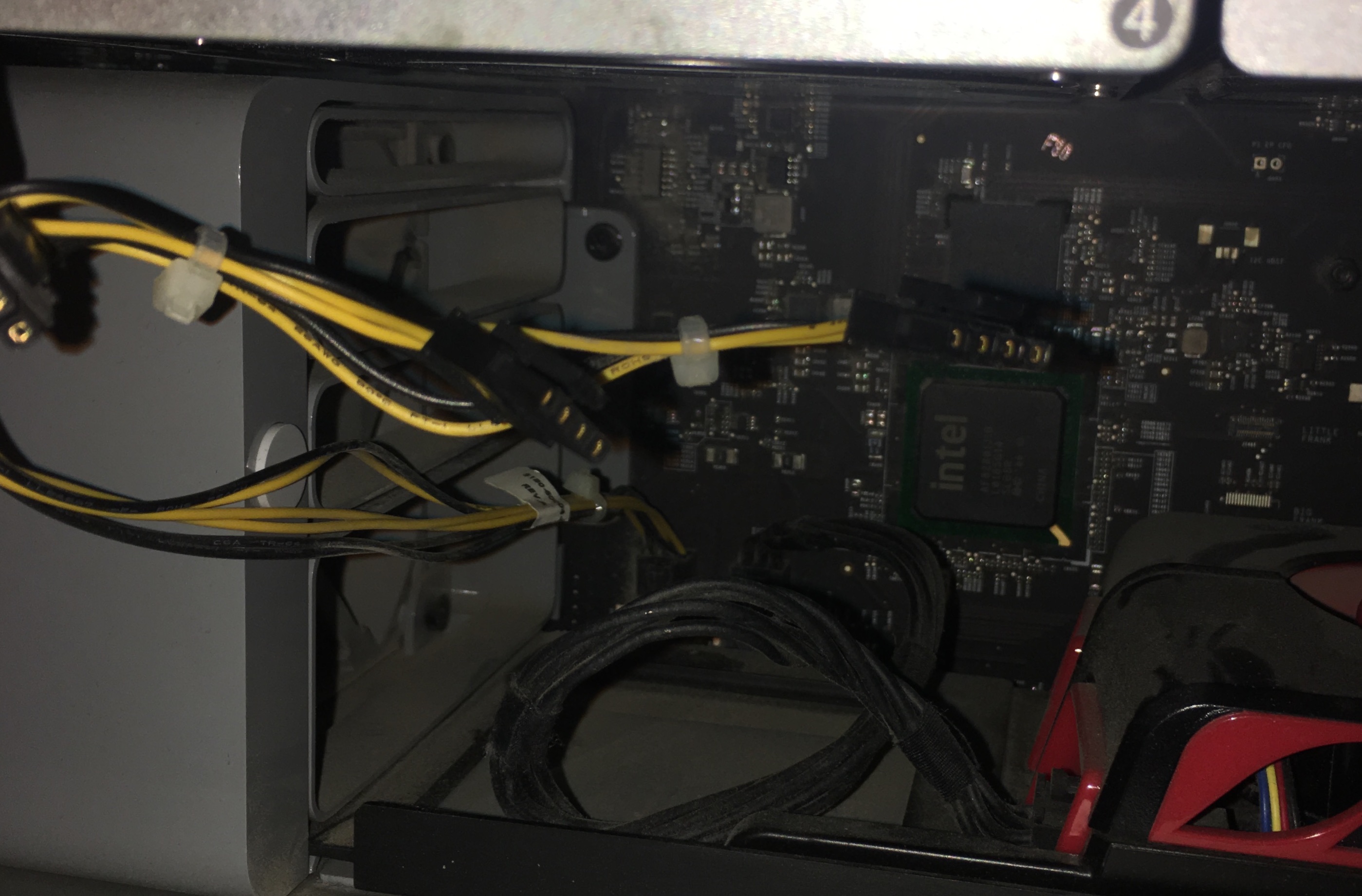

and where do you want to plug the molex 4 pin plug in the macpro?
I have this cable inside that was powering an AVID HDX card (which i no longer have)
Have I made an error? Will this not work?

Wrong cable. Should be SATA ( from one of your hard drive sockets ) to the SATA socket on the card. cMP does not have MOLEX cables.
Would this one work? Other than being too short?
NO. That cable is for a graphics card ( GPU )

Not unless you are willing to sacrifice one HDD and buy the correct cable. No.
Please make a " .sig " for your Macrumor posts .. help us to help you. Takes 1 minute to make.
If all of your drive bays are occupied, and you want to draw power from an SATA connection, get a "Y" splitter cable and grab the power from an optical drive cable. You don't have to ditch the drive, you can share the power...
From the splitter, you may need yet another SATA power cable to reach all the way to your USB3 card... Or not...
I would be far simpler to grab a known cMP USB3 card that doesn't need additional power.

I think people are making this too complicated. In post #7 OP showed a pic of a cable he already has installed in his chassis (plugged into one of his mini-6-pin pcie jacks) with molex connectors.
The cheapest, easiest way to power your USB card would be attaching a molex->sata adapter, such as this:
https://www.amazon.co.uk/Cable-Matters-3-Pack-Molex-Power/dp/B07JFLJ396
But I agree with the person who suggested plugging your HDD into the card directly (bypassing the dock) to see if it still disconnects. Still worth trying the supplementary power but could help isolate the issue further.
Nevermind, I forgot the card needs 5V, which isn't provided in the pcie connector.
