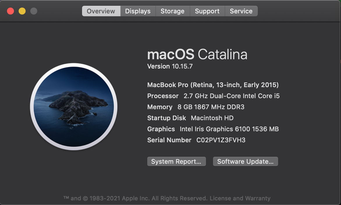

I created a Mojave boot drive and I turn on the cMP but I still get no display.
Did you test it on the Mac that you used to create that boot drive? (assuming you made it on a model that can boot natively from Mojave)
Yes, that should work.
Your MBPro (2015) can boot anything from OS X 10.10.5 (Yosemite) (It shipped with either Yosemite or El Capitan), and can be easily upgraded to macOS 12 (Monterey). It will certainly boot from a macOS 10.14.6 (Mojave) installer.
I mentioned that, because it would be good to test your bootable installer, to make sure that it will, in fact, boot another Mac.
Any bootable external Mojave drive should boot your 2015 MBPro (assuming the drive is made correctly)
You do want to make sure that you are trying a normal boot (plug in the external drive, restart while holding the Option key. Choose your installer from the boot picker screen and press enter.
Does your MBPro boot from that installer? If not, what DOES happen?
Okay so it does work. Tried it out and it does boot from the installer. So it works but when I try on my cMP I still get no display when I turn on while holding option.
