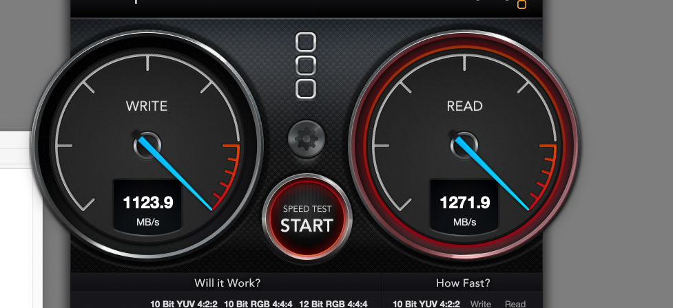

My RAM is sufficient for now. I have 64GB, 45GB is allocated to PS, so that shouldn't be a problem. I am aware that I can upgrade it to 128 GB, but it's 1333 MHz, so I guess it would be slower (?). Also, like said, my CPU load is about 5% while working, so it's negligible.
PS supports PSD files up to 2 GB. That's why I work with PSB files, and PS supports up to 4 EB (or 4 million GB) of file size. That said, I don't think a 10gb PSB file is heavy for PS.

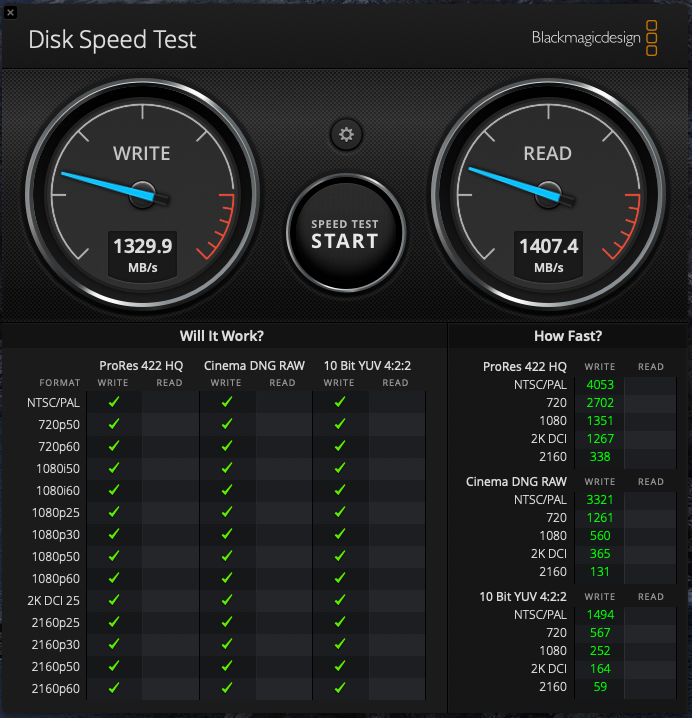

I also work in Photoshop with big files. As a work drive for my 6,1 I use OWC Express 4M2 with 2x Samsung M2 drives, in a RAID 0. Connected using Apple TB2 to TB3 adapter.
The OWC Express 4M2 can take up to 4 drives, but it's limited by TB2 throughput on 6,1, so I'm guessing it won't be much faster even with 4 drives in RAID 0. Haven't tested. But as it is it's still faster (and bigger) than the original internal SSD.

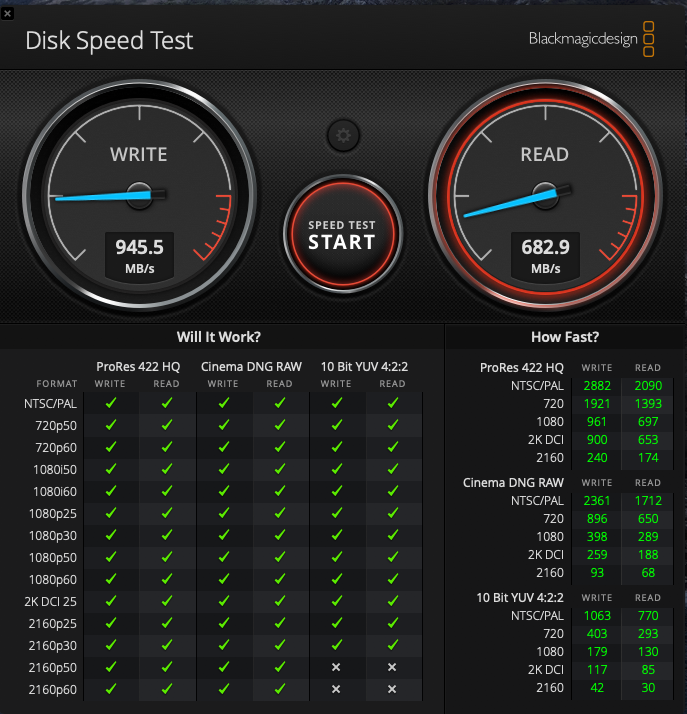

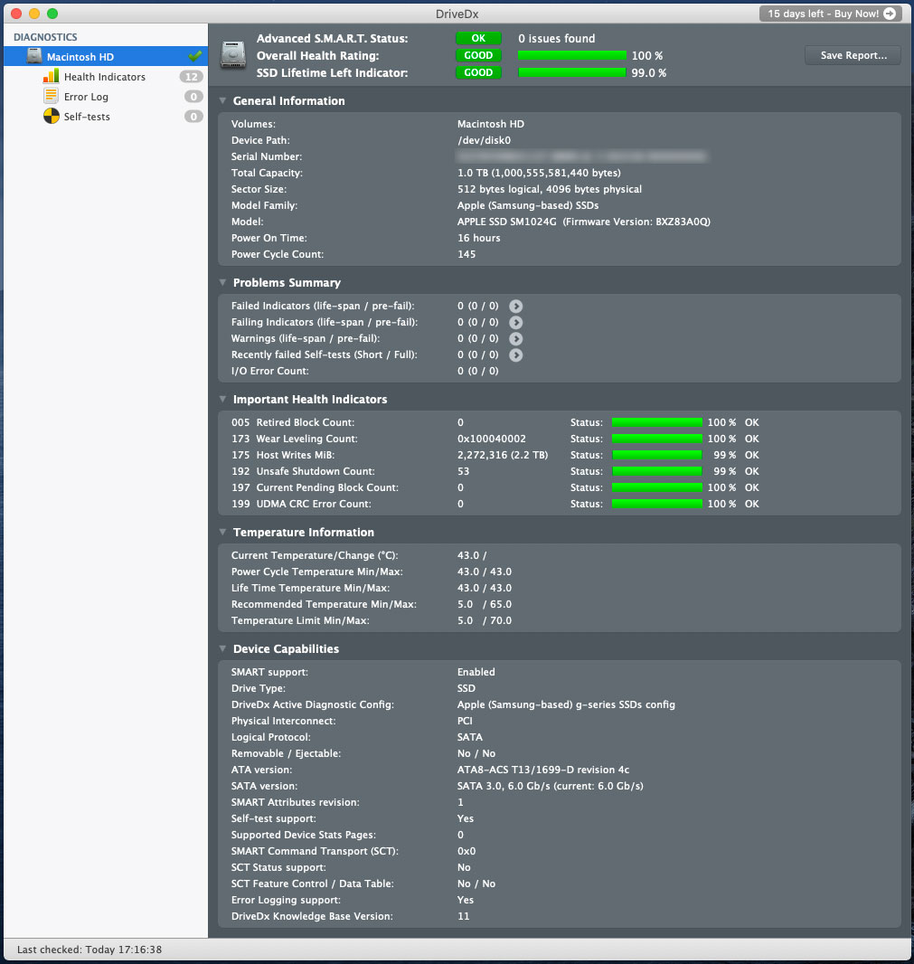

Today I received and installed the 1 TB SSUBX. Got it from eBay and to my surprise the drive is almost new, as described by the seller, produced on 2019/6 with only 16 hours of usage. FYI the old SSD had 22,000 hours on the clock. So here are the test results:

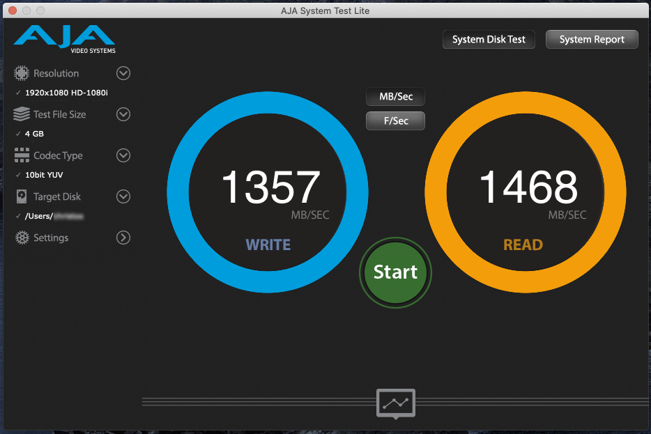

It's ~30%(read) and ~50%(write)* faster than my previous 500GB SSUAX. So happy with the purchase and with the results. The installation was super easy and now my MP boots in half the time it used to. It's like when I first bought it!
