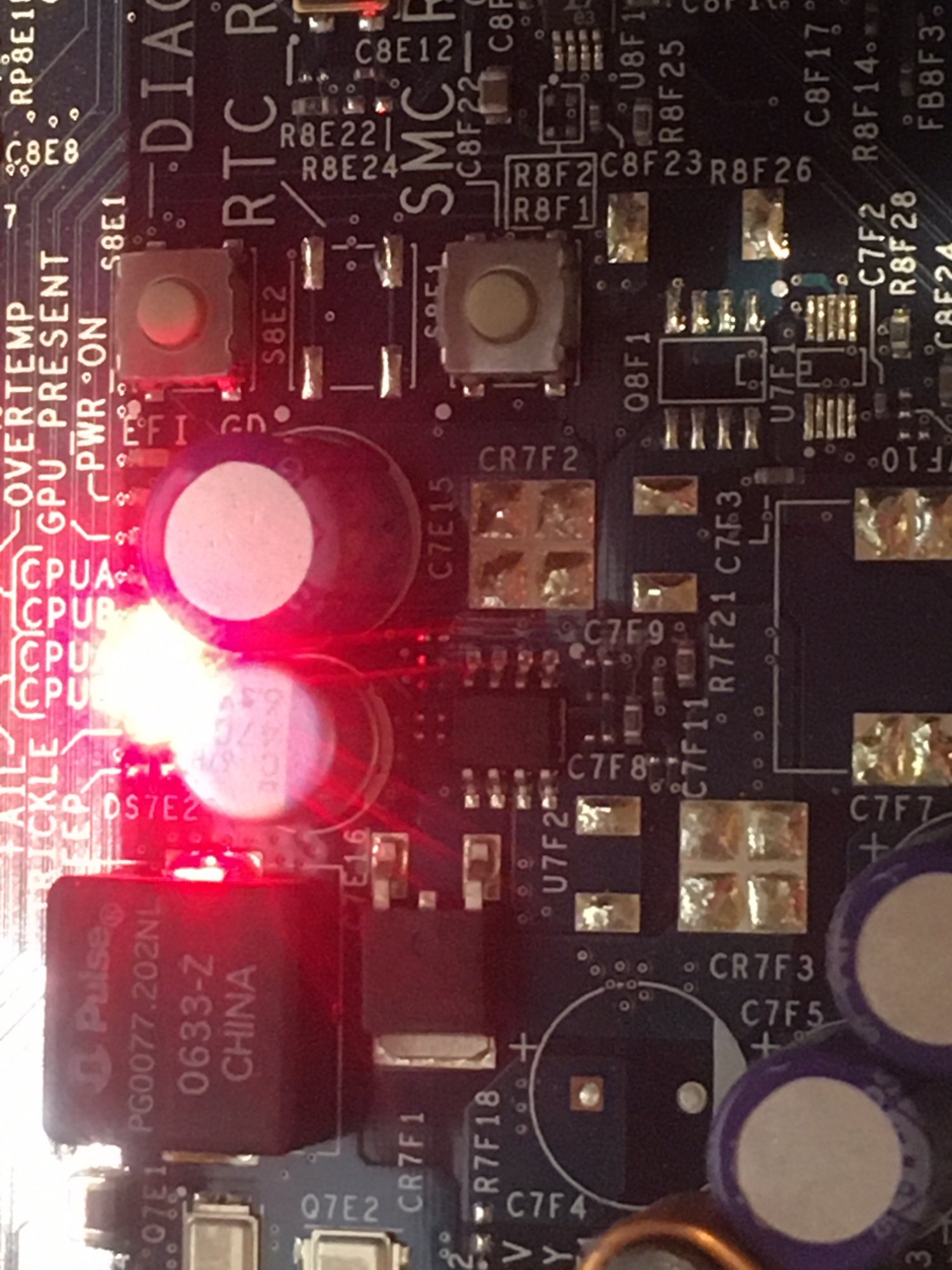

My beloved MP 1,1 decided not to boot today. MP will power up but not chime. There's power to the USB ports but the Keyboard CAPS light will not come on. After investigating, the cause looks like the CPU's, as the Diagnostic CPU fail LEDs are lit. When the Diagnostic button is pressed the trickle, power, CPU overheat LEDs etc. all light up yellow but the CPU fail LEDs' stay red.

I'm trying to find a way of figuring out if the logic board died or the X5365 XEON SLAED CPUs' have failed before spending any more time or money so any advice on how to figure which is the cause, would be most welcome.

EDIT: Replaced the X5365's with the original CPU's and the result is the same (CPU Fail LEDs' lit on startup) so looks like the logic board has failed ;-( If anyone has any other suggestions, i'd be grateful.
