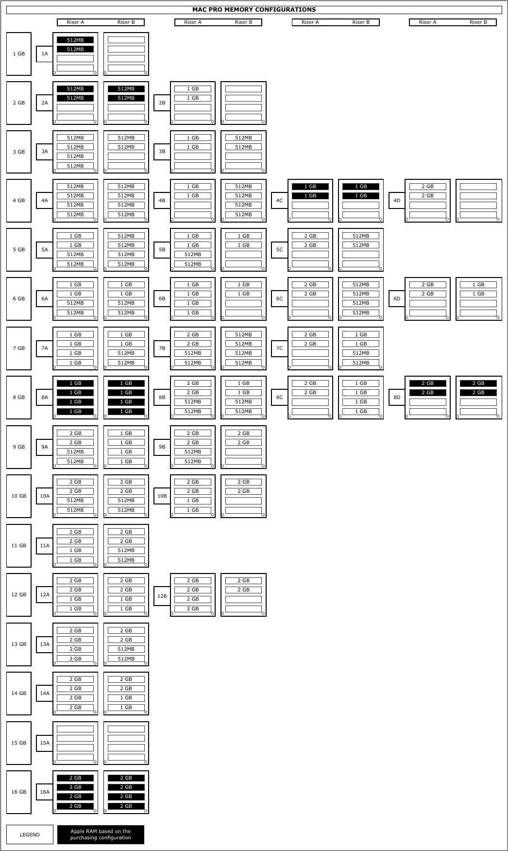

2x2 cost LESS than 1x4 plus it saves slots. You are foolish to even ask the question. There is virtually no performance hit for any mix when you follow this chart's guidelines.
It is UNWISE to by less than pairs of 2GB sticks ALWAYS.

Have you studied the chart on how to install all mixes of ram?
Thanks for the chart, I hadn't seen it. Do you know of any tests or references to support your "no performance hit" statement?
"Hit" Myth Has Been Posted Here Numerous Times
This topic has been posted to death. I've read it scores of times that any "hit" is nominal.
