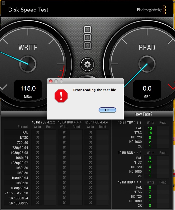

Disconnected everything except SSD Bootdrive:
No difference in performance.

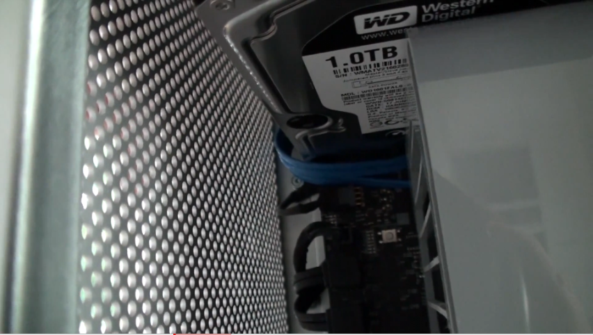

According to your video, some of the sata data/power cables are too large to connect to the mac pro's sata port inside the optical bays. What is the right sata cable/adapter measurements for the Mac Pro? Thanks

below the DVD Bay aside the HDD Bay1 there is a little tiny gap where you'll be able to put the two SATA cables through. I did one at a time and used a pincette for help. It can be quite a pain maybe for some with big hands 🙂
About the SATA cables. You need SATA data and power cables with no margins. They have to be very slim, otherwise you have to cut the plastic margins off, this is how I did it. It's not very elegant. But if you do it carefully, it works.

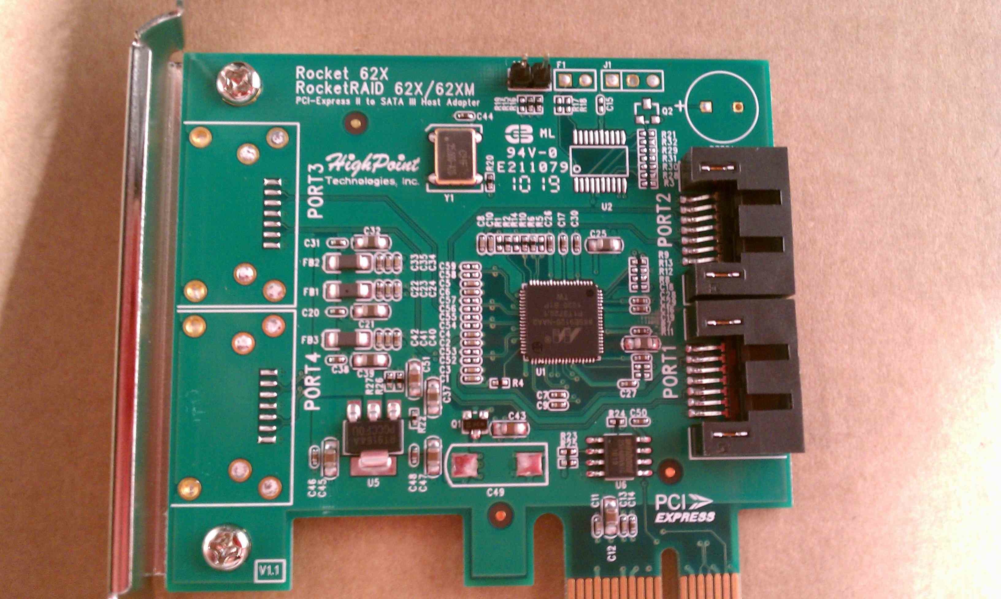

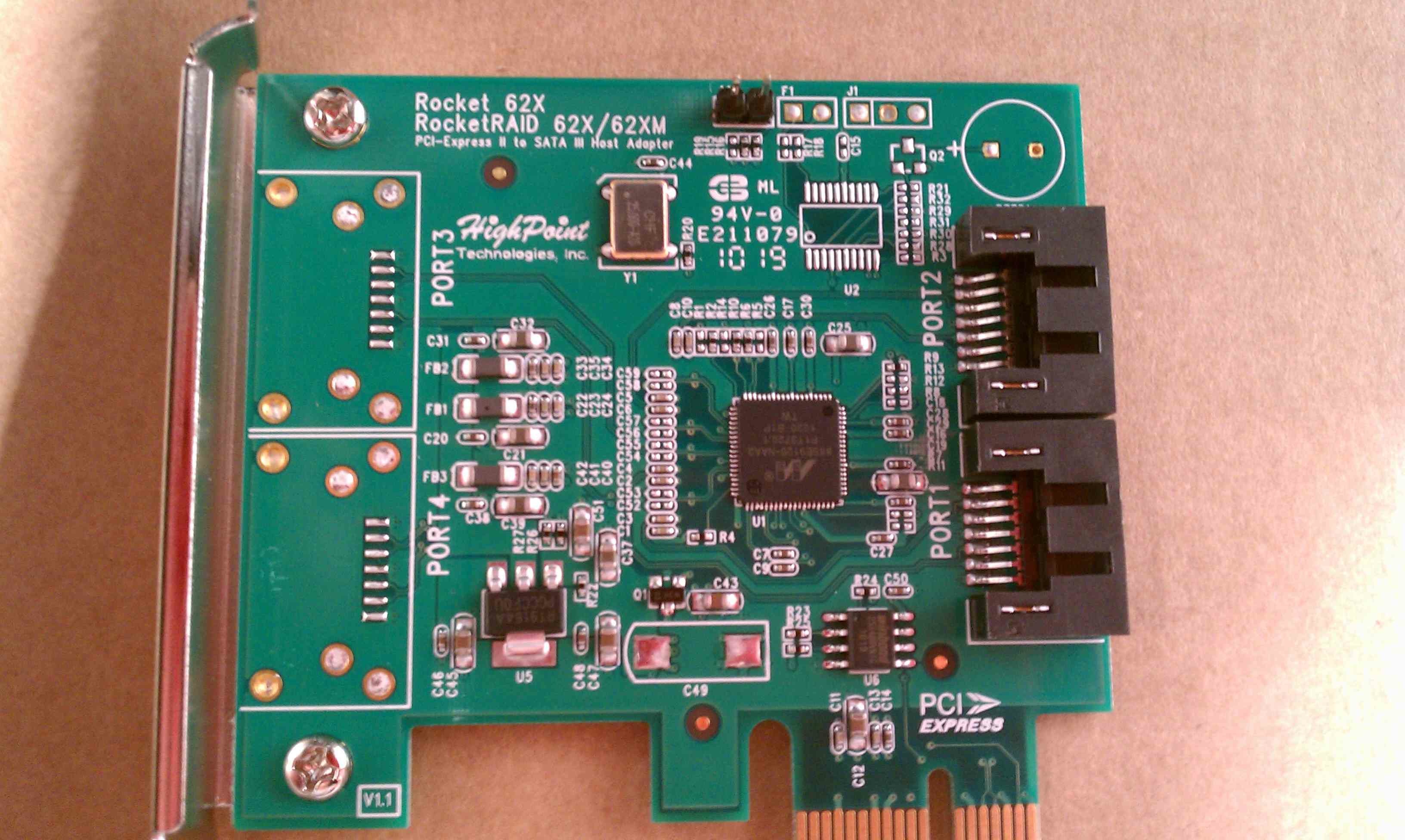

Highpoint RocketRaid 620-OEM + OWC 128GB SSD on MacPro 2007
Won't boot SSD from the Highpoint RocketRaid 620-OEM.
SSD as a "removable disk" off the RR620 IS POOR: abysmally slow and unstable.
Got RR 620 from newegg for $10 and an OWC 128GB SSD, and a good SATA 6GB/s cable.
SSD does boot if I plug it straight into the hard drive sled built-into the MacPro. Of course the SSD is incredibly fast but was hoping to reach full rates using the PCI card.

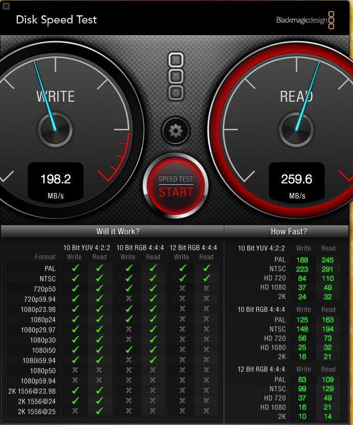

The OWC SSD 128GB speed:
200MB/s, 260 MB/s write vs read

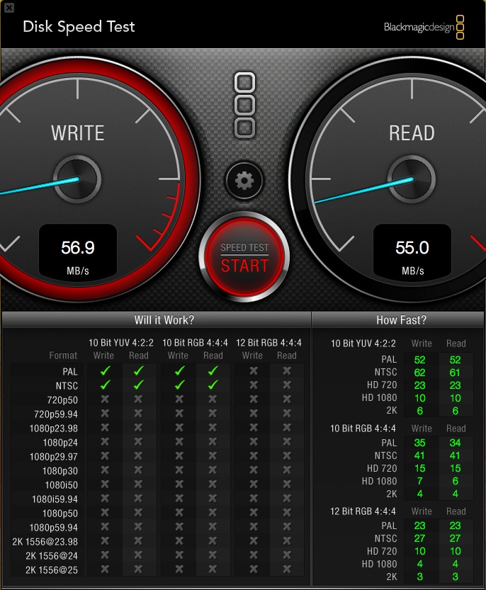

Hitachi 7200 RPM Deskstar
56MB/s, 55MB/s write vs read
SSD actually does work off the RocketRaid 620 insofar as the Mac boots another one of my hard drives, after failing to boot off the SSD, and the SSD shows up as a removable disk. However, the drive is incredibly unstable and slow. The speed test shows slow write times and it cannot do a read test (see second pic).
PCI card does show up as a SATA PCI card but is mostly unknown. Tried the driver "HPT-Quad-eSATA-mac-v100-100120.dmg" but that does absolutely nothing for bootability.
SSD off the motherboard SATA is great, I run two windows machines on Parallels 7.0 and it's way faster compared to off the hard drives now. It'd be nice to squeeze an extra 10 or 20% speed off the SSD using the 6GB/s SATA PCI card but I'm not sure it'll make a difference since my old MP uses 667 GHz DDR2 RAM so perhaps my bus speed may limit speed improvements anyhow..
Pic 1: RocketRaid 620-OEM from newegg
Pic 2: Speed of RocketRaid 620 connected to the SSD (OWC 128GB)
Pic 3: Speed of SSD (OWC 128GB) connected to MacPro SATA in hard drive bay.
Pic 4: Speed of Hitachi 7200 RPM hard drive
MacPro2007 8-core 3.0GHz, 13GB RAM, 2x NVIDIA 7300GT video, 3 hard drives 7200rpm, 1 SSD, 3x 23" LCD, OS X Snow Leopard.

I found a workaround!
I was on my last ditch effort, and was prepared to order another controller, but found a method that worked in my scenario. You need a desktop PC with a PCIe (or boot camp).
Put the RocketRaid 620 into the PC.
1) Download the software package for the RR622 controller.
http://www.highpoint-tech.com/BIOS_Driver/rr62x/BIOS/rr622-bios-v1.1-1...
2) Update the BIOS on the RocketRAID 620 controller to convert it to a RocketRAID 622 controller.
3) Boot to MS-DOS prompt and run the LOAD.exe utility use the option
Load /f "BIOS version"
4) The command will change the RR6220 into a RR622
5) Shutdown and reinsert into Mac Pro, it will now be detected as a RR622 which you can load the drivers for OS X and it will work.
6) There is a web GUI for the RR622 which uses a browser http://localhost:7402 or https://localhost:7402
with default user name: RAID and password: hpt
Let me know if this helps?
