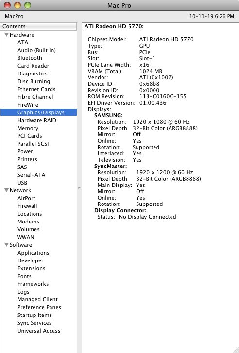

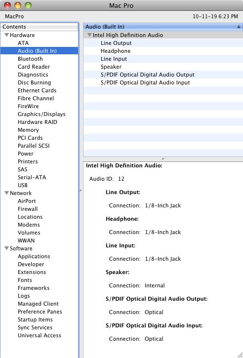

Update 4: I have a bootcamp installation of Windows 7. After rebooting and installing the latest ATI Catalyst drivers, the HDMI audio device is recognized and *works beautifully*, so my hardware configuration is confirmed to work, it is just OS X that is the problem. Maybe 10.6.6 or 10.7 will detect/enable the 5770 as an audio device in the future. :-(
Does anybody know of way to "force" a re-discovery of installed hardware other than what has been tried above?
I have the same problem, though I suspect the problem is with my adapter, not with the graphics card.
In system profiler, in built-in audio you should have HDMI out/ Displayport, right under Optical audio in, which you don't seem to have. Wish I could be of more help.

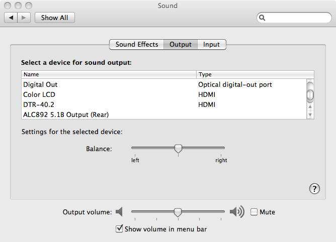

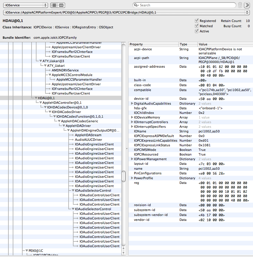

An easy way to check for HDMI audio capability on OS X is to run IORegistryExplorer (Optional Install/Developer/Applications/Utilities). Search for HDAU. If that device is present, the firmware is capable of HDMI audio. Plug in a MDP to HDMI (audio capable) adapter and a HDMI receiver or TV, check System Preferences/Sound/Output, select your receiver/TV and you could have HDMI audio. The IOReg/HDAU screen shot is a HD5870 with HDMI audio working and the Sys_Prefs/Sound/Output on the same system. The Color LCD is an iMac (target display mode) and the DTR-40.2 is a receiver connected to a TV.
