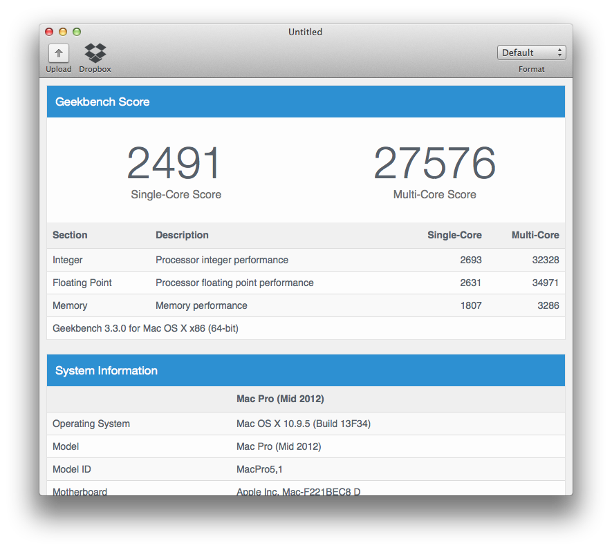

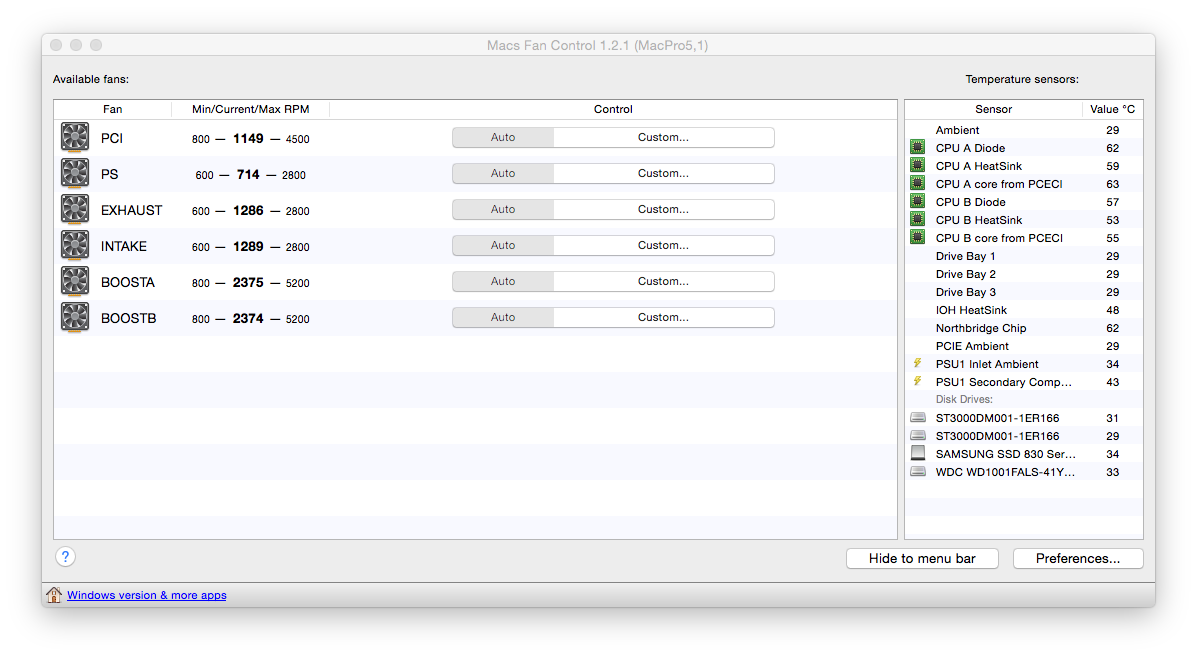

upgraded from puny 8core 2.4ghz to 3.33Ghz 12core X series CPUs and want to know if my score is decent? And I did a full on stress test. I used Arctic Silver 5 and put a pea size and spread it across the CPU and put the (clean surface) heatsinks back on. This is the way i used to build PC's so I just did the same thing. I also have a GTX780 in this machine and an SSD with Velox2 + USB3.0
Please see below. Also the second image has idle scores for CPU temp.
Any help appreciated. Cheers.

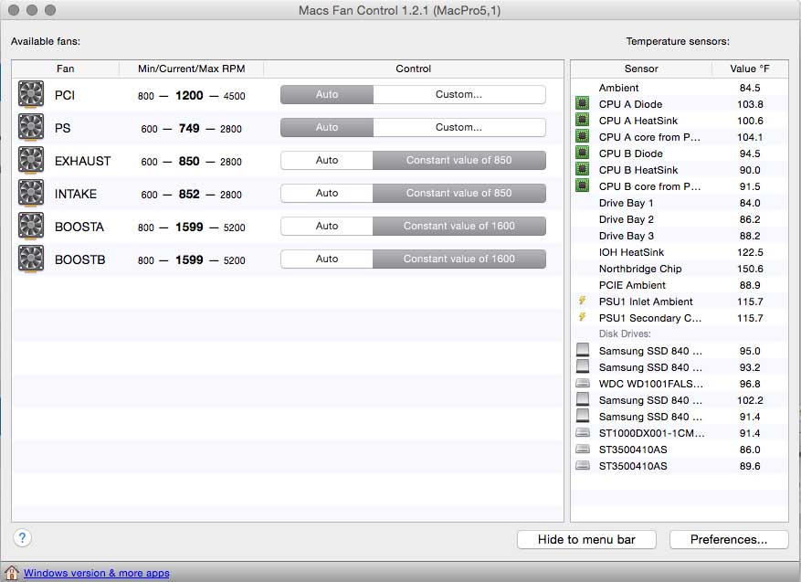

Your CPUs are running hotter than I am. Attached, for comparison are my temps in F.
Intel says the Max Temp. of the X5680 is 78.5C and you're below that.

The images on left are at 100% CPU usage. It seems that CPU "diode" is at 76-78°C
I was afraid of the PCECI temps which are jumping up to 93°C.
The image on the right are idle temps

It seems that if I up the speeds of the exhaust and intake fans, the temps drop down a lot. It seems from your screenshot you're using custom fan speeds? I figured I'd let the Mac take care of it.
