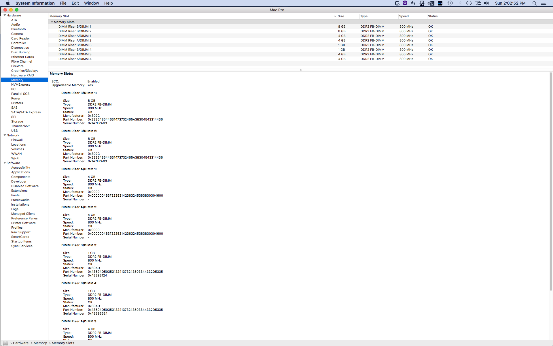

Goto Apple>About This Mac>System Report>Memory and see status.

Yes,
All ok now, waiting for fault to appear.

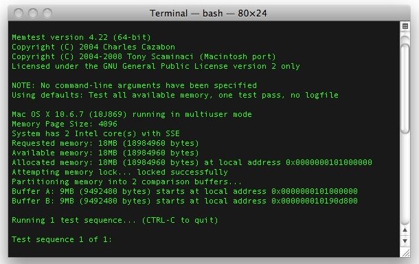

My ols ”memtest os x” seems to be pretty outdated...
whats outdated about memtest?
not used it for a bit but worked fine for me last time.
memtest is still fine,
can copy it in /usr/local/bin - even with SIP enabled
and run it in Single User mode to give it max ram to test
I thought there were some ristrictions with amount of ram being tested.
Butat least newest (2010) version of Rember did check all of my 20GB (4x4+4x1) of ram.
And running it in normal macos mode, I could check from System Information, which dimm is faulty.
Now I'm gonna ask Hynix if these dimms have "guarantee for life", Otherwise it might be hard to find matched pair? Or I'll just have to live with 18GB...
i think most the 'ram test' apps are just GUI's for mem test, if you want to get fancy you can make/get a linux boot disc with mem test on
mem test cant scan the ram used by the OS, the linux boot disc version is super striped down so almost no ram is used by the OS.
but for normal people it's not worth doing.
Which memtest are you using?
"memtest OS X"? What version?
Code:
Mac-Pro:bin Macschrauber$ memtest
Memtest version 4.23 (64-bit)
Copyright (C) 2004 Charles Cazabon
Copyright (C) 2004-2014 Tony Scaminaci (Macintosh port)
Licensed under the GNU General Public License version 2 only
NOTE: No command-line arguments have been specified
Using defaults: Test all available memory, one test pass, no logfile
Mac OS X 10.14.6 (Build 18G87) running in multiuser mode
Memory Page Size is 4096 bytes
System has 8 Intel core(s) with SSE
Total free memory is 5298 MB
Requested test memory is 5298 MB
Allocated test memory is 5298 MB at local address 0x0000000105ea3000
Attempting memory lock... locked successfully
Partitioning memory into 2 comparison buffers...
Buffer A: 2649 MB starts at local address 0x0000000105ea3000
Buffer B: 2649 MB starts at local address 0x00000001ab7ab800
Running 1 test sequence... (CTRL-C to quit)
Test sequence 1 of 1:
Running tests on full 5298 MB region...
  Stuck Address       : testing  1 of 16^C
