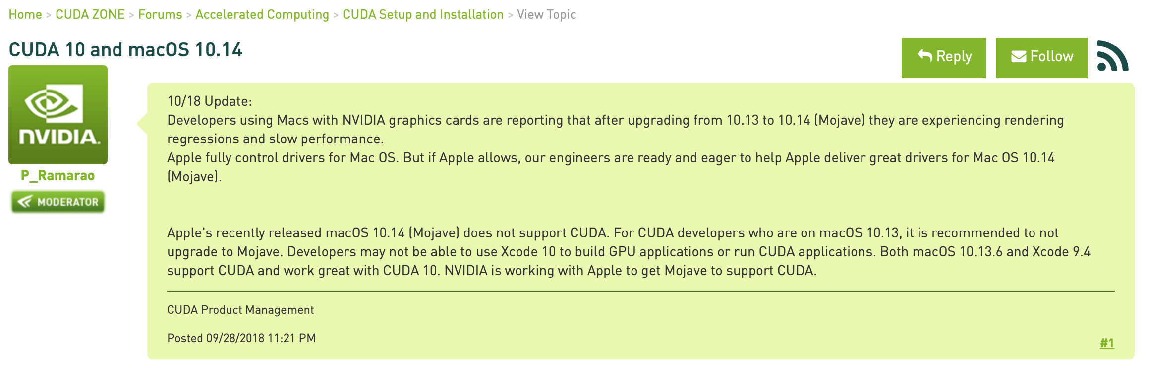

CUDA in Mojave?
https://devtalk.nvidia.com/default/...tup-and-installation/cuda-10-and-macos-10-14/
