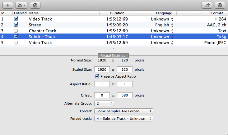

I set the forced option to "some samples are forced" and selected the correct file, but still not showing up in Quicktime automatically?

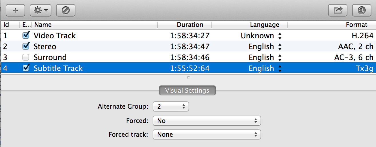

Update to the latest version of Subler (0.25).
Name all tracks to the corresponding languages, don't leave them as "unknown". Save and optimize. Play again.
Your current settings for forced subtitles should work under ver 0.25. If not, set forced track to "All Samples Are Forced" and try again.
Read the release notes of Subler for more info. https://code.google.com/p/subler/wiki/ReleaseNotes
orpheus1120 - thanks for your help. I checked and I am currently using Subler v. 0.25 and I changed the language to the subtitle track to English and saved and nothing, still no forced subtitles for the foreign language sections. Then I changed to "all samples are forced" and the movie plays with subtitles for all scenes. So at least I know the subtitles work, but I only want the forced ones to play. It's so frustrating.
