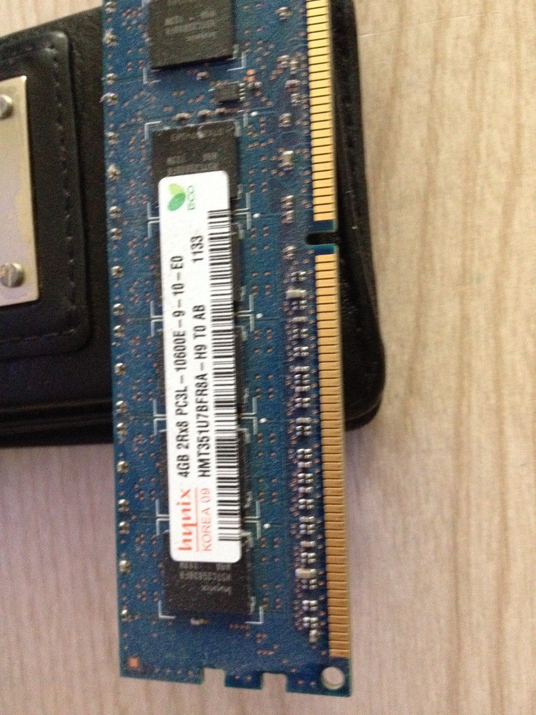

I have a MP mid 2010 quad core with only 8GB of ram. I had the ram in the slots closest to the cpu but the OS told me to move them so I did to the middle slots. Now on boot my fans are running full title. If I reset the pram its good to go until it goes to sleep or reboots. I didnt know if it could be the ram that caused this or what... any help would be great. I dont have any other problems with it other than the fans running at full speed if I dont rest the pram.
Oops I guess I didn't quite understand. I thought you where adding RAM. Have you made any hardware changes lately?
It's my understanding you should put the memory in starting in slot 1. Slot 1 is the one that's closest to you when you remove the cover. What type of RAM do you have? Speed? Does all of your RAM have the same manufacturer and/or timings? How long does it take until it happens?

RAM:
