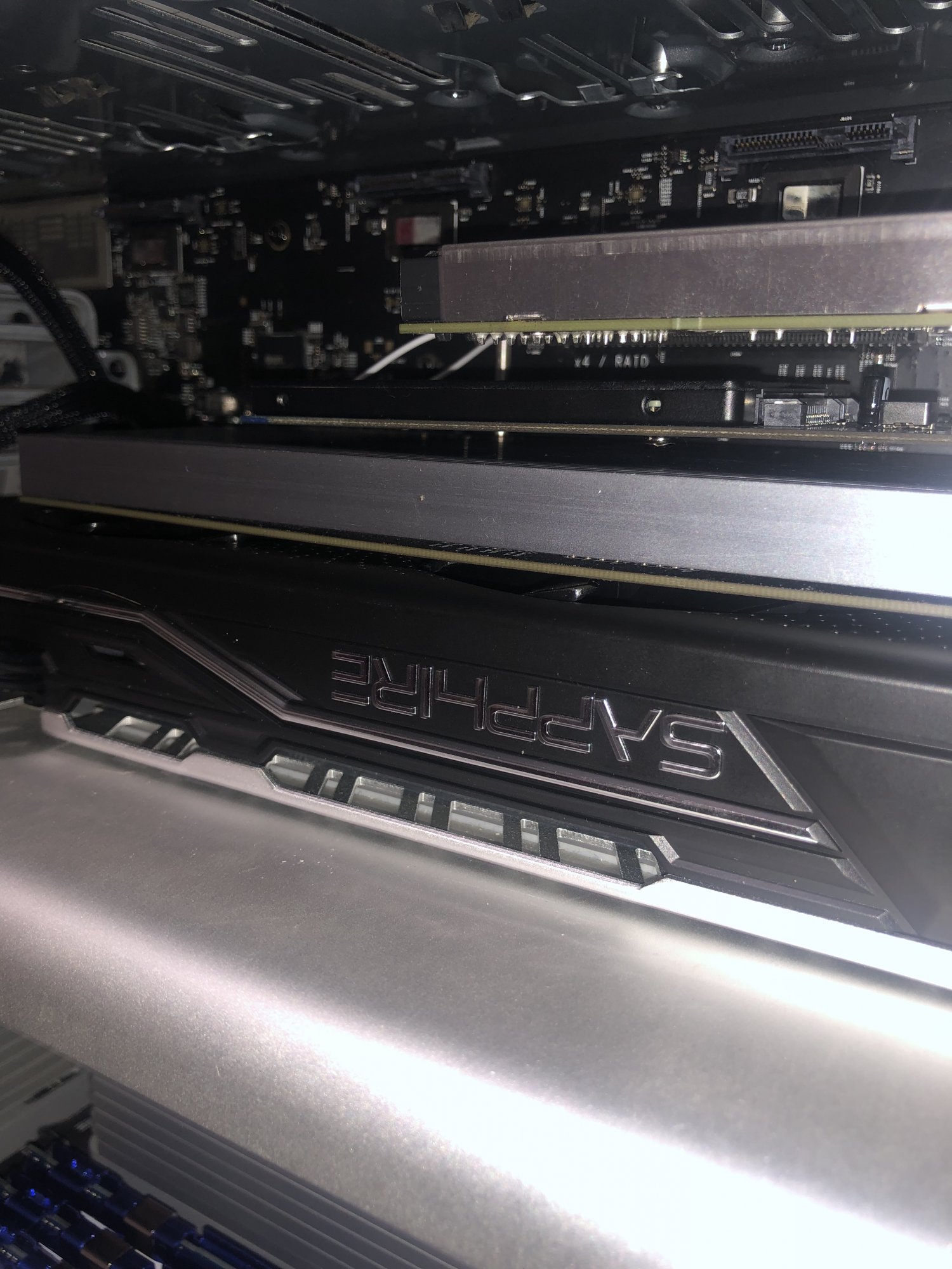

I didn't either, until I ran into this issue and then measured. The published specs say 40mm but measuring at approximately 44.5mm with protrusions.

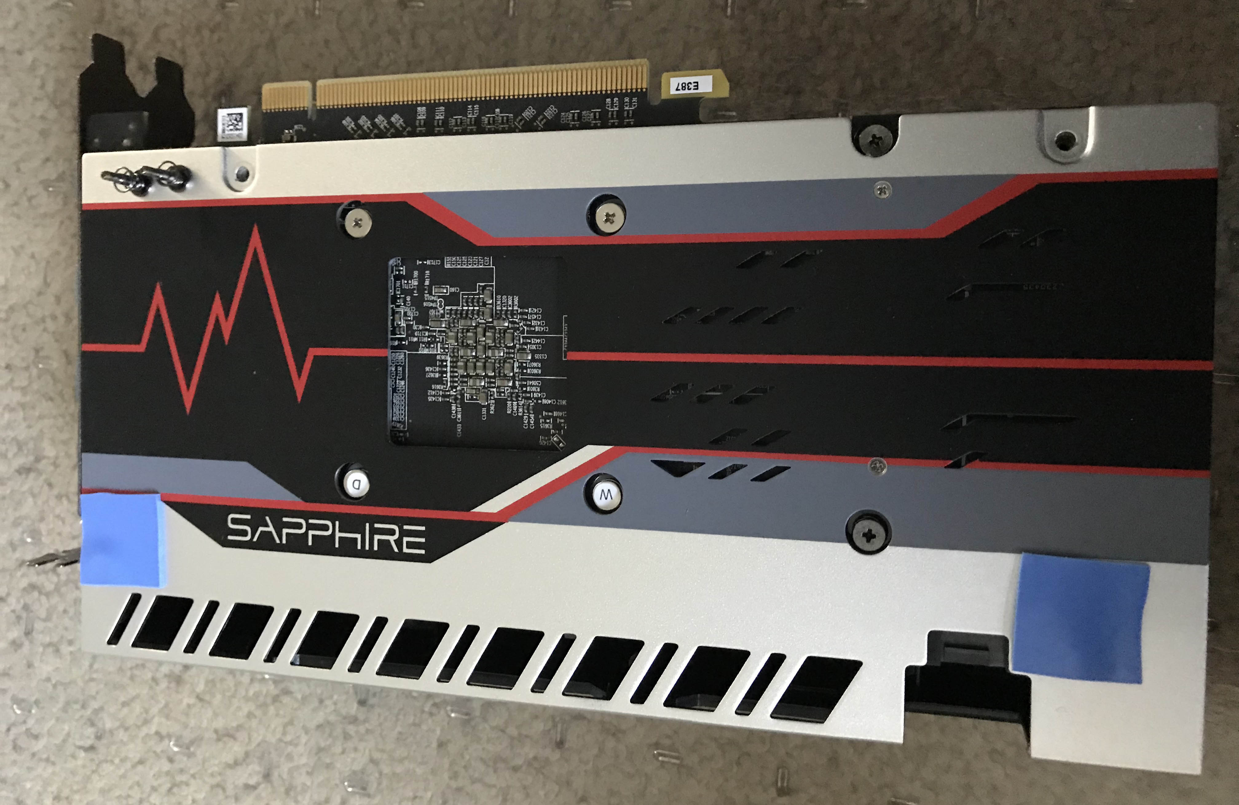

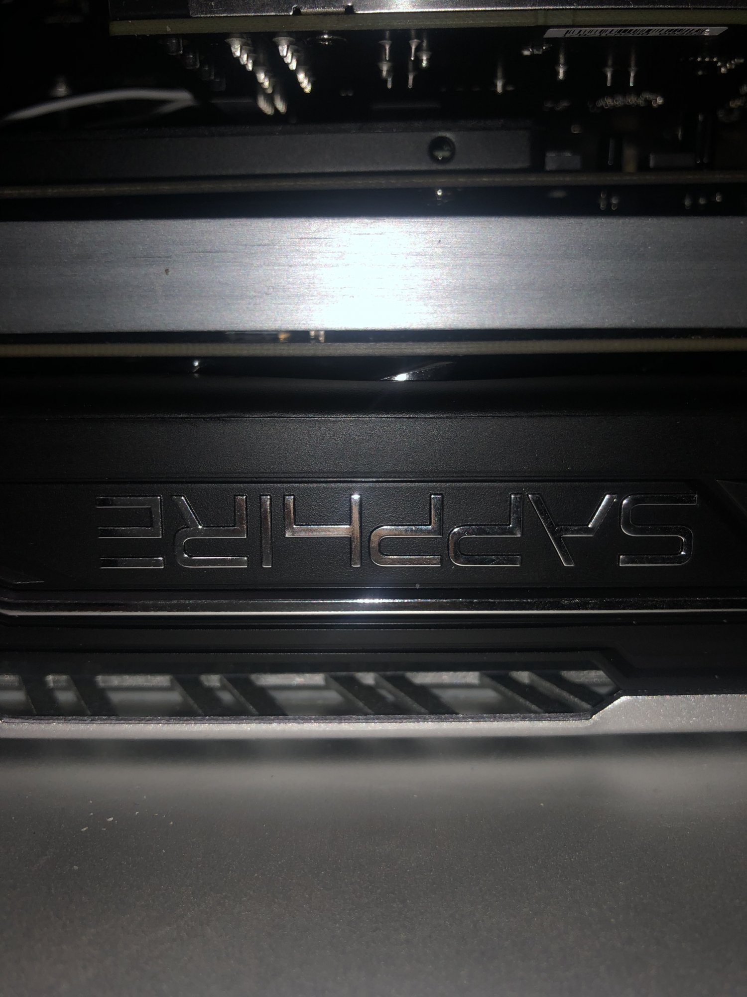

Had a chance to add the Sapphire PULSE RX580 8GB back to the system this AM, with a modified install in slot 1. Troubleshooting the install issues from a card in slot 2 drooping into the GPU and an audio interference issue from another thread:
https://forums.macrumors.com/threads/rx580-audio-interference.2134677/

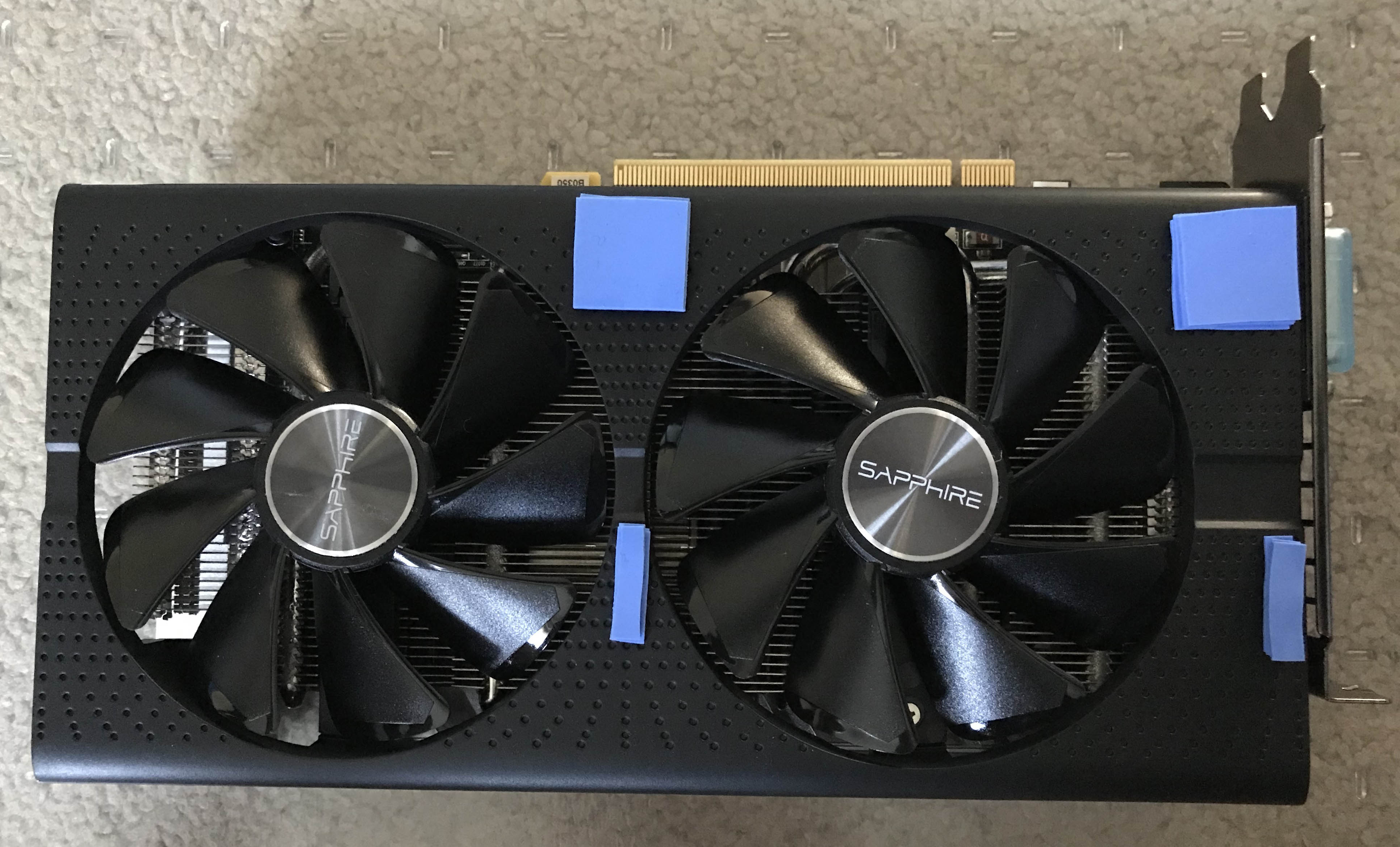

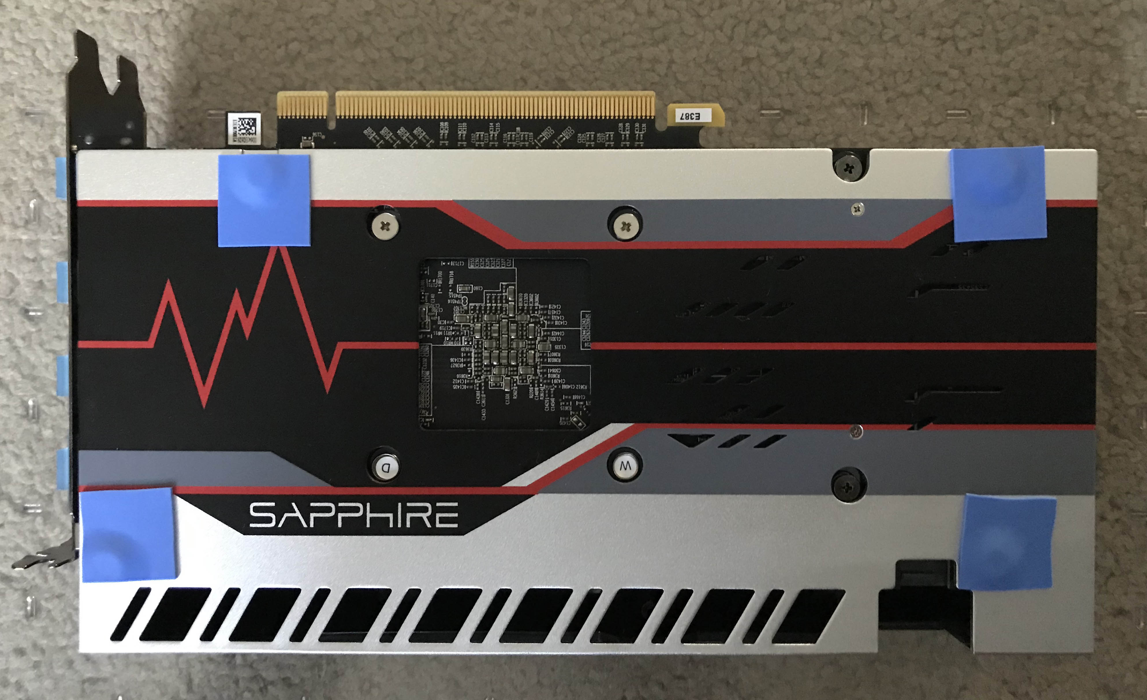

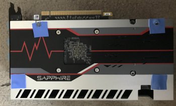

Put one thermal pad sheet (20x20x1mm) on top of each of the four bottom backplate screws, but was running into issues with the fit/install when used in combination with four stacked thermal pads on four different parts of the top of the GPU to prevent interference with the card in slot 2. Was creating a bridge to keep the end of the card in slot 2 out of the first GPU fan (closest to the ports).
Here's the original plan:

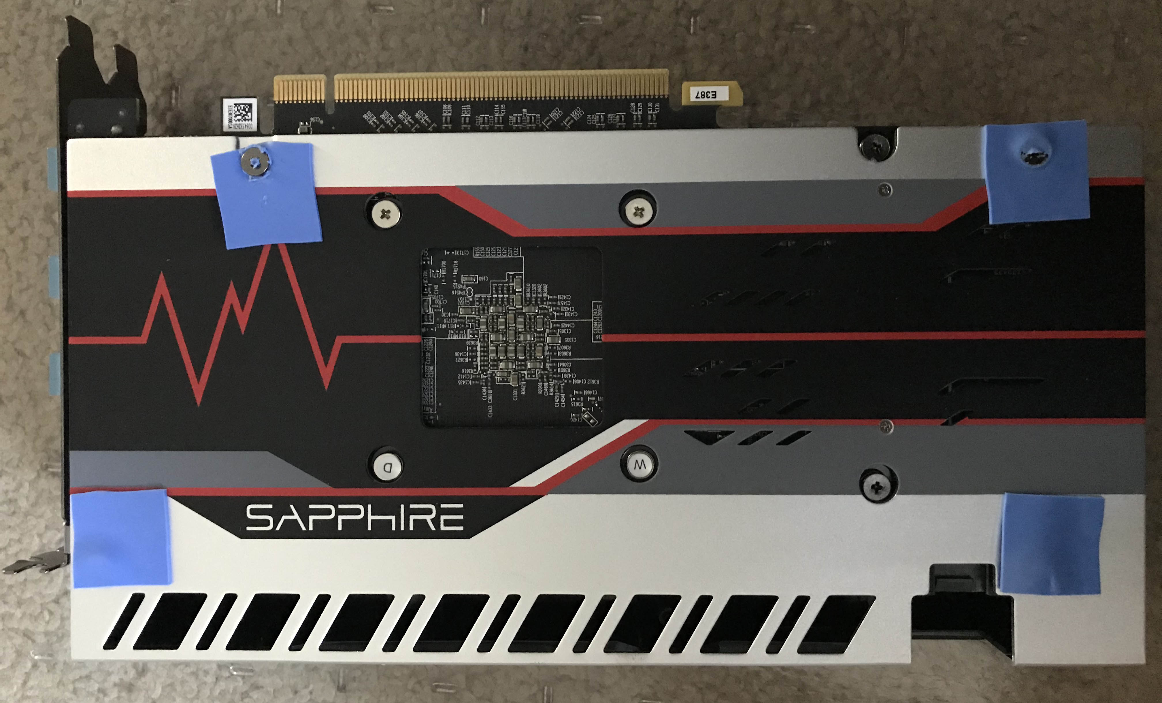

Was hearing some GPU fan interference. Immediately turned the machine off. Removed the GPU and the pads on the two screws closest to the PCIe connectors were already heavily torn apart. There's just not enough clearance on the PCIe connector side. Removed the ripped pads and removed two backplate screws on the GPU closest to the PCIe connectors. Left the thermal pads on top of the two other remaining backplate screws.
Forgot to take a photo of the changed top installation setup, but ended up ONLY using the top stacked thermal pads in-between the two GPU fans. Removed the two stacks on the side near the GPU ports. The card in slot 2 was not interfering in that area, only towards the middle/end of the first GPU fan (closest to the port side).
After reinstalling into the system, everything works fine. There are no GPU fan issues resulting from the card in slot 2.
The stacked thermal pads on the top of the GPU are four square 20x20x1mm stacked for approximately 4mm of height near the PCIe connector (the larger area of the GPU case). The spot near the middle of the two fans is one 20x20x1mm cut into 4 strips and stacked for approximately 4mm of height (one square cut in half, then each half cut in half again).
There is absolutely no audio interference.
Using the same exact power cables and setup that I was using previously, except for the GPU swap. (This same exact setup was working 100% fine with the NVIDIA GTX 1080 FE installed.)

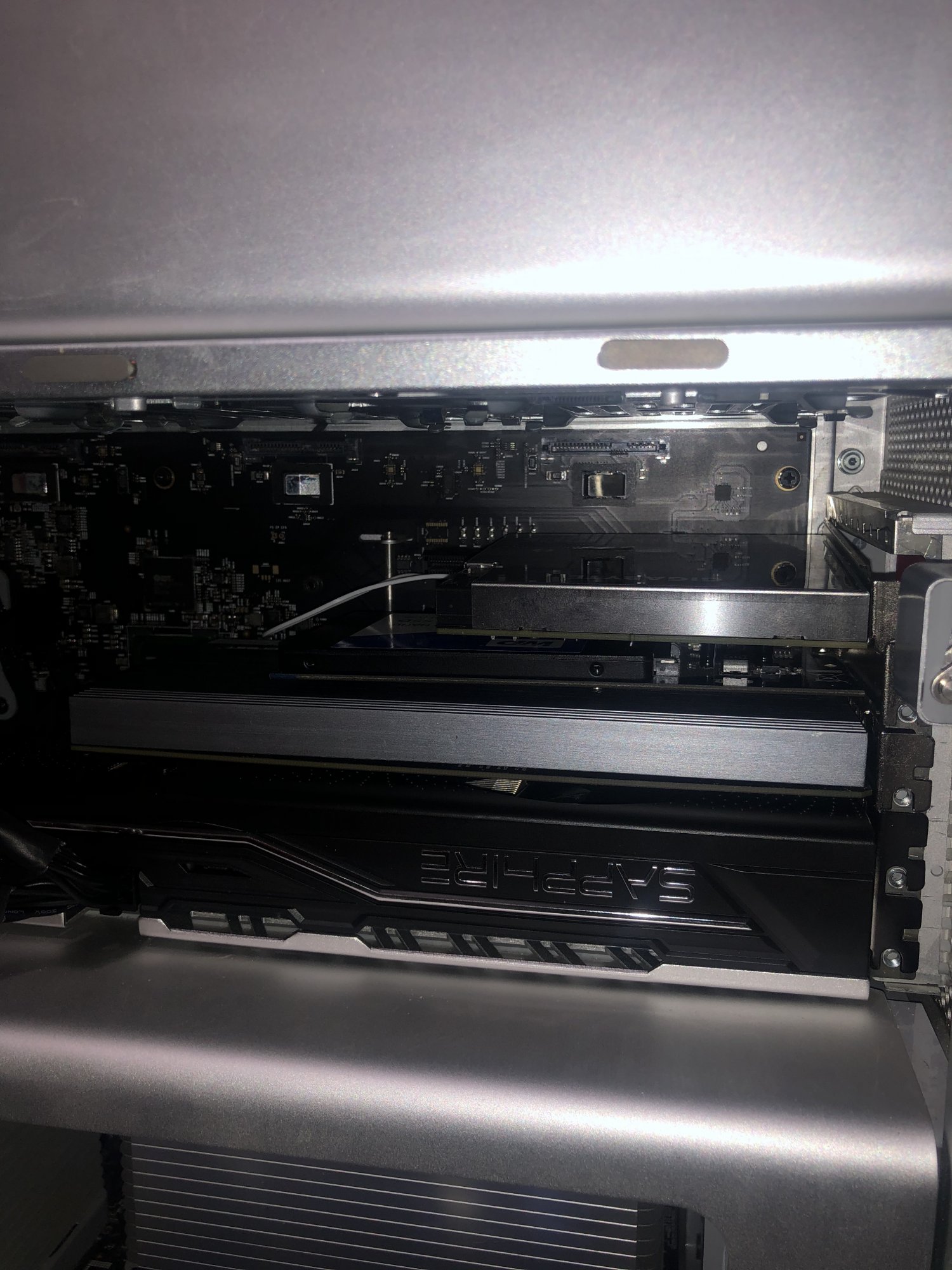

Have also changed the Apricorn Velocity Solo X2 > Angelbird Wings PX1 PCIe x4 M.2 Adapter with NVMe SSD. This card is a better fit with the RX580. Still need to use thermal pad stacks, but there is more clearance. It is also a shorter card (from logic board out) and allows more of the first fan on the RX580 to be open and vented. Fan #2 is fully clear and open when in use.

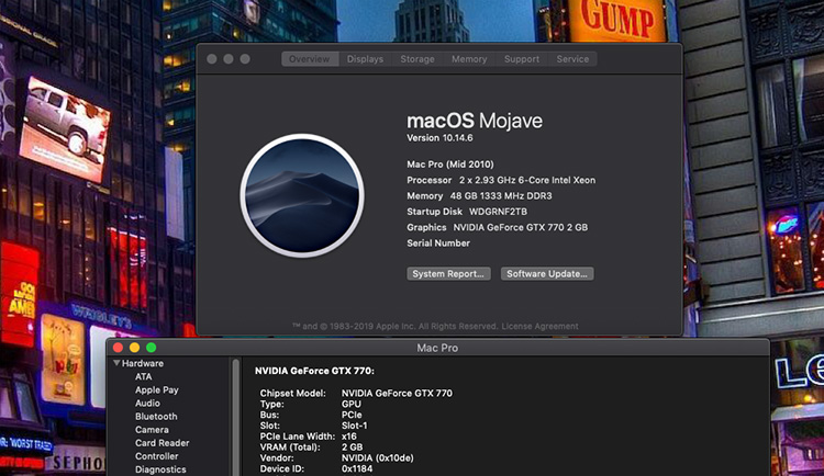

Though this is an old post, just sharing my experience with a Sapphire Pulse RX570 8gb. GPU design is the same as Sapphire RX580. My Sapphire RX570 is on Slot 1 and could not use the slot 2 PCIe lane with almost no airspace if another card is in slot 2. And the screws at the backplate caused some linear scratches on top of the CPU Processor Cage enclosure. Should have removed the protruding screw heads before installing this GPU
images

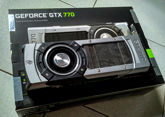

Removed the Sapphire RX570 and installed a Nvidia 770GTX 2gb card Reference design. The 770GTX works fine in Mojave. Also have a Nvidia 780GTX 3gb and was able to install Mojave on another HD using the Nvidia 780GTX.
The Sapphire 570 works fine but I’ll likely sell the Sapphire RX570. I prefer the blower type GPUs so I don’t have to worry on fans being too near on a PCIe card on top in slot 2. Thanks
