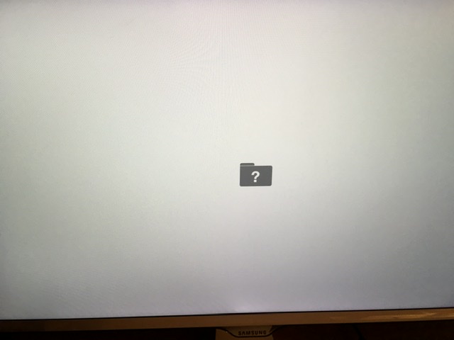

Update: removed the Sonnet Allegro, didn't change anything.
Removed alle the 3 hard drives. The mac stays on and I get this screen.
So, may I presume is not a CPU/GPU/RAM malfunctioning, and just and hard drive one?
next, I'll try to boot with one hard drive at a time.

Ok, I must have lost track of the hard drive numbers, because the hard drive in the Tray 1 turned out to be the Bootcamp drive and... it booted up alright. Alone.
I didn't know the Mac could boot the Windows partition if it doesn't find the other drives!
Booting up with the Time Machine drive bring the Recover OS. I may reasonably think, at this point, that my main hard drive must had failed.
