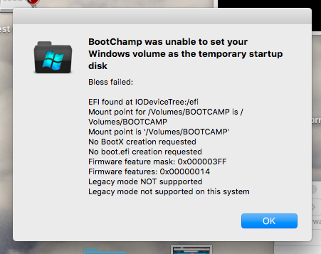

iv not been able to boot windows 10 for a while now, not shore why.
was shore i had it installed in legacy mode (but i may be wrong)
now when i try to boot windows 10 i get
was scared windows had done something bad to my BIOS chip.

It's Apple. They began restricting EFI-based Window installations on macs with BIOS / Legacy-EFI (non-UEFI) support since September by updating macOS's startup manager to not recognize/work with such installations. If you revert back to a BIOS Windows install, the startup manager will work again. I posted about it back then.
ah thanks, not got auto update on so i must have manually updated some time and broken everything
joy apple :apple: i feel pain in your embrace.

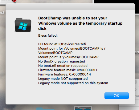

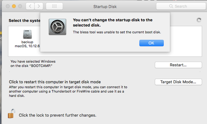

As I said, the restriction is in startup manager and not whether you are able to boot EFI/UEFI installations.
Check if you are able to set your windows installation as startup disk in startup manager so it would boot - it won't work. Only Bios (CSM) Windows installs can be set.
Edit: I have not used Apple's startup manager since the issue was reported by multiple users, including me. Not sure if it was updated recently, with the restriction removed.

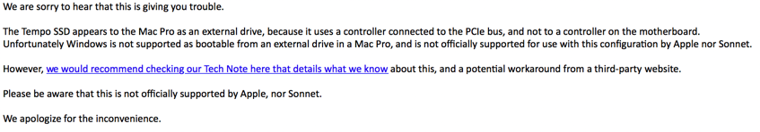

Sonnet's response:
Keep in mind that the Tempo SSD Pro was marketed as supporting bootcamp back when I bought it. I guess I won't be buying Sonnet's products anymore.
