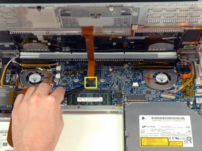

this one has 2 fans I replaced one a few years back since it began making a ton of noise which drove me crazy. Just cant remember what side I'm thinking it was the right side since the left you had to remove a cable for the magsafe or airport something on that side anyway.

anyway heres a photo with the 2 fans
jfTTAfCwyiyNGGnG.large
http://guide-images.ifixit.net/igi/jfTTAfCwyiyNGGnG.large
i replaced the right fan as I recall and the left is the original fan which seems to have died. The right is running at 6005rpm right now just doing basic internet browsing with no apps open other than entourage. 6k seems to be running at max speed from my research so the 2nd should kick in but is not. Just ordered 2replacements off ebay so will see once I get those. I figured better to replace both since the working fan is more than likely working double to make up for the broke fan.
