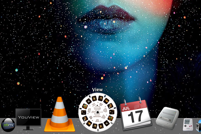

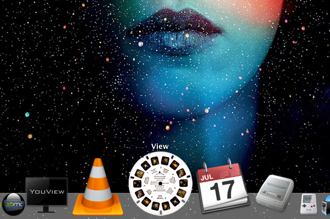

However, on my 1.25 Powerbook, 720p H264 are a no-no (less intensive codecs are fine), so after some web trawling I've found a solution using mplayer. I've used MPlayerOSX before and whilst effective, it's less capable than VLC - on my machines anyway. But I knew using the mplayer binary from Terminal was efficient albeit a little unwieldy in ease of use. So what I've done is wrapped some mplayer Terminal commands together into an Apple Script, compiled it as an app and designed an icon to make it look presentable 🙂
To use it you need the mplayer binary in your Applications folder and then simply drop a movie file onto the icon wherever you've placed it - you can use an alias or put it in the dock too.
The script opens the movie full screen and from there on all normal mplayer keyboard shortcuts control playback. Apart from being more efficient because there's no slick GUI to accommodate, there're commands in the script to cache the file and skip/drop frames which make unplayable 720p H264s now workable.

  • View.zip
    View.zip

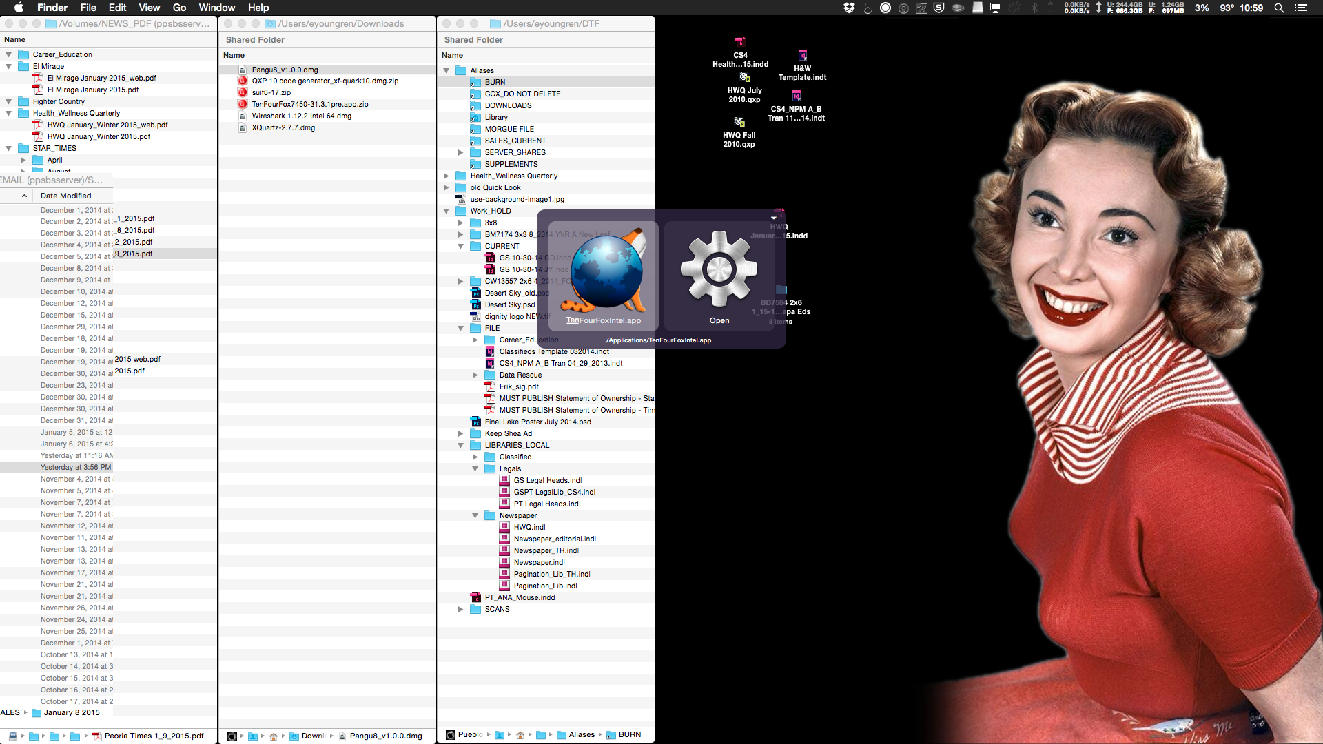

It is. Call it up via a shortcut, type in the first few letters of the app or item you want to open, hit Return and whatever it is opens.
I use CTRL+SPACEBAR for my shortcut. QS will open files, folders, apps, just about anything that is openable. You can even call it up, type in an app name and then drag/drop a file on to the app icon and QS will immediately open that file.
If you have multiple items that start with the same letters, a quick press on the down arrow will allow you to scroll through a list of those names and select the appropriate one you want to open.
Triggers are even more awesome. I have a trigger here at work that calls an Applescript app I made to move our ad proofs from one server share to another. All I have to do is select the file, hit the shortcut and the file copies. This is the same methodology I used to make a trigger for your script for MPlayer.
I used to abhore quick launchers (there's the dock right?) but once I realized I didn't even have to touch the mouse and that QS predicted my selections I was sold.
