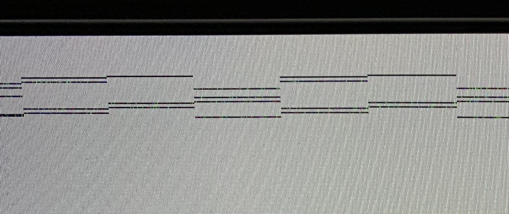

The whole issue started some time ago with VLC just bombing out whenever I tried watch any movie. At the time I didn't think much of it as I was running Mojave-betas with flashed/modded Geforce and other movie players would still work.
At one point these also started to crash from time to time or would mess up the GFX of other apps, still thought the Geforce was to blame and when things got worse I went and put the original Radeon back. To my surprise that booted despite not being supported by Mojave but issues stayed. An attempt to go back to an older OS failed for it loosing contact to mouse and kbd (the versions that charge over Lightening) mid install....

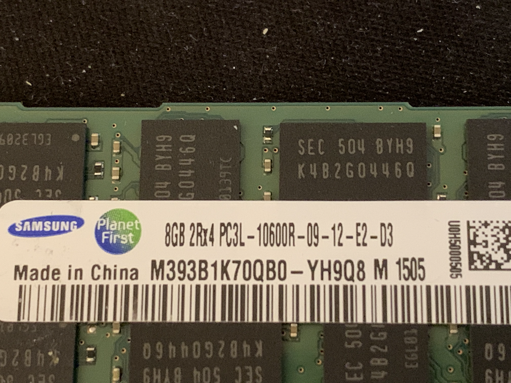

what make and models of memory are you using ? Its a good idea to use matching modules . Are you getting any red lights on the CPU Tray ? That would be a memory module failure . Remove any failed modules .

Your memory module model looks like it should be compatible , but I'm not 100 percent certain .
Known compatible 16GB modules for Mac Pro 4,1 > 5,1 and factory 5,1 are :
16GB = Samsung M393B2G70AH0-YH9 .
16GB = Samsung M393B2G70BH0-YH9 (low voltage) .
16GB = Micron MT36KSF2G72PZ-1G4 ( low voltage ) .
16GB = Samsung M393B2G70BH0-YK0 (1600 MHz) .
16GB = Nanya NT16GC72C4NB0NL-CG ( low voltage ) .

Anyways next think I tried was just booting into Mojave on the SSD with the Radeon installed (which had failed before), this is working atm, no GFX glitches, VLC still not working (this might be due to the not really Mojave supported GFX).

This still produces GFX probs with the Geforce but worked with the Radeon.
So it seems I had 2 issues, a defective GFX card and HS image being broken on Apple's side.....
