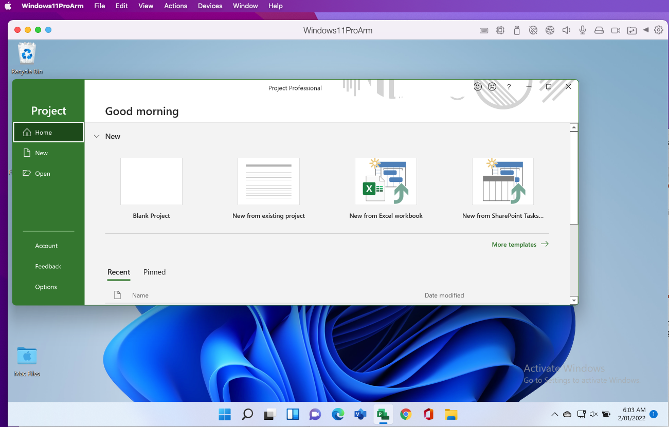

Yes - no issue
I am running Parallels v17 and Win11 VM and project professional 2019 version 2111 on MacBook Pro 13 M1
Yes - no issue

Full office 365 suite, Visio professional 2019, FreeCAD 0.20 (and project professional 2019 of course as mentioned).
If considering FreeCAD (more modelling than CAD) then the 0.2 install is stuffed up - nothing to do with the hosting VM - install 0.19 THEN install 0.20 over the top as 0.20 does not include some of the files that are required to run (that ARE included the the 0.19 install).
For pure 2D CAD however I use OSX M1 native QCAD pro - for my "2D only" purposes this is better to use as it is mostly an AutoCAD lite lookalike and will read/write DWG files.
ps if considering running VM consider 16GB RAM not the default 8GB.
